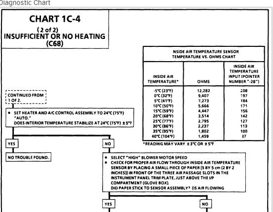

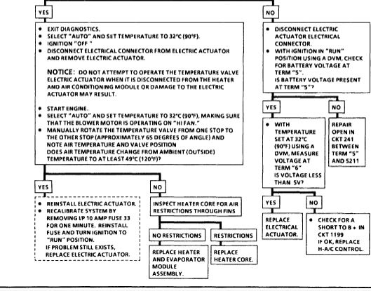

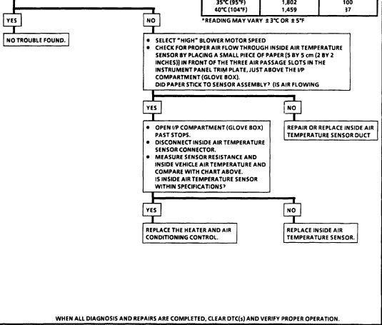

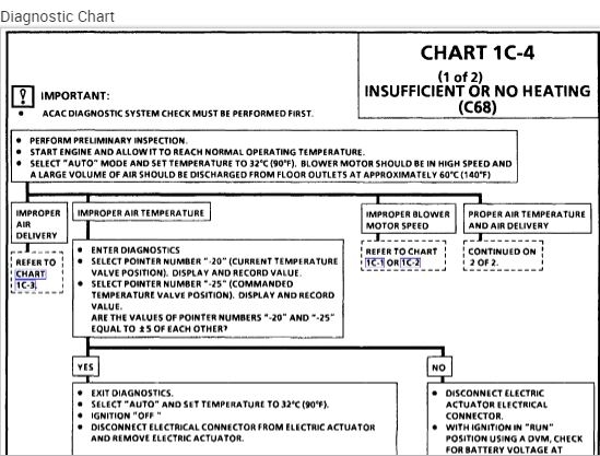

Let me know if this helps. Also, the added drain on the alternator from the blower motor may be the cause of the noise. Make sure the belt is tight and in good condition.
If you have a scanner, I have attached the diagnostic directions for the problem. They are somewhat involved. I had to cut each section in half so you can read them. I thought I would add them just in case you have the tools needed.

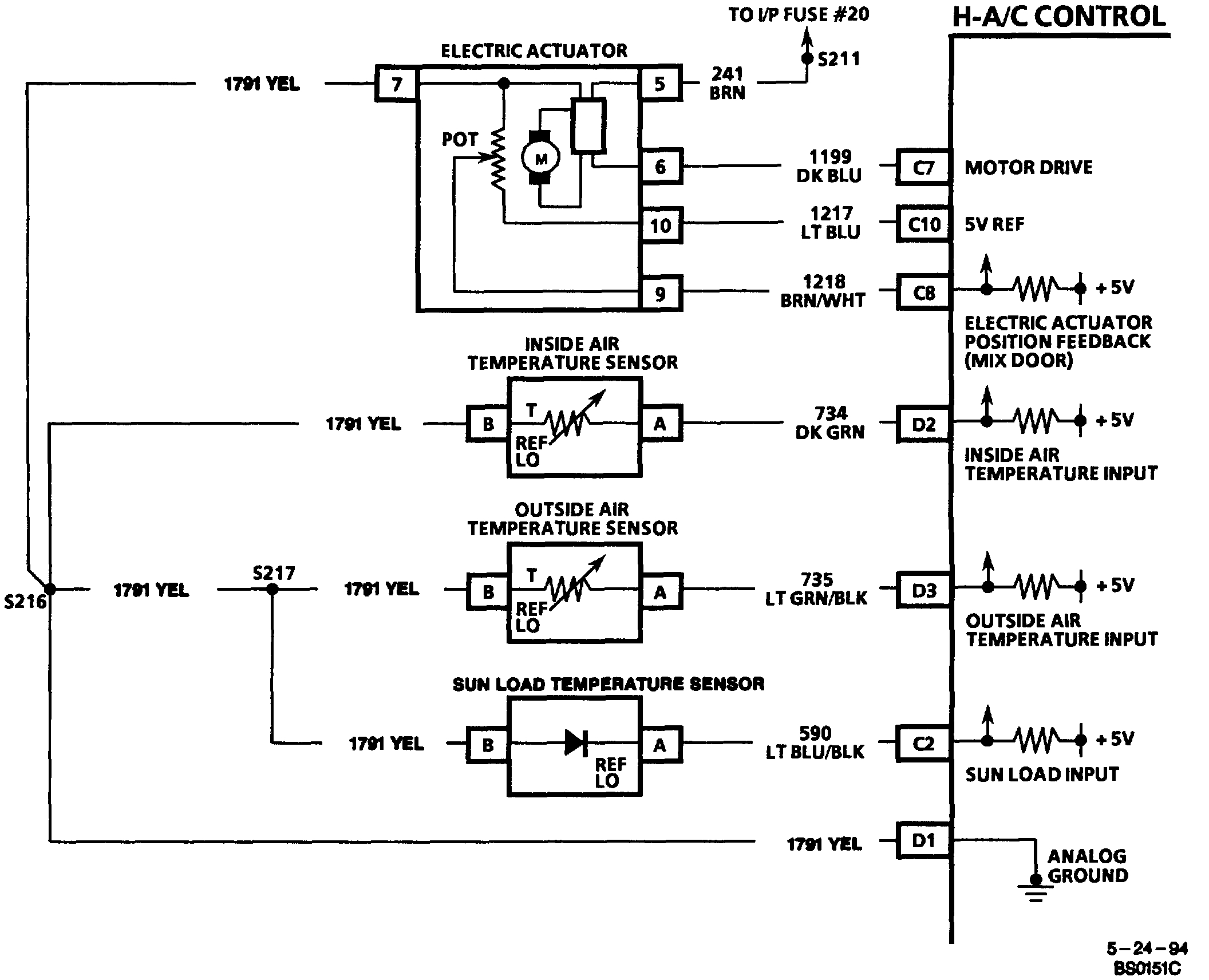

Make sure fuse 20 is good in the in car fuse box under the dash.
