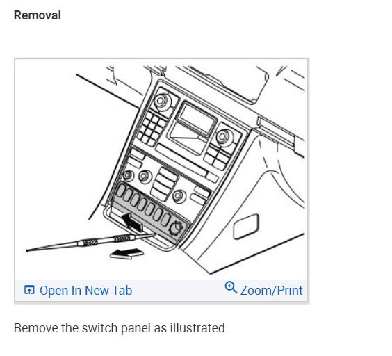

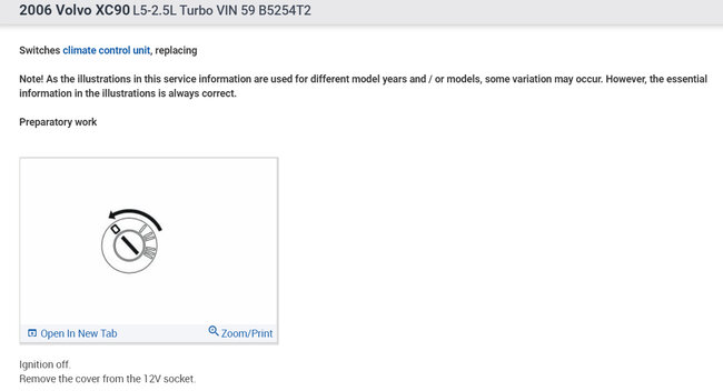

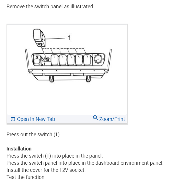

The fan knob is malfunctioning. Is it possible to repair this knob? I found a climate control panel from eBay. The dealer is asking $700.00 for installation and programming. Looks like I can replace the climate control panel, but I am not sure if it requires any kind of programming?
