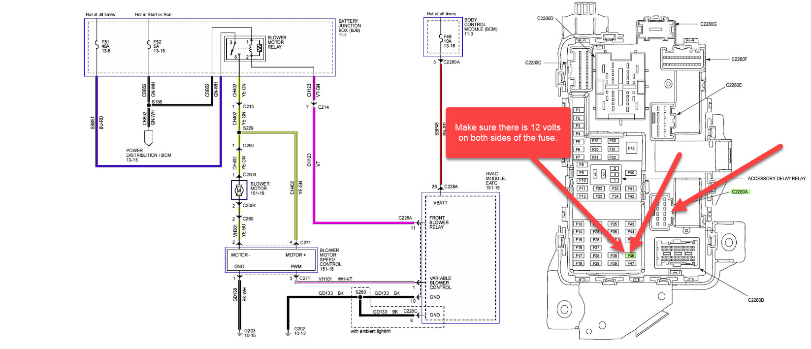

The first step should be to do a scan on the HVAC module and the body control module. A CAN scan which is the future of automotive repair you can get a CAN scanner from Amazon for about $50.00 here is a video to show you how.
https://youtu.be/u-4syLc-ifQ
This will more than likely point you in the right direction versus throwing parts at your truck. I have included a diagram that will give you an idea of what is involved with the circuit. It could be something as simple as low voltage after starter engagement.
Check out the diagrams (Below). Please let us know what you find.
