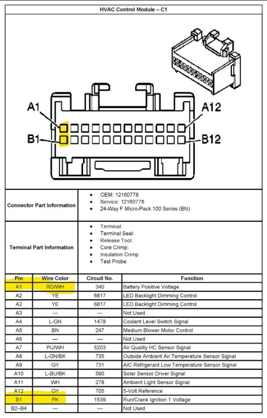

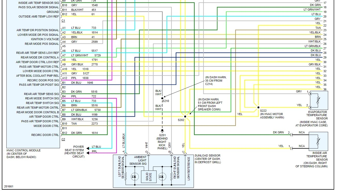

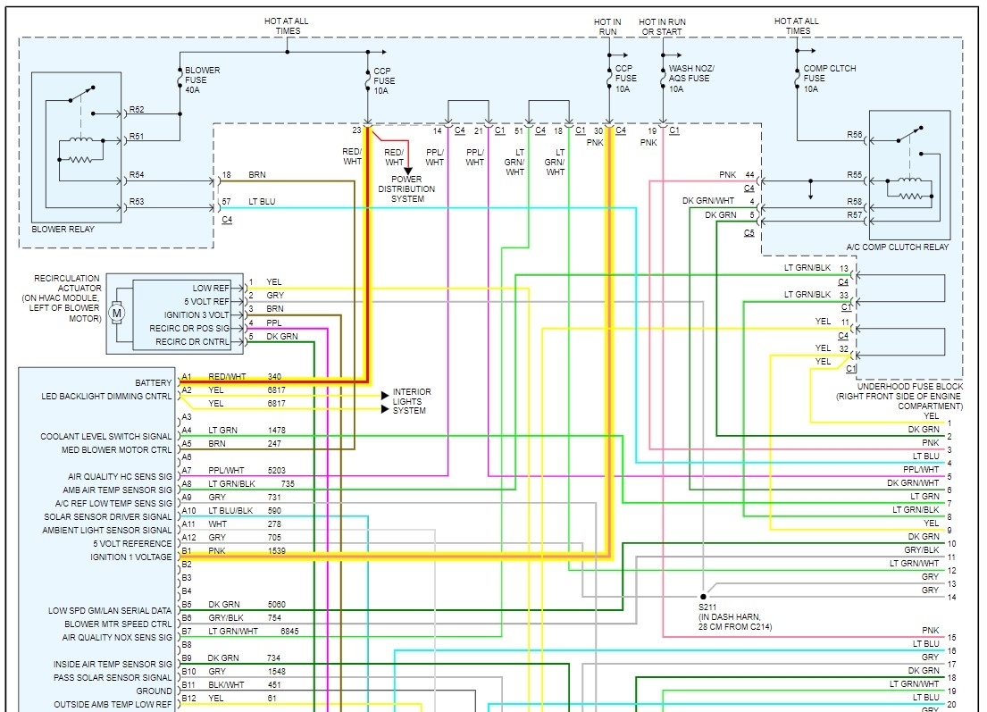

If the climate control panel (CCP) fuse has power, you could also check to see if there is power at the HVAC control module connector. Please check out this repair guide that discusses how to check the wiring in a vehicle, and the diagrams (below). The diagram is in two parts to help make it easier to read.
Please let us know what you find, and we would be happy to assist you further.
