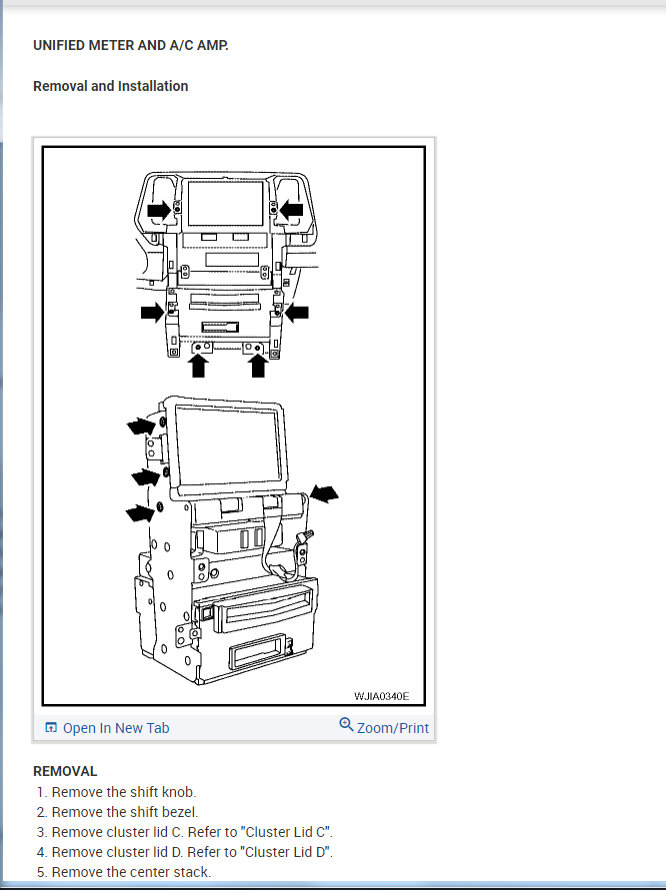

My climate control module got fried from a penny falling it in. I was curious as to what parts cross match with so I can replace it?
Dec 17, 2020 at 5:48 PM
CERTIFIED EXPERT
18,907 POSTS

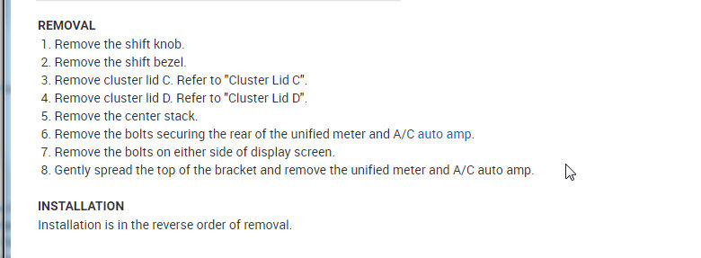

You are going to have to stick to a Maxima but it appears 2004 - 2006 model years are the same.
I attached below the process to replace the module. Let us know if you need more info. Thanks
