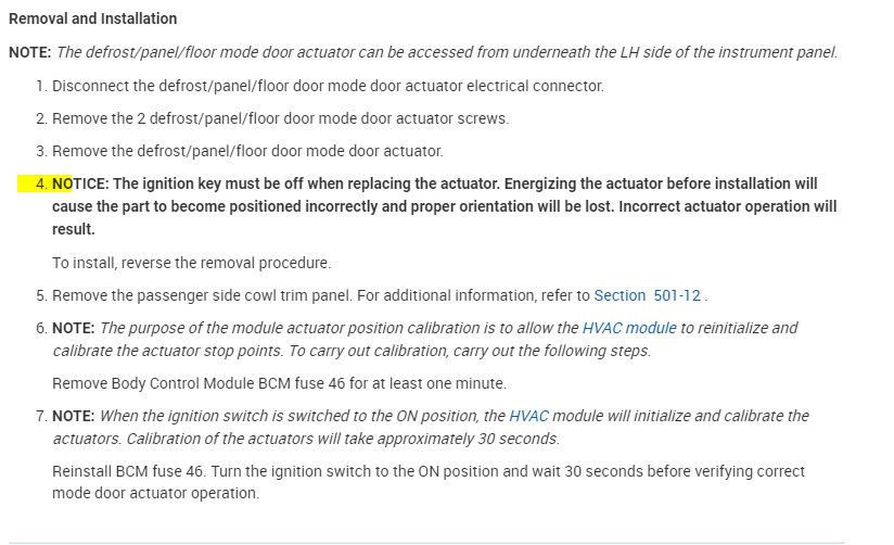

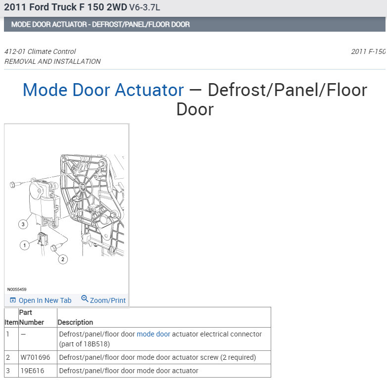

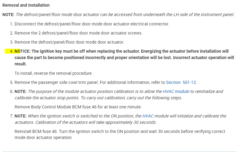

The issue does sound like a faulty mode door actuator as you have suspected.
One thing to keep in mind when installing a new actuator is that the key must be in the off position before removal and installation of the new actuator. Otherwise, the actuator will not initialize properly and not function or could have incorrect setting.
Let me know if this is something you followed when installing the replacement.
I have attached the procedure below.
Thank you.
https://www.2carpros.com/articles/air-vents-stay-in-the-defrost-position
