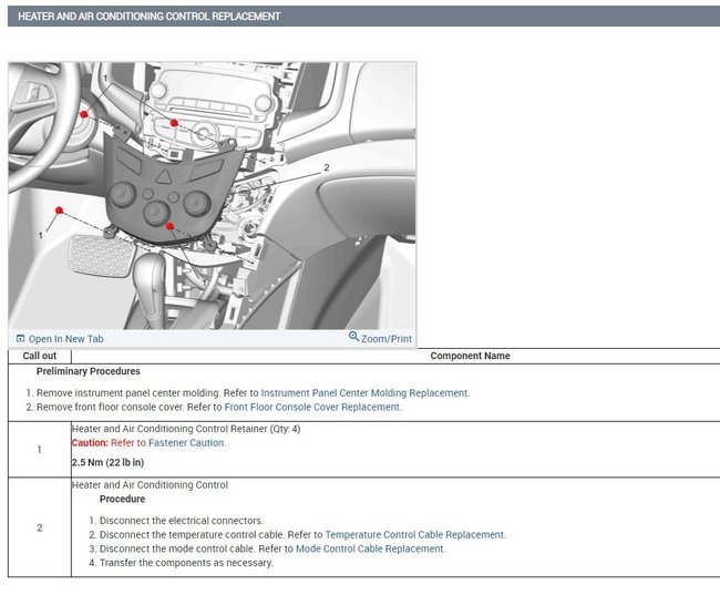

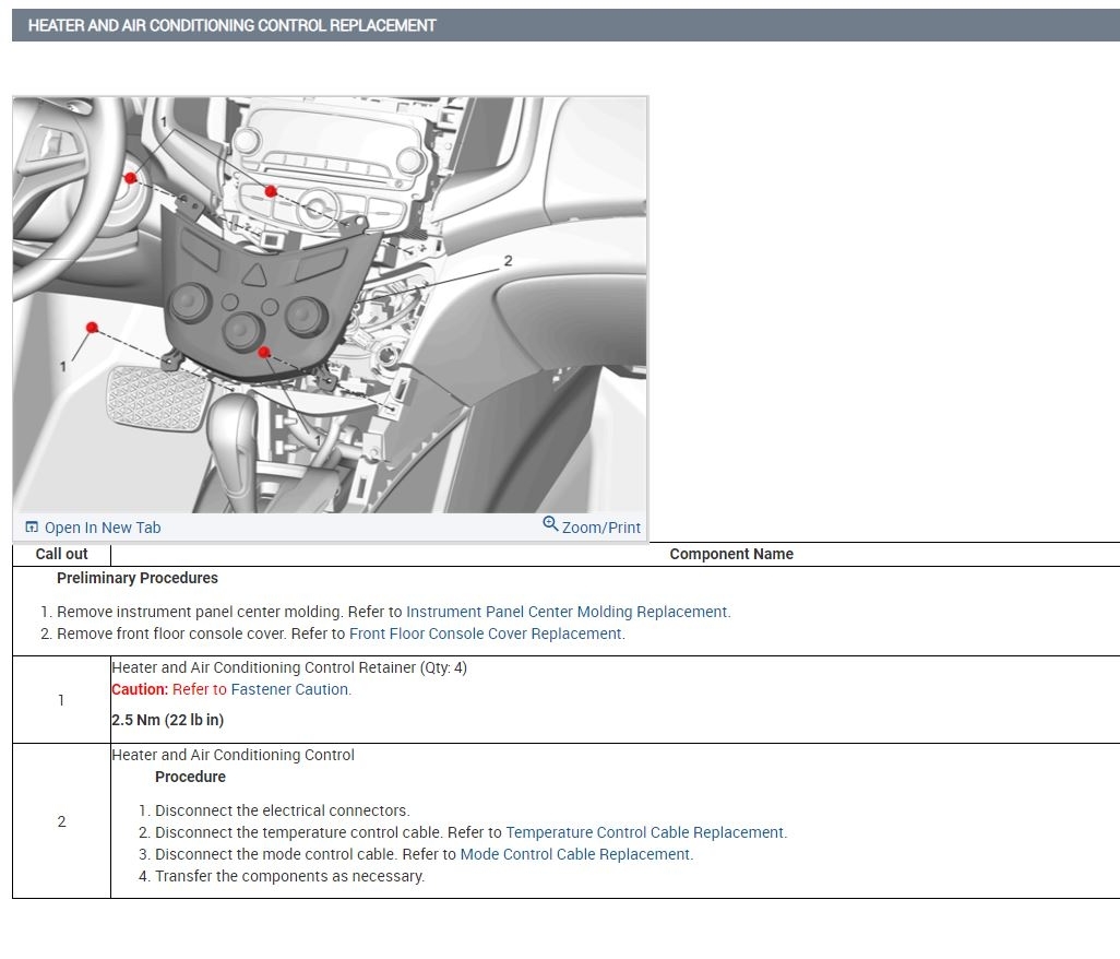

Hi, I'm Dan. First off, is this a manual HVAC control system? Meaning you don't have any digital read out, correct? If it's a manual system, then the doors for where the air blows to is controlled by a cable connected to the knob you turn.
Here is a guide that will help with this issues as well.
https://www.2carpros.com/articles/air-vents-stay-in-the-defrost-position
See the attached file. I would start by removing that panel in the picture to see if you can see anything broken in there.
