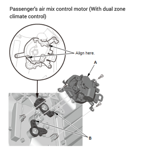

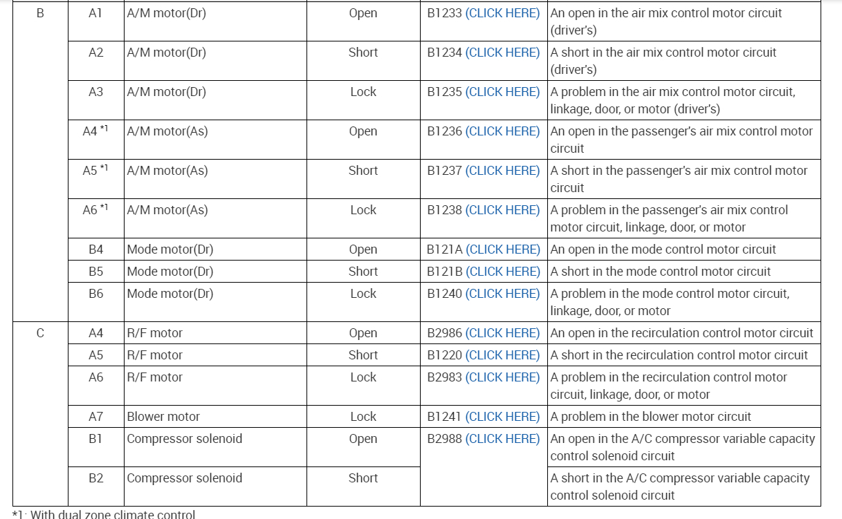

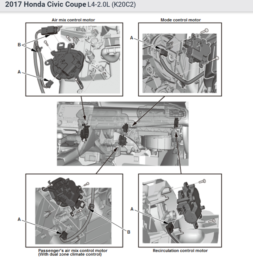

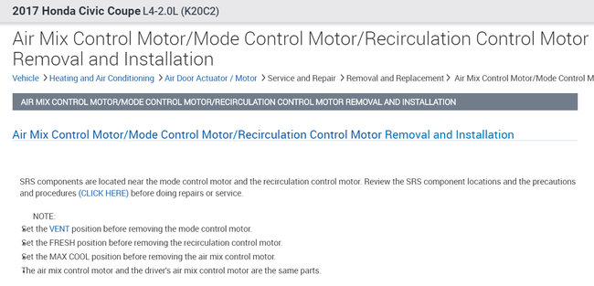

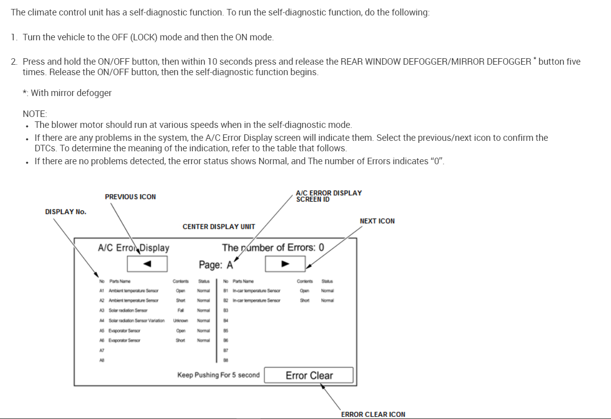

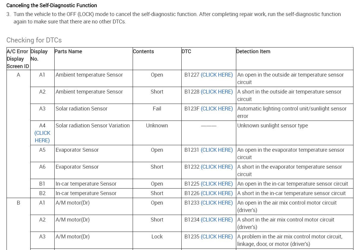

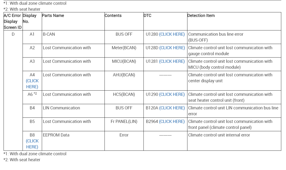

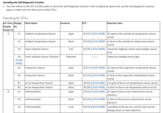

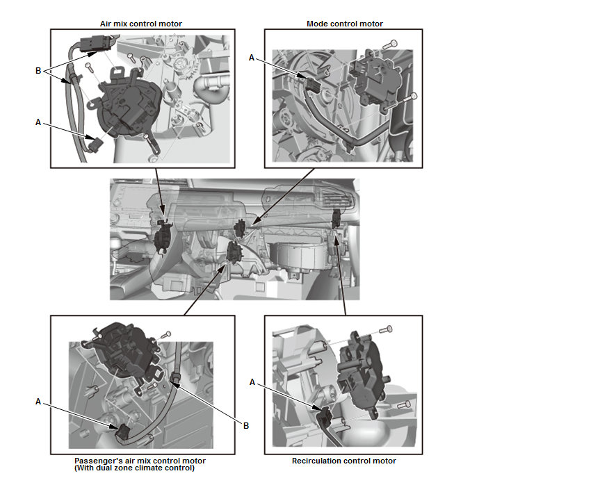

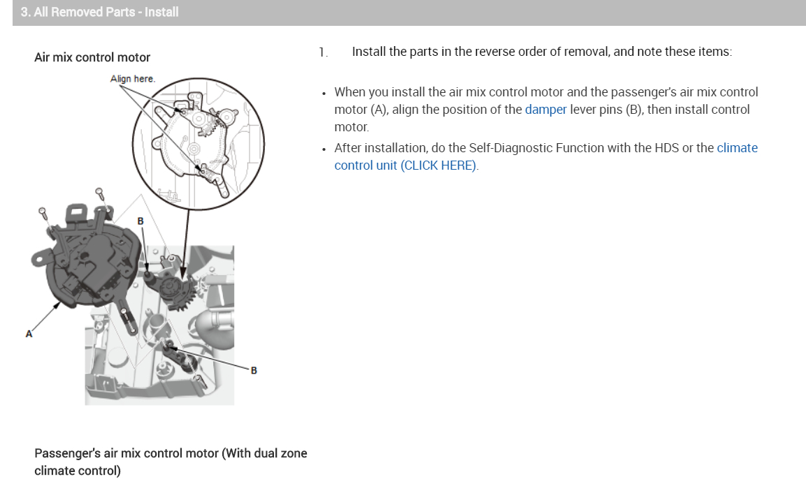

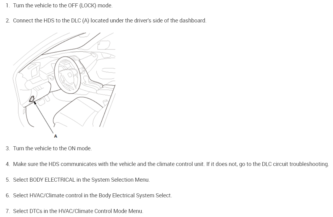

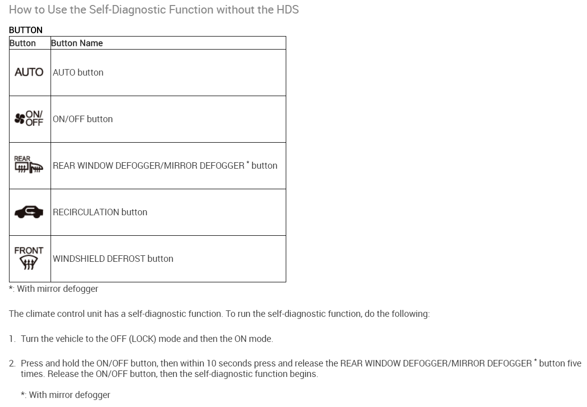

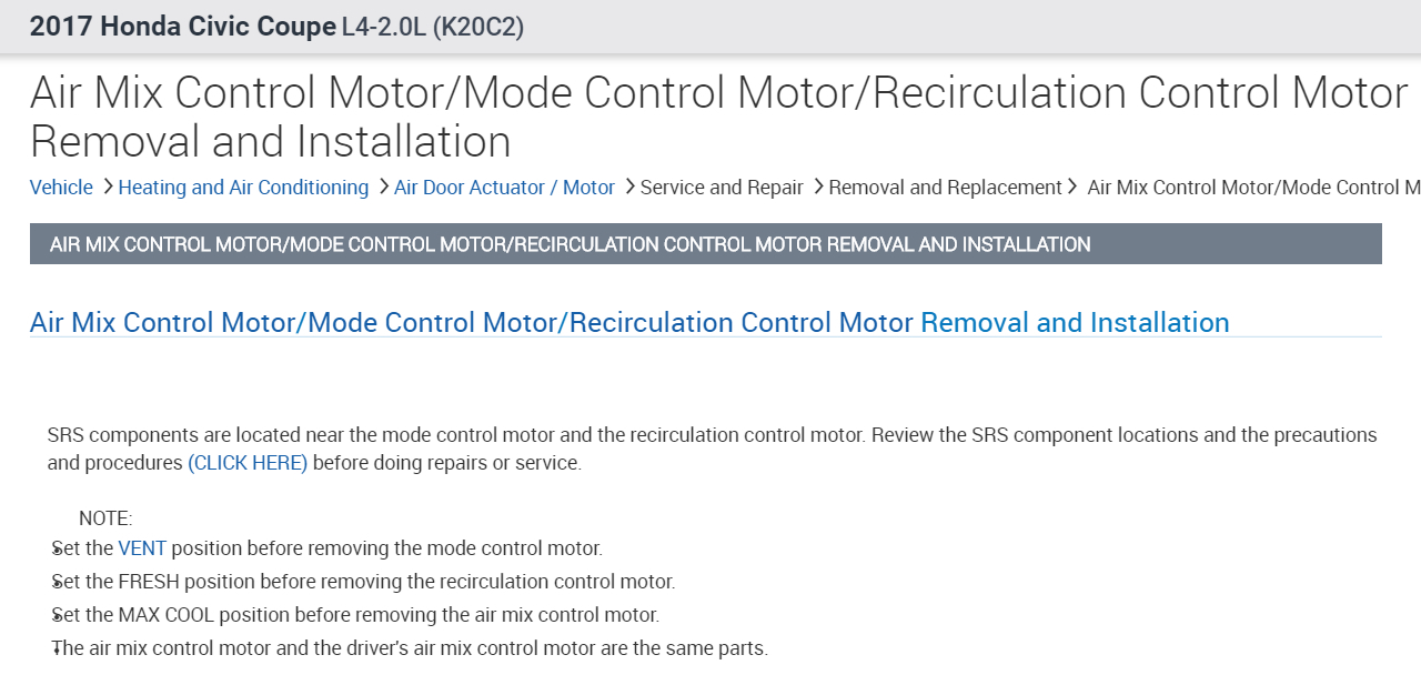

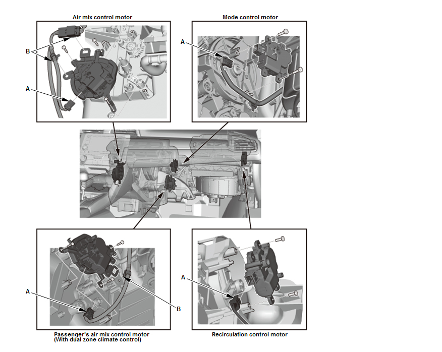

Hatchback Sport. Driver side temperature works fine. But passenger side comes out hot only no matter what I press. Have turned on/off. Sync on or off. Coldest or hottest. Can adjust temperature on driver side only. No matter what do passenger side comes out hot. And digital temperature only shows at top left of touch screen. No numbers showing at top right of screen.
