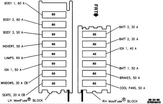

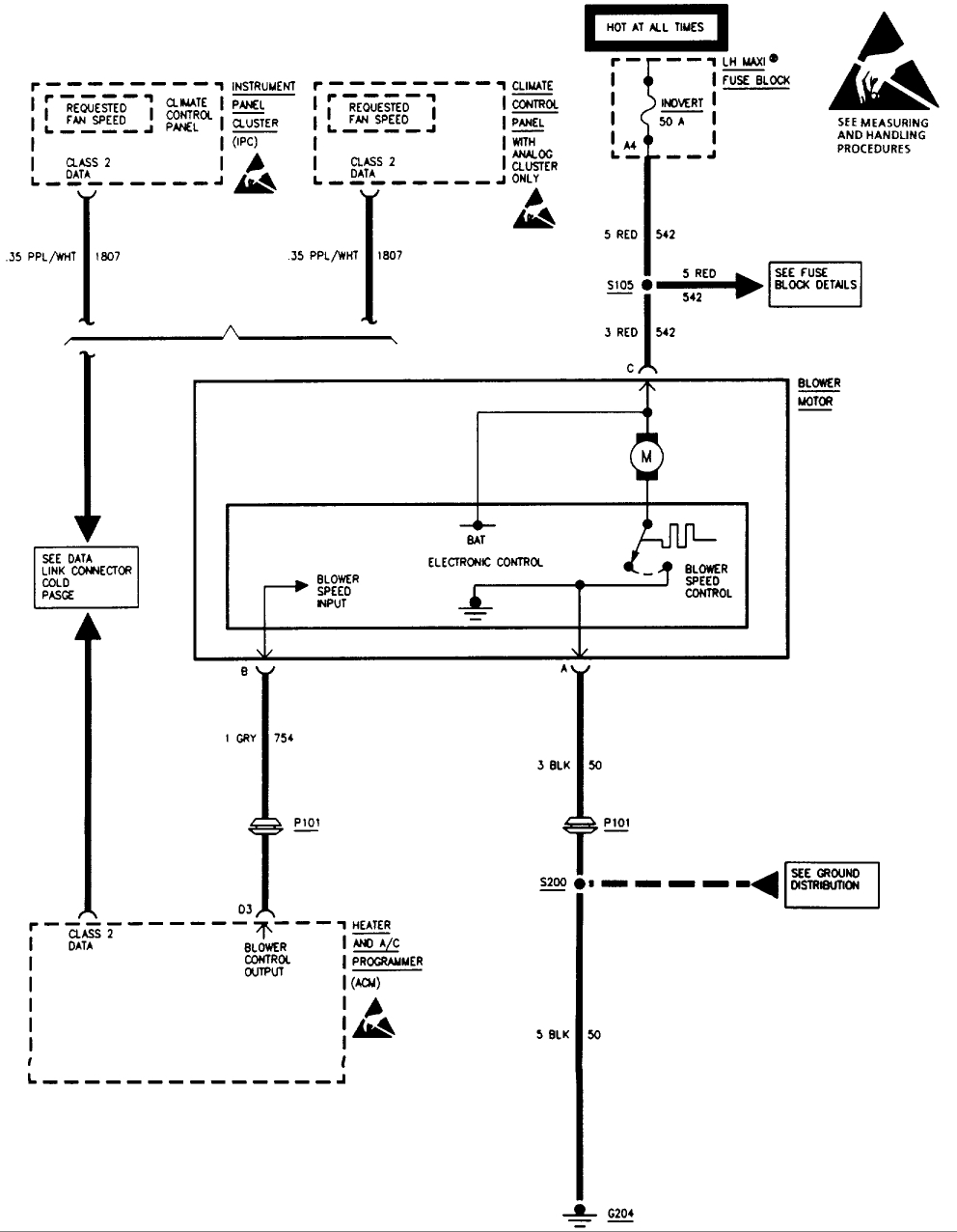

It is going to be one of the big fuses 50 AMP. It is called the indvert fuse located on the engine compartment on the passenger side.
