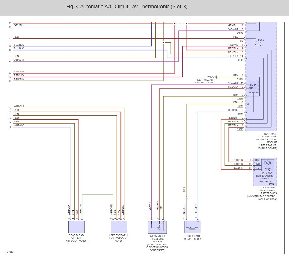

Hello, I have a C 300. A/C is not working, blower motor is not working and lines under the hood are not working. I need same help please. Thank you.
Jul 3, 2017 at 9:55 AM
Hello and welcome to the site.

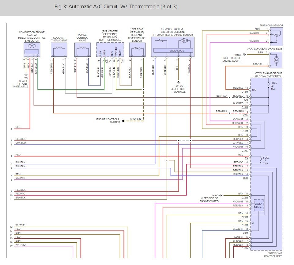

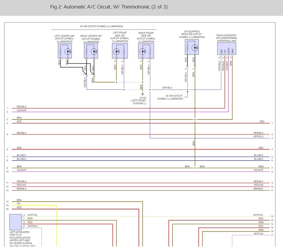

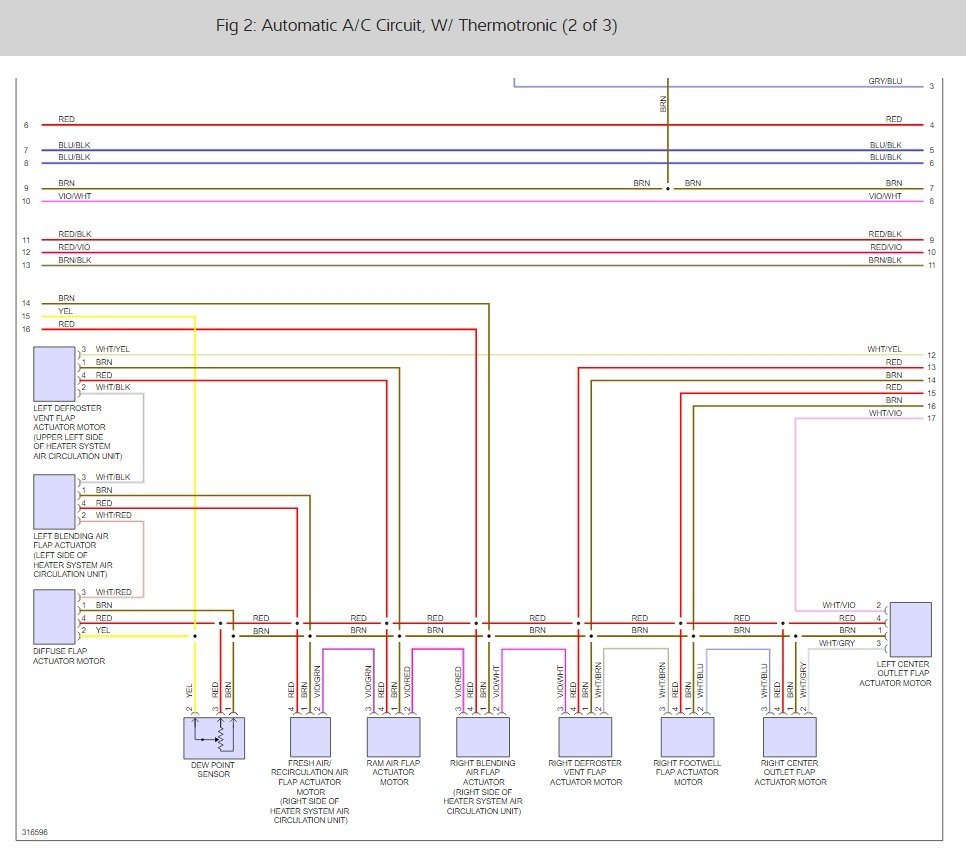

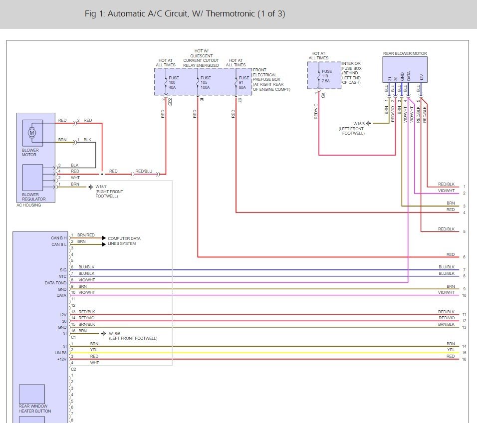

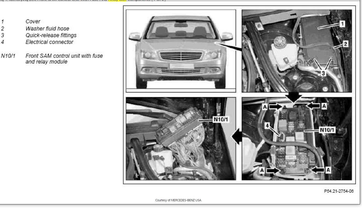

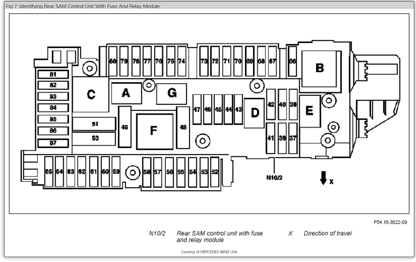

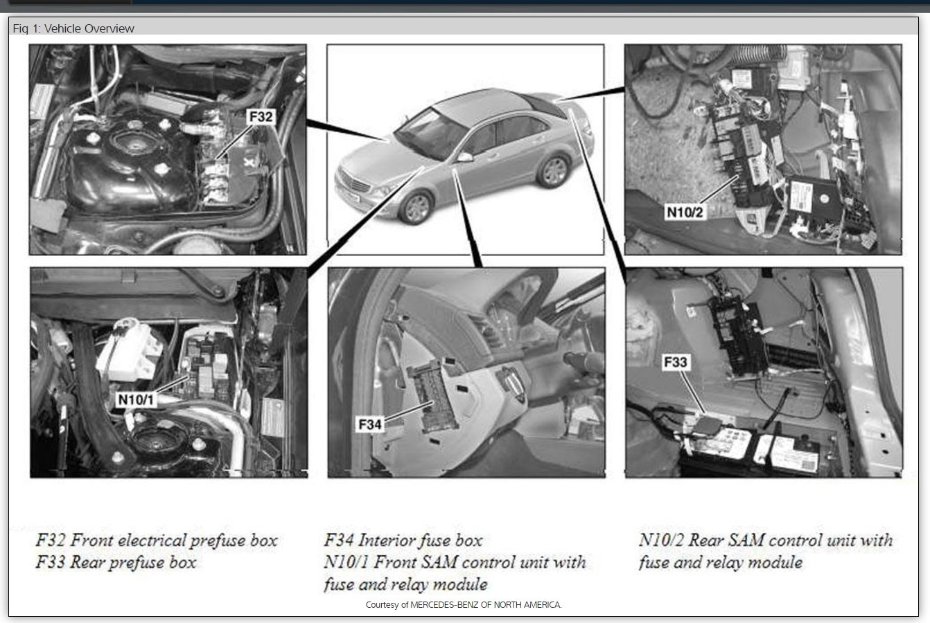

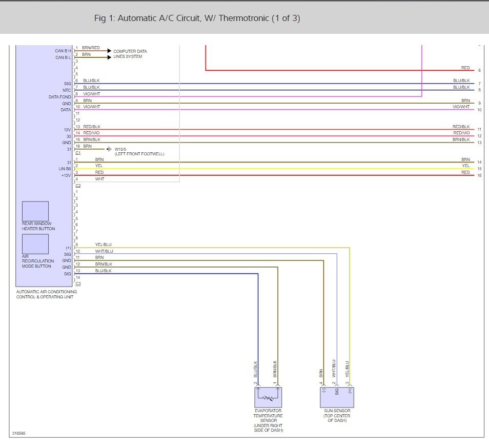

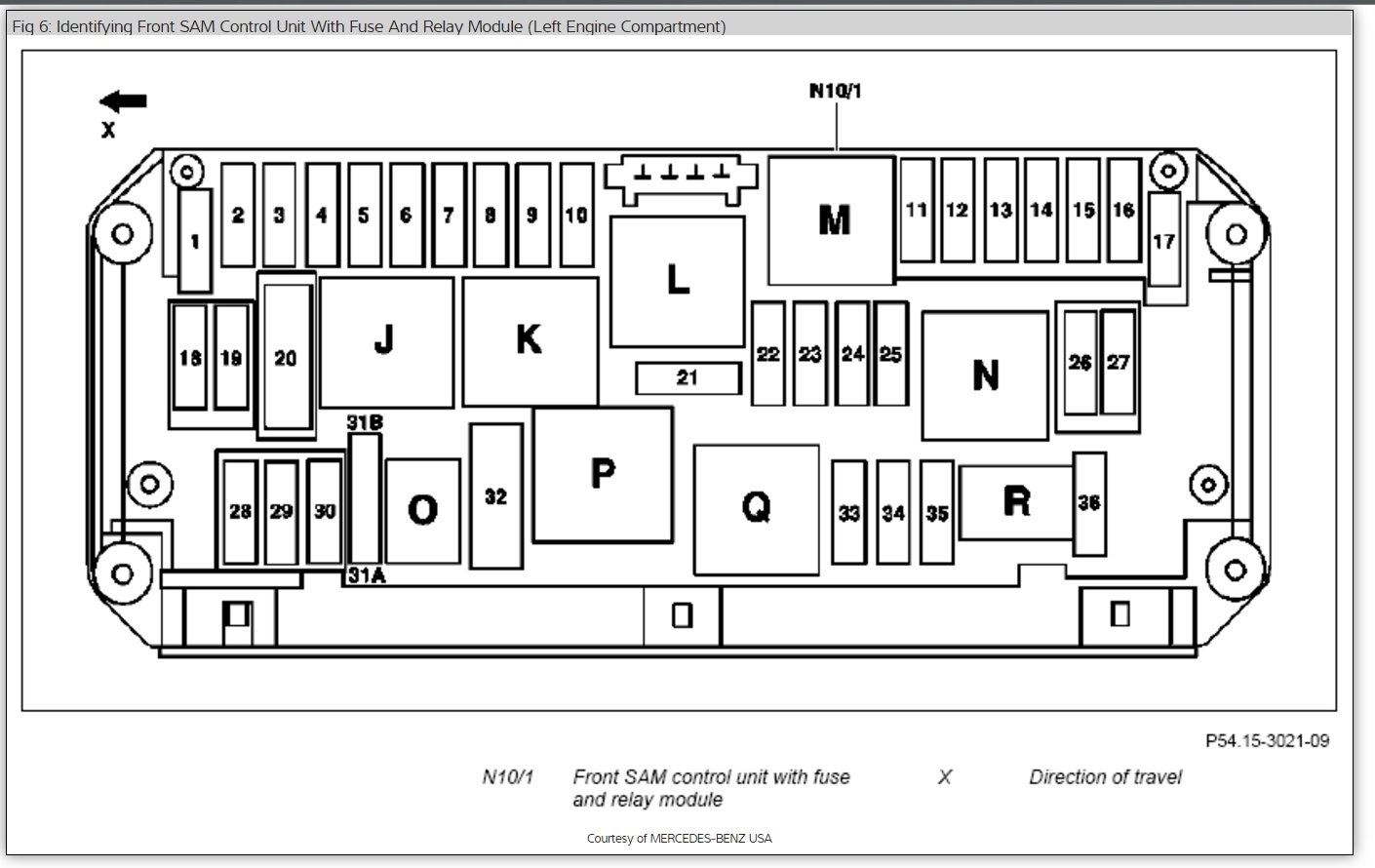

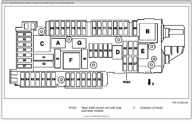

It sounds like you have blown a fuse or lost power somewhere here are some wiring diagrams (below) and some guides to help you do some testing and get the problem fixed.
and
Please run some tests and get back to us we are interested to see what it is.
