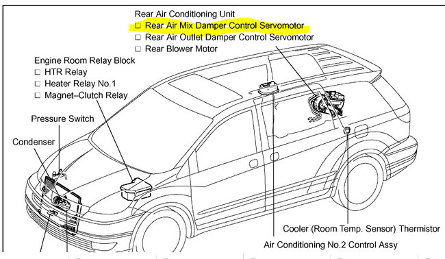

Last year the blend gate on the front passenger side stopped working. I had cold air all the time. I had noticed a clicking sound but ignored since everything was working and I was unfamiliar with the system. That was until my wife complained about her feet being so cold all the time any time we went somewhere.
Thanks to people like 2CarPros it pointed me in the right direction and I fixed it.
So my van listed above XLE model has the dual climate control and recently I have heard that same clicking noise in the rear. When I adjust the temperature control for the rear up and down at some point it stops.
Is there a blend gate for the rear?
Aug 1, 2020 at 8:27 PM
It does have one. I attached a pic of location below for you to see. Here is a link that shows in general how one is replaced:
Let me know if this helps.
