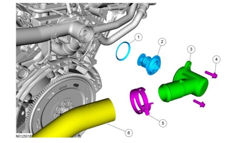

I would start by replacing the thermostat as the coolant may not be getting hot enough for heat at all times.
The other possibility is the heater core may be clogged. I would remove both hoses from the core under the hood and flush the core with a garden hose back and forth several times to get all the dirt and debris out of the core.

1. Drain the cooling system. Refer to Cooling System Draining, Filling and Bleeding .
2. Remove the ACL (Air Cleaner) outlet pipe. REFER to Fuel Delivery and Air Induction, Intake Air System Components - Exploded View .
3. Remove the 2 bolts and position the coolant inlet connection aside.
4. Remove the thermostat and the O-ring seal.
Discard the O-ring seal.

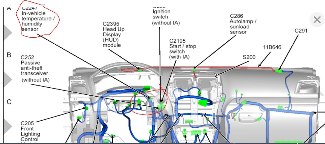

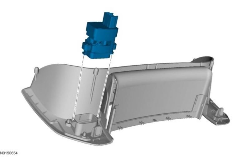

There is an in-car temperature sensor that sends a signal to the climate control module to adjust the temperature to the settings you request and maintain that temperature.
I attached the procedure and location for you below.
Removal
1. Remove the instrument cluster finish panel. Refer to Instrument Cluster/Carrier and/or Interior Moulding / Trim, Instrument Cluster Finish Panel .
2. Detach the in-vehicle temperature sensor from the instrument cluster finish panel and remove the in-vehicle temperature sensor.
Installation
1. Install and attach the in-vehicle temperature sensor to the instrument cluster finish panel.
2. Install the instrument cluster finish panel. Refer to Instrument Cluster / Carrier and/or Interior Moulding / Trim, Instrument Cluster Finish Panel .
