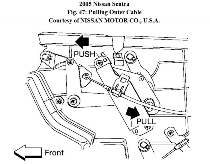

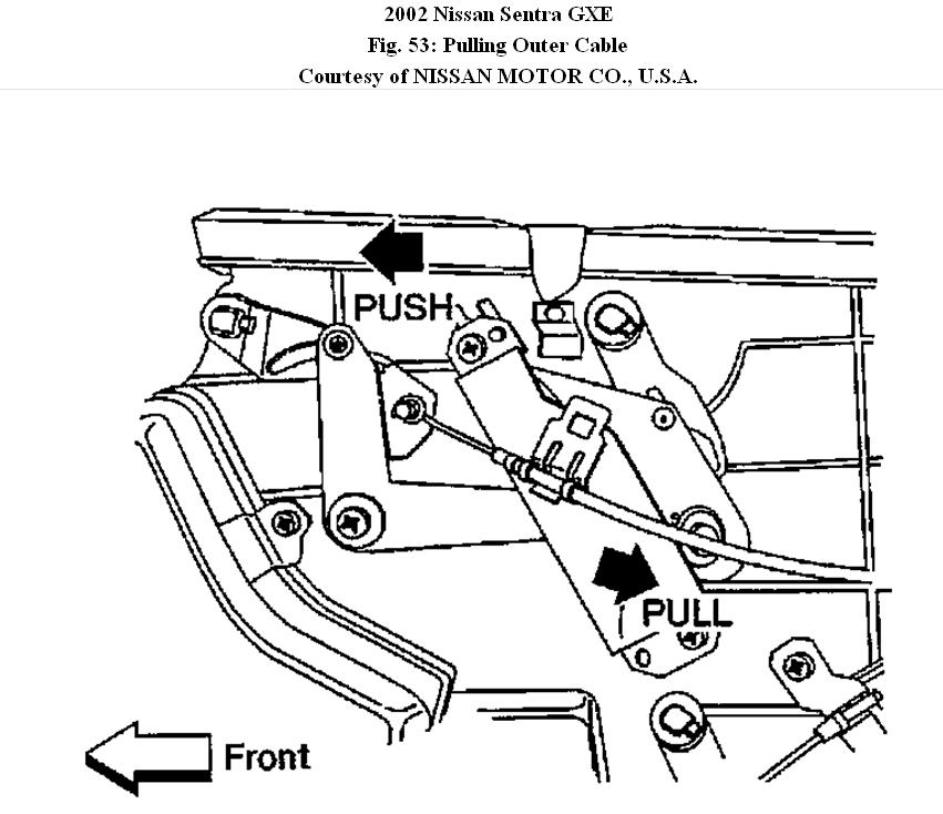

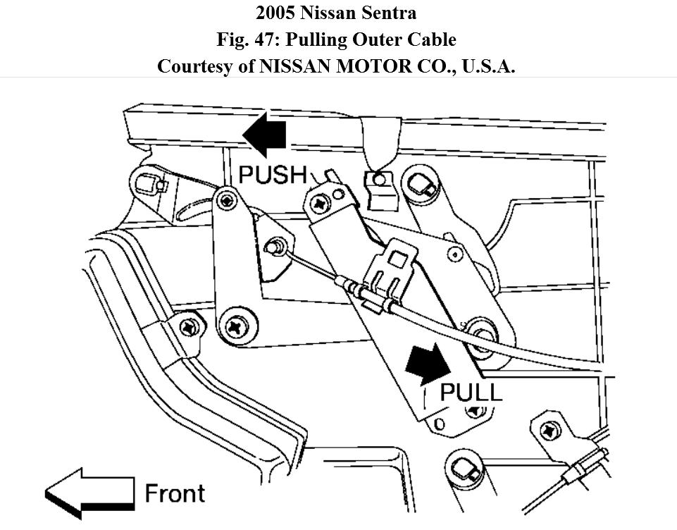

Check the mode door control linkage adjustment.
CONTROL LINKAGE ADJUSTMENT
Mode Door Control Linkage
• Turn mode door control knob to position.
• Set side link in DEF mode.
• Pull on outer cable in direction of arrow and then clamp it.
• After positioning mode door control cable, check that it operates properly.
© 2008 Mitchell Repair Information Co., LLC.
Nov 1, 2017 at 8:16 PM (Merged)
CAJUNGIRL
Where at is this diagram..can you give me more info on how to get to this cable with instructions and/or diagram please...?
KHLOW2008
  • 41,814 POSTS
If you look underdash, you would notice the second diagram as indicated.

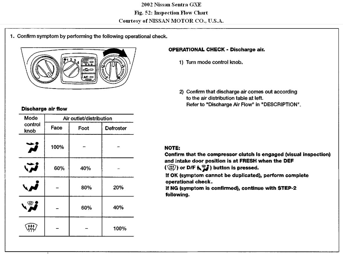

I have a Nissan Sentra 2005 and the control knob for the ac/heat is stuck blowing air out the front. I cannot switch it to defrost the windshield.
KHLOW2008
  • 41,814 POSTS
Knob is stuck or it can move but the air flow is stuck on one position?
HCHAMI11
It can move but the air flow is stuck on one position.
It's blowing air out the front and I can turn the knob but it won't change which way the air is blowing. This is only really a problem when trying to defrost my windshield when it's cold outside as I've been having to drive with the windows down.

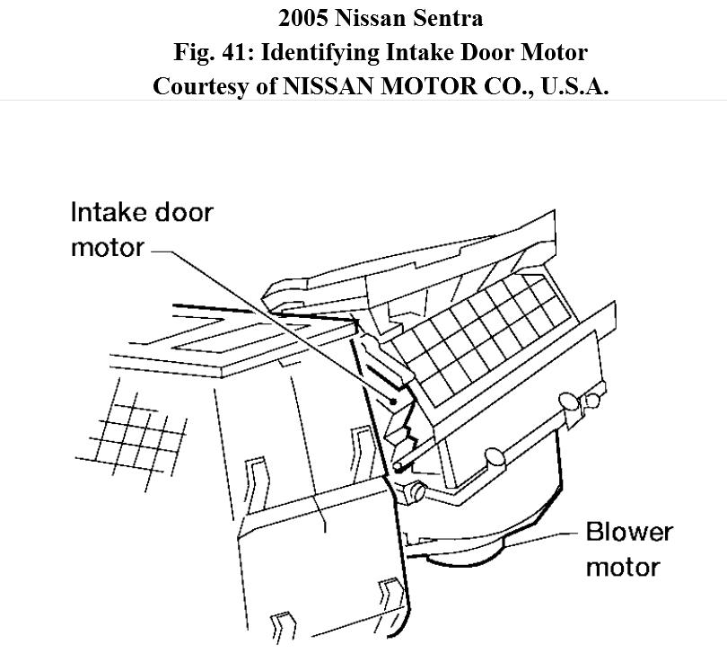

KHLOW2008
  • 41,814 POSTS
Check the intake door motor and linkage adjustment.
