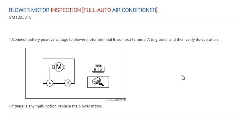

Below is how to inspect the blower motor so let's do this as well.
Let me know what you find with this. Thanks

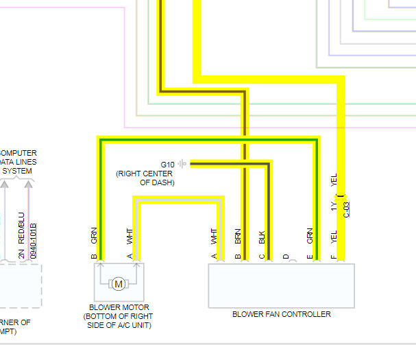

Okay. Thanks for clarifying that. I think we have a blower motor issue. It is odd that it is clicking as that is normally an actuator issue but I would suggest unplugging the motor and just running power and ground to the motor on a bench and see if it is clicking. If so, just replace it.
Basically you need to run 12 volts from the battery to the white wire and then ground the green wire and the motor will turn on. If it doesn't seem to work or it makes noise then clearly the motor has failed.
Take a look at this and let me know if you have questions on this. Thanks
