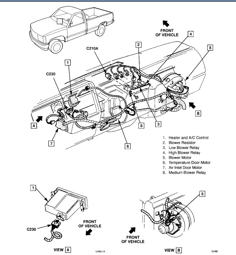

This can happen when a blend door actuator goes out and the system cannot control itself. Here are the locations of the blend doors and a guide to help walk you through the inspection. Move each one to see if they move at all when working the HVAC system.
Check out the diagrams (below). Please let us know what you find.
