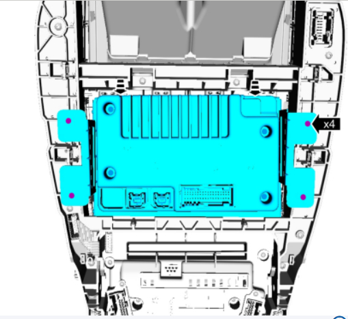

I know the touch screens go out all the time and I have had good luck with used parts from ebay. FYI. Just remove the panel and the FCIM unscrews from the backside. Check out the images (below). Please let us know what happens. Ken

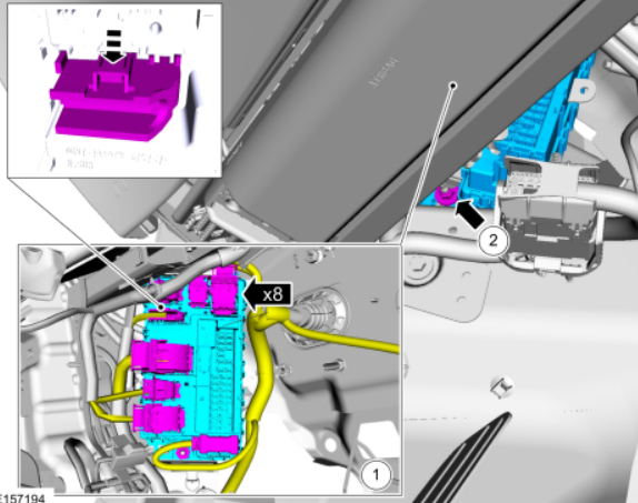

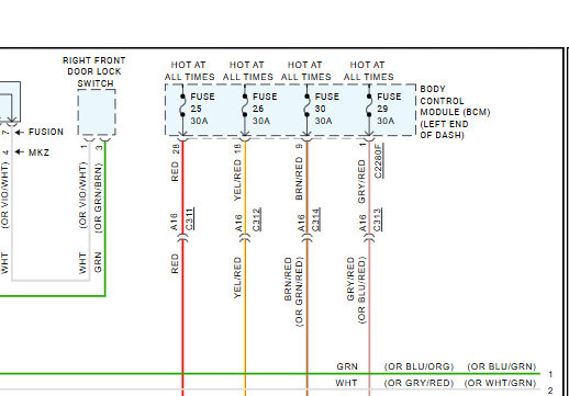

Yep if all of this happened at once it is not the FCIM. With the systems on I would use this guide and check the fuses on the BCM first.
Here are some of the fuses that run the systems. The BCM is located on the driver side under the dash. The CAN scan will tell us for sure. Check out the images (below). Let us know how it goes
