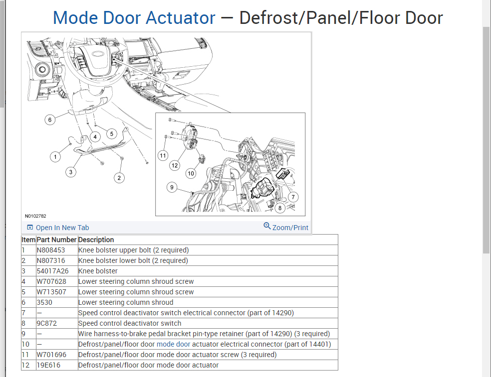

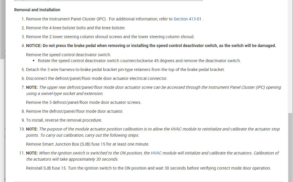

It does sounds like the mode door actuator is possibly faulty.
I have attached the replacement instruction for the mode door actuator.
