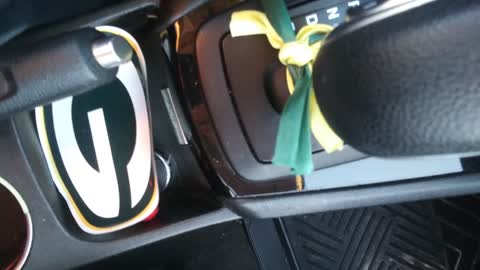

More Details. DPS6 transmission. 91,000 miles.
Faint ticking noise is the front end. Only when the car is in gear and moving. Not at idle. Not upon start. Ticking speed increases as speed increases but volume does not. No change when turning. Ticking pauses when the gear shifts. RPM's and gear shift is smooth without additional noise. Ticking disappears in higher gears. Ticking is not present when the car downshifts or coasts.
Regular oil changes, filter changes. Well maintained. The last oil change was about 3 weeks ago along with tire rotation and full inspection. New brake pads about 2 months ago.
I'll upload a video. Not sure if you can hear it. It's very faint.
Oct 26, 2022 at 4:30 PM
ZEBRASOT
  • 16 POSTS
Video attached.
Oct 26, 2022 at 4:35 PM
Thank you for the video. I could hear the noise. It sounds like a heat shield is loose for the exhaust manifold or exhaust system, with the engine cold use a rubber mallet to hit the exhaust system to see if you can duplicate the noise.
Oct 27, 2022 at 10:41 AM
