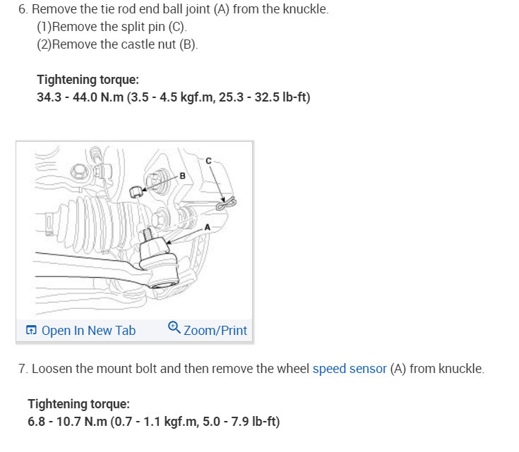

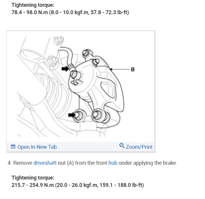

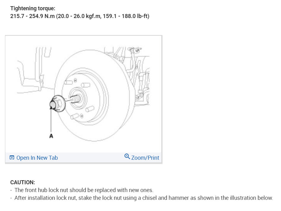

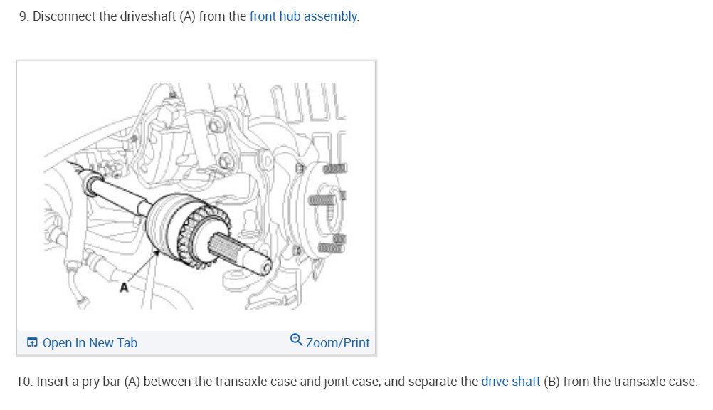

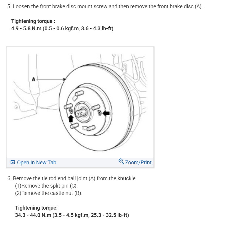

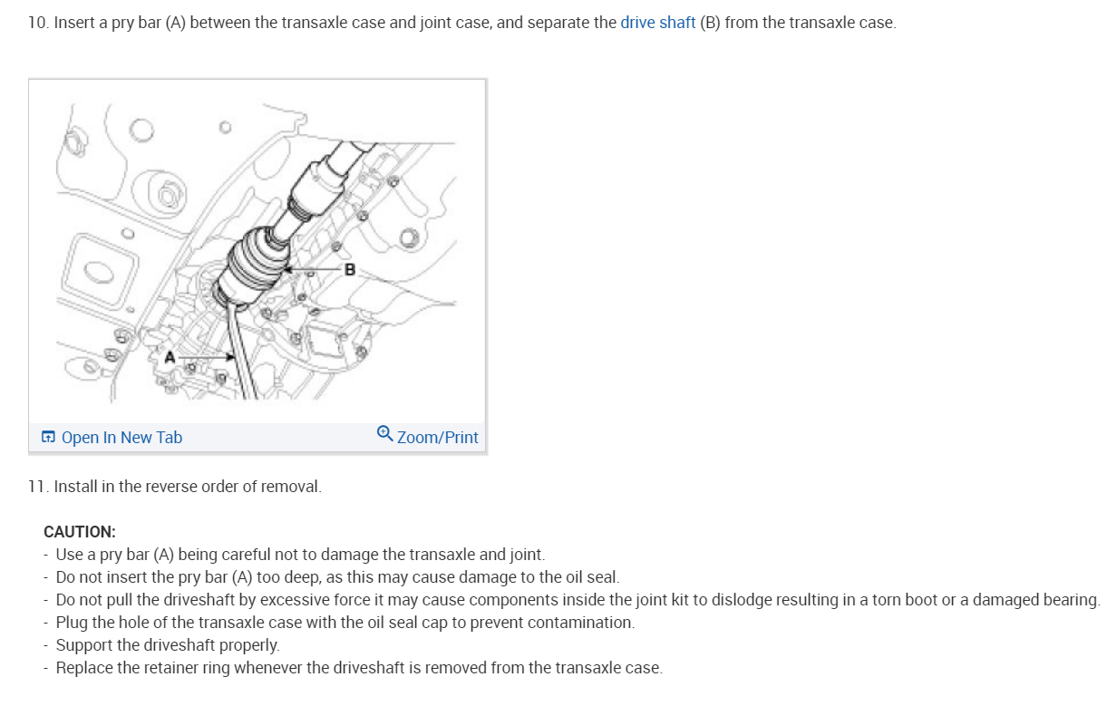

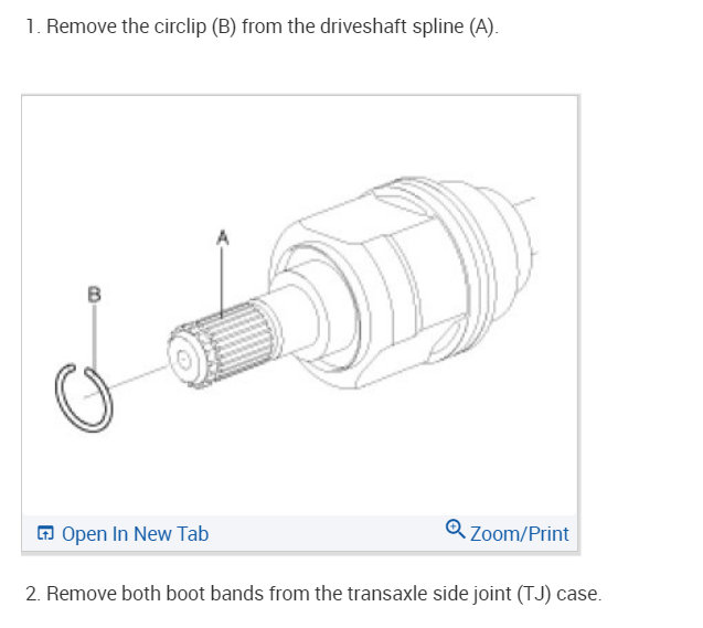

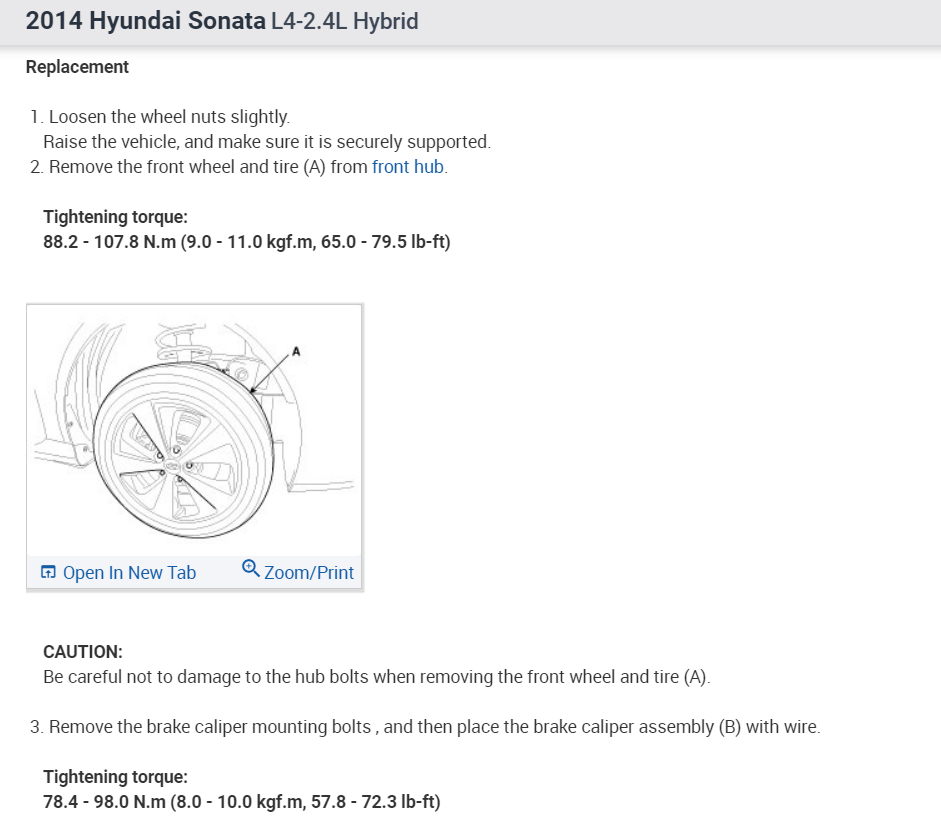

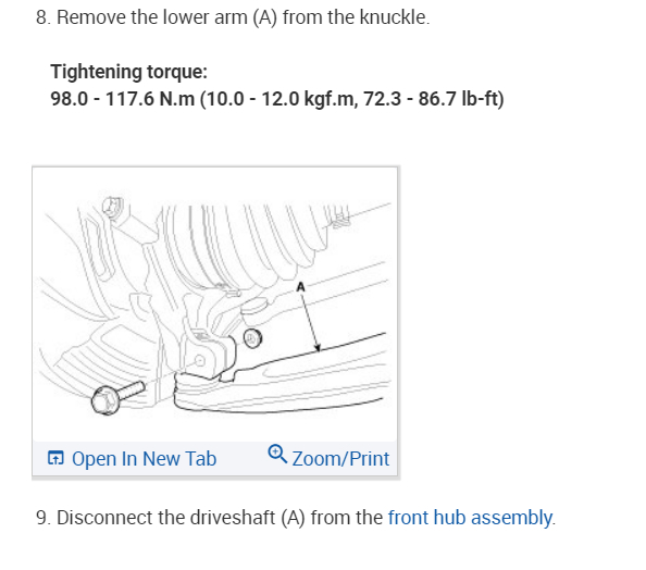

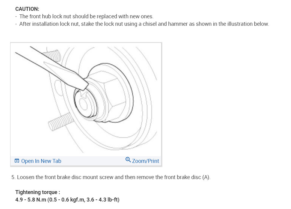

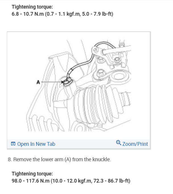

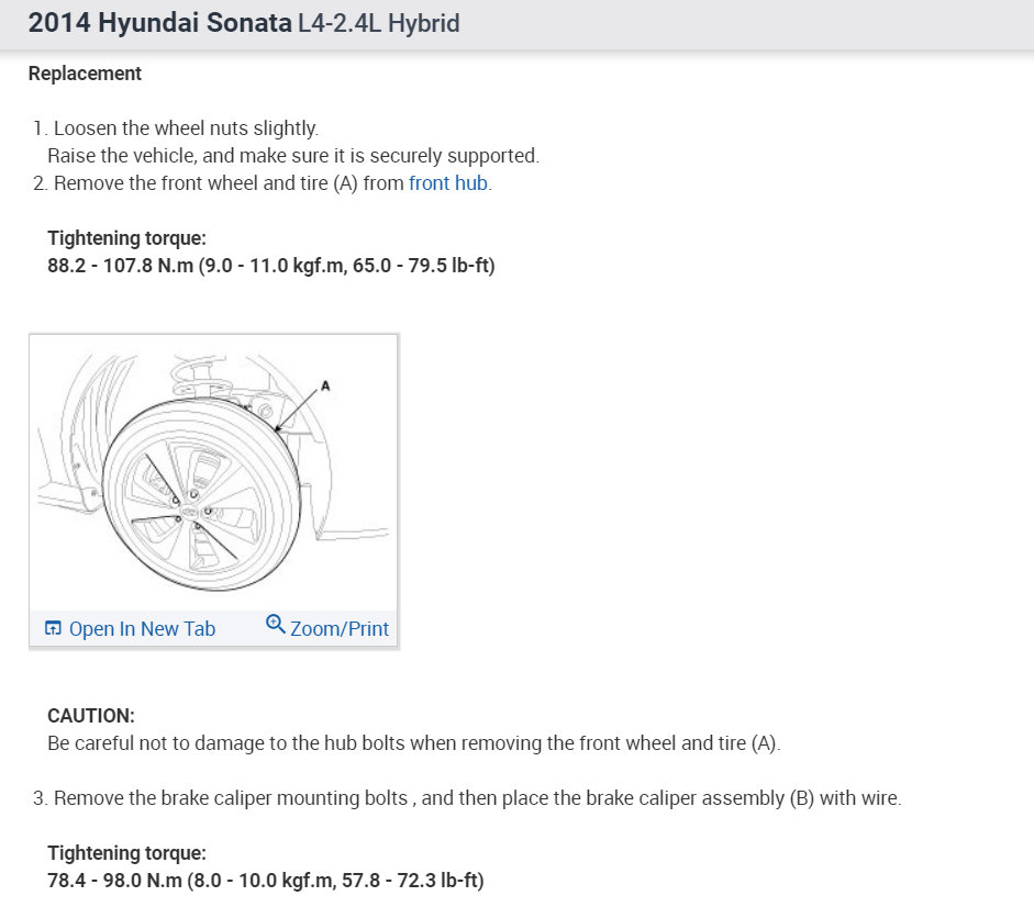

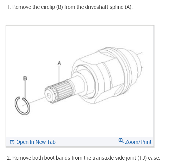

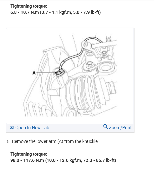

It does sound like the right CV axle is bad because it has to turn the most when in a right turn. Here is a generic guide on how to change out the CV axle with specific instructions in the diagrams below to show you how on your car:
https://www.2carpros.com/articles/replace-cv-axle
Jun 27, 2022 at 2:28 PM
