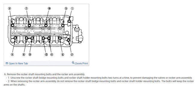

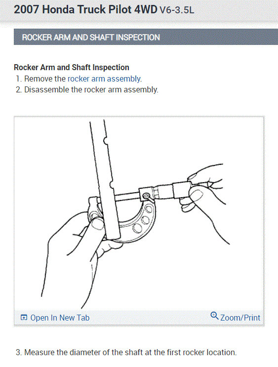

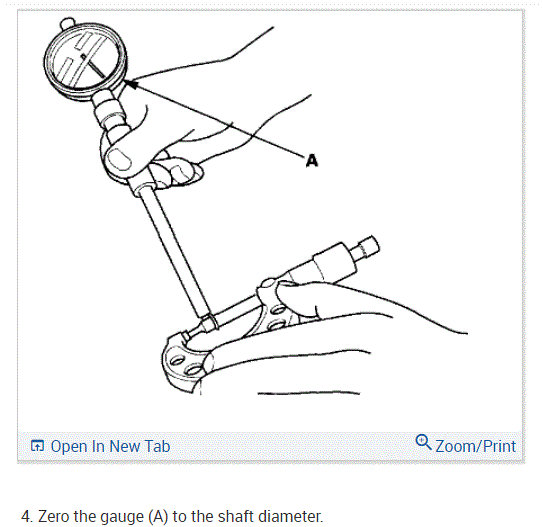

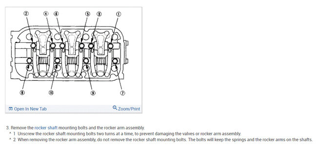

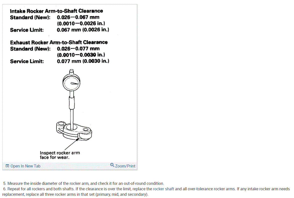

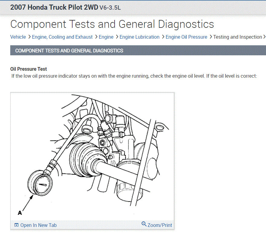

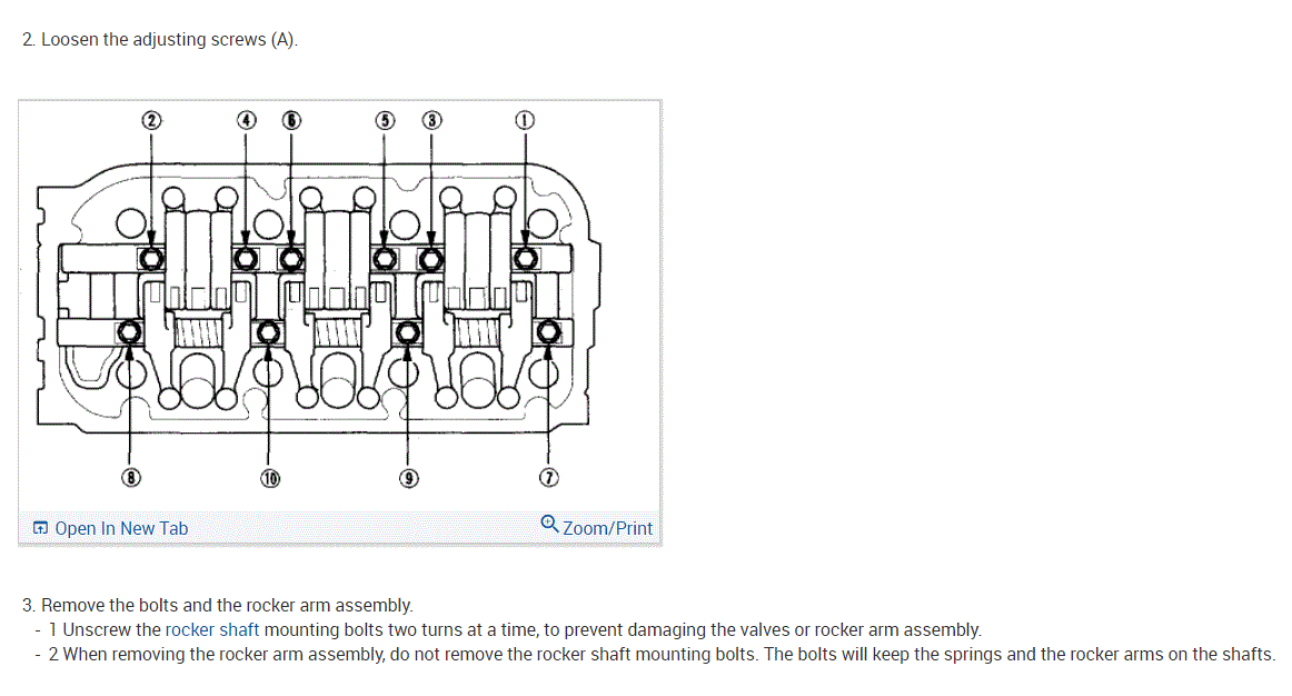

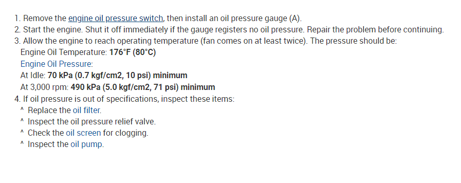

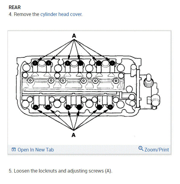

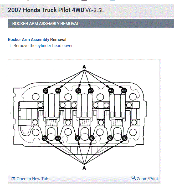

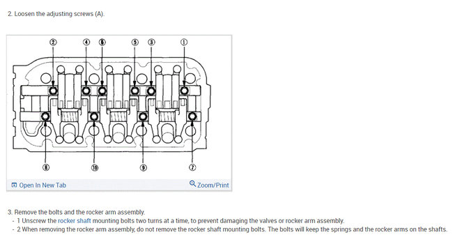

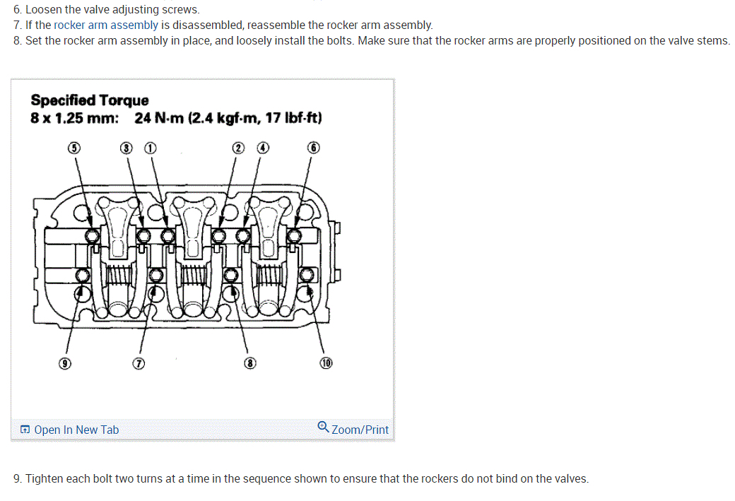

Hi, I am helping my friend with his vehicle listed above, trying to figure out a clicking noise. at first we thought it was valve adjustment, but nothing still there. The noise start when you turn on the engine and when you press on the gas it gets loud and when it shifts gears it goes away.
