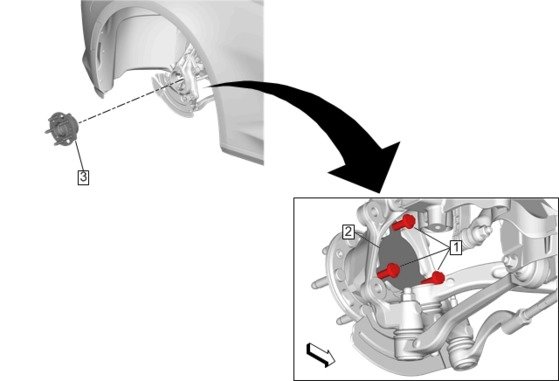

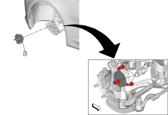

Hi again. No problem. I really did not help. However, if this is only happening when you turn the wheel and the car begins to move, my first suspect is the wheel/hub bearing. The bearing is what the wheel attaches to. I attached a picture of one for you to see. It is number 3 in the upper left component picture.
