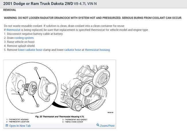

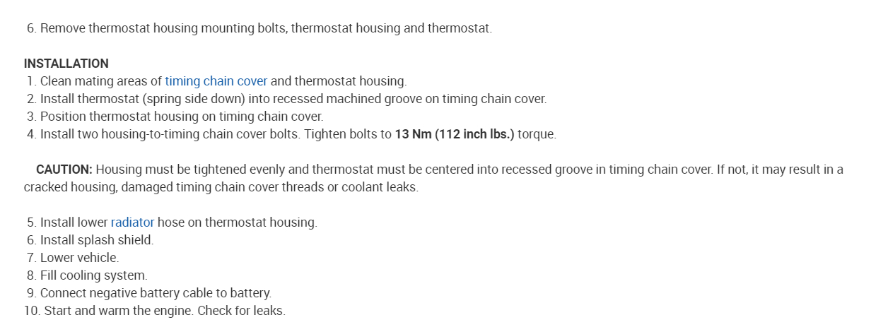

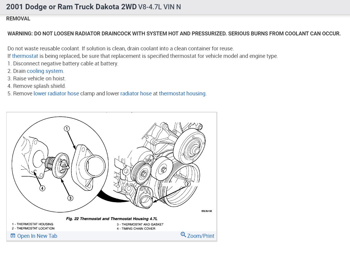

It sounds like it could be the radiator cooling fan barely touching the fan shroud. Can you please shoot a quick video with your phone so I can hear the noise? That way I can tell for sure what's going on. You can upload it here with your response. Please make sure nothing is hitting the cooling fan. The thermostat itself can make noise unless it is installed backwards, then the engine will pop and tick due to excessive heat. Here is a guide to show you the direction the thermostat should be installed:

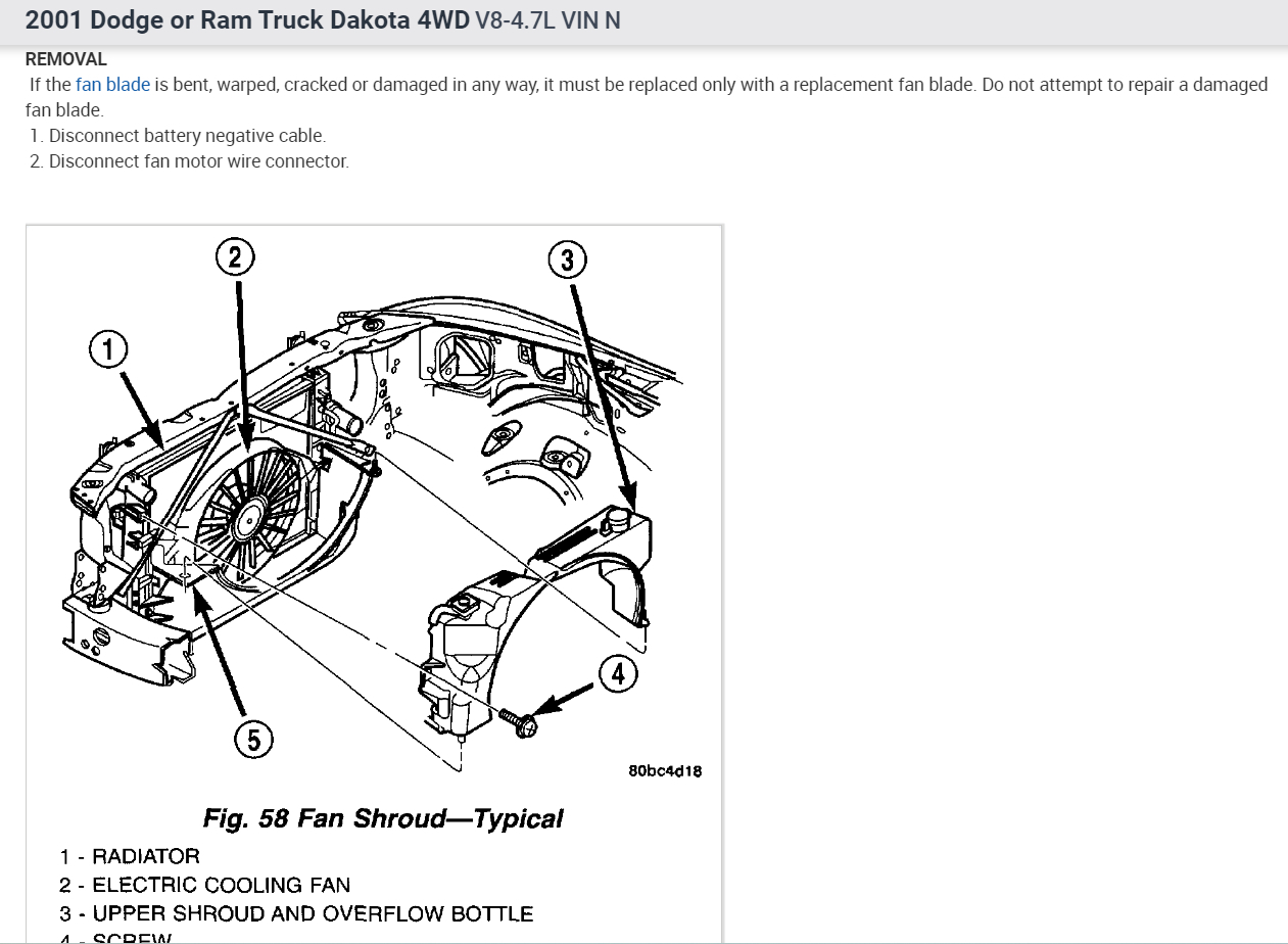

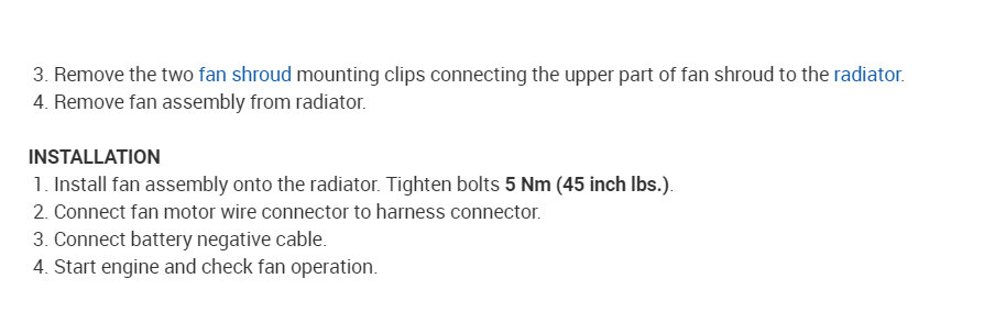

This truck has an electric cooling fan, correct? I have seen them make a clicking noise when they go bad, and this can make the engine overheat. Here is how to change it out in case you need it. Check out the images (below). Please let us know how it goes.
