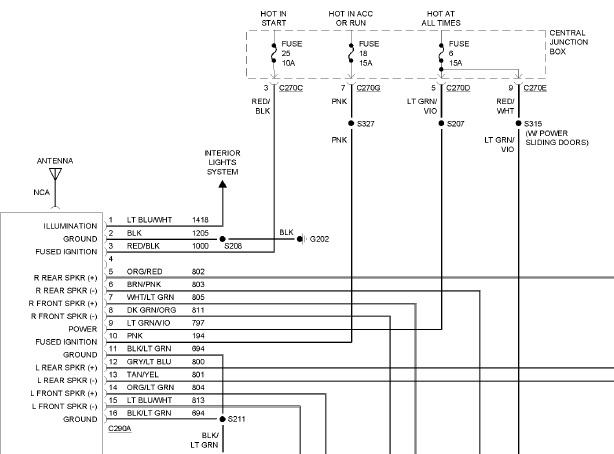

you can hear a click from the dashboard once that happens the radio, lights will turn off, or the windshields will go on and stay on or not work at all. The last time all lights and radio went off as well as air conditioning and power to doors went off. one you turn car off it returns to normal
