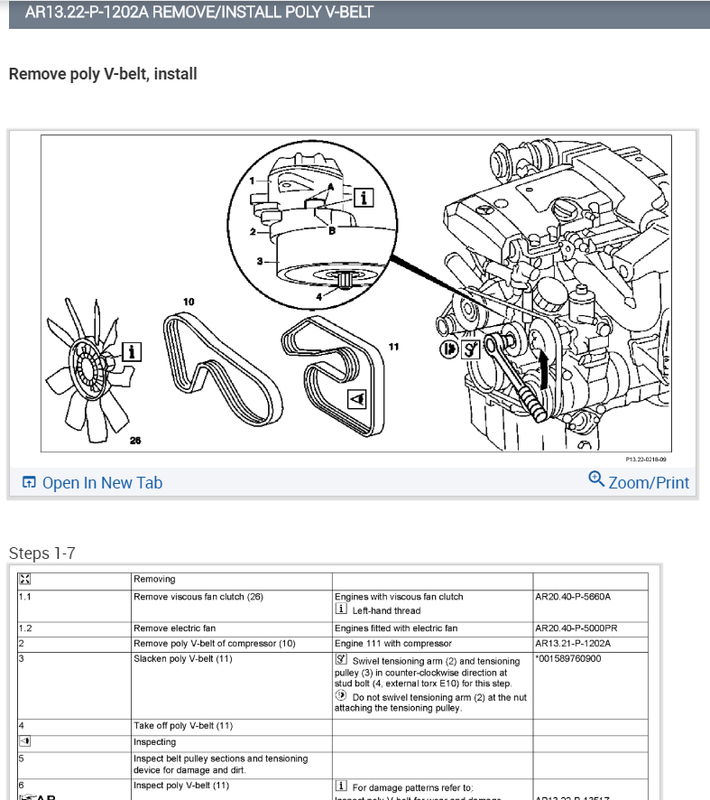

No problem. it sounds like the serpentine belt needs replacement. To be sure can you please shoot a quick video with your phone so we can hear the noise? that would be great. You can upload it here with your response. Here is a guide to walk you through the belt replacement with diagrams below to show you how on your car:
https://www.2carpros.com/articles/replace-serpentine-belt

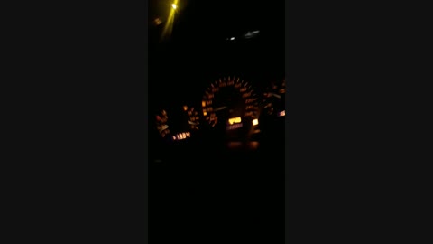

Yeah, belt looks pretty rough and thank you for the instructions. but i think this is something else. I only hear it when car is going like over 35 km/h here is the video. PS. someone suggested me that it is something with driveshaft(cardan).

Thanks for the video. That sounds like a drive line or suspension problem, when the car is at a stop in neutral rev the engine is the noise still there or only when driving?
