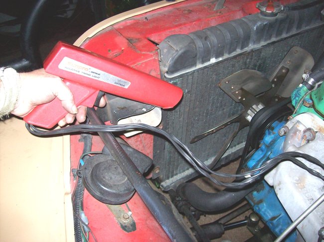

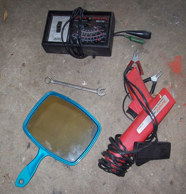

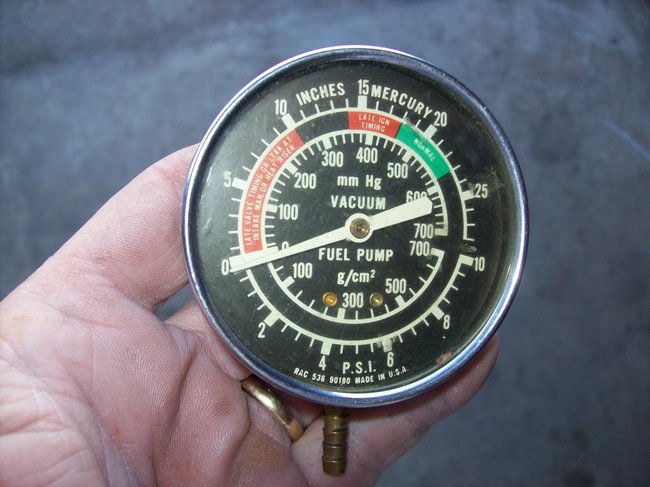

Do you have/can you get a dwell/ tachometer meter or a vacuum gauge and a plain Jane timing light to do some tuning? Doing this by "ear" is almost impossible.
