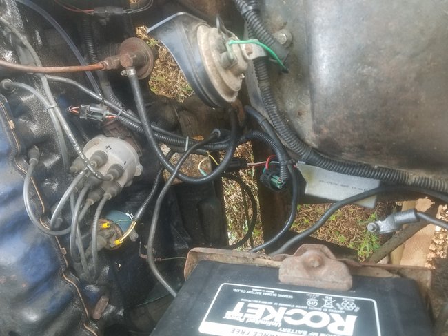

Picture 1: My ignition coil. There are two wires connected to the positive terminal. The yellow wire connects directly to the ICM, and the other white wire was not plugged into anything. Any insights on this would help.

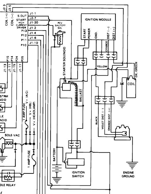

From you description of the condition, it sounds like you're on the right track. If you're getting a spark pulse from the coil(even if it's weak) that means the ignition control module is sending a signal to the coil to fire. Double check the connections at your coil. The wire leading to the ignition control module should be connected to the negative terminal on the coil. The wire on the positive terminal should have battery voltage on it while the engine is cranking. If everything checks out there, go ahead and get a new coil. For your reference, I've attached the original AMC wiring diagram for a 1983 model. I wouldn't completely rely on the wire colors as a lot of that stuff can change over the years, especially if the vehicle has been through an engine swap.
