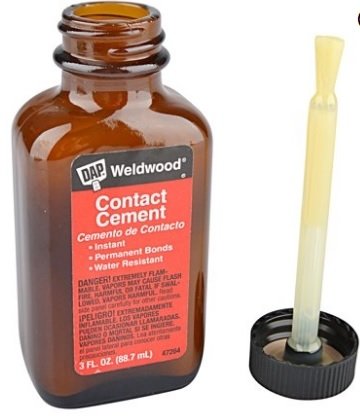

We will use contact cement. See my pic below. I get this a Wal-Mart in the hardware section, usually hidden on the bottom right side of the shelf. Hardware stores have it too. It's yellowish in color and somewhat stringy.
Ever so sparingly coat the valve cover's gasket surface and the top gasket surface of the new gasket with contact cement.
Orient the gasket before you apply it, as you don't want to apply it to the wrong side.
These glued surfaces will stuck to each other soon. the glue doesn't have to be thick, just completely wet the surfaces.
Wait a good 12-15 minutes then carefully stick them together. They should bond instantly so place them on there perfectly with the holes lining up.
Use your fingers to mash them together well.
Now we have a well sealed gasket to valve cover that will not move or suck under.
