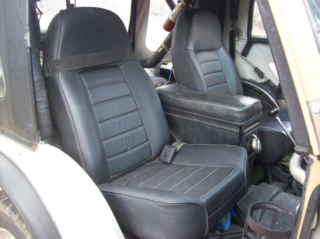

I've had a set of Bestop seats for several years sitting in my man cave, my buddy came over a few weeks ago and helped me put them in.

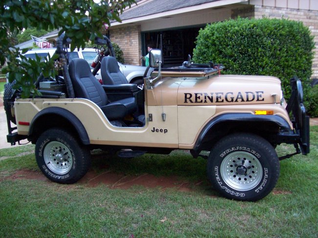

The ones we took out were "Steel Horse" which I installed back in 1991 when I got this CJ-5. I think there is a tear or two (or not) in them but that's all been covered up with nice vinyl seat covers. I'm thinking I got the covers just to protect the seats. It's tough when you can't remember stuff like you used to.
These Bestops are a little wider at the bottom and don't wedge my butt with the side pieces as the others did.
A picture from around 2010 of the old ones without the covers at the bottom.

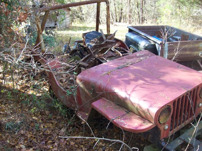

'Course, my buddy and I might have enough stuff out in the woods to do it ourselves. The ole red one might qualify all by itself.

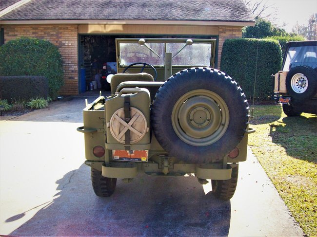

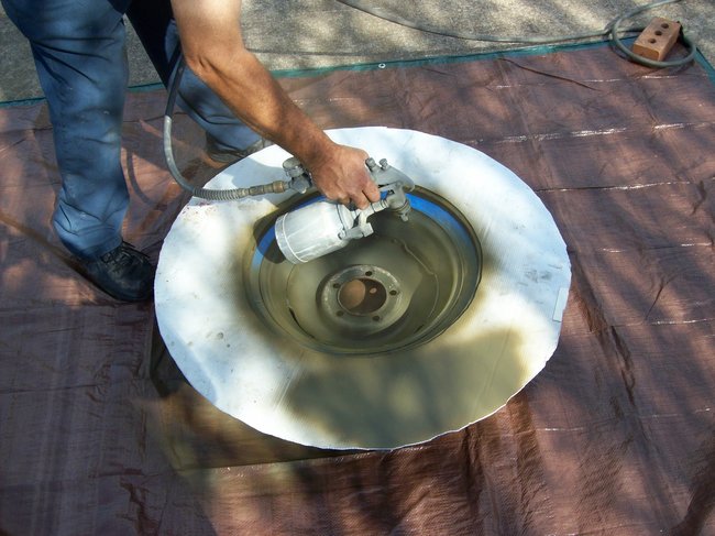

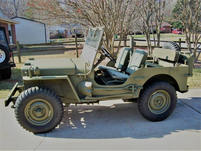

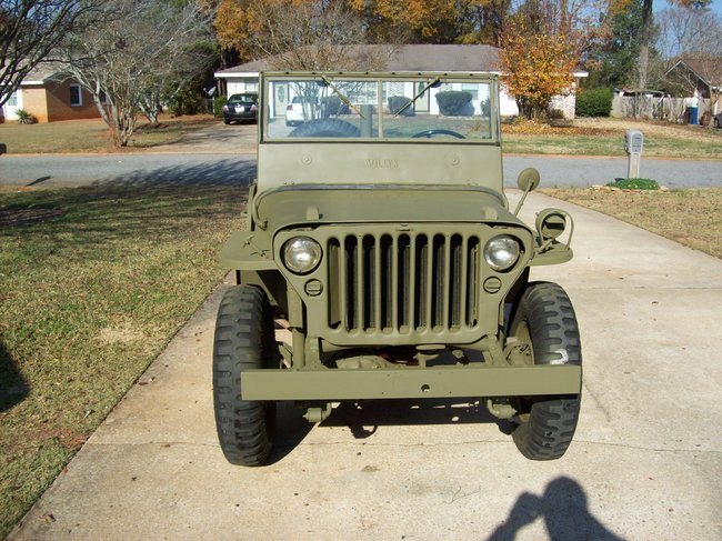

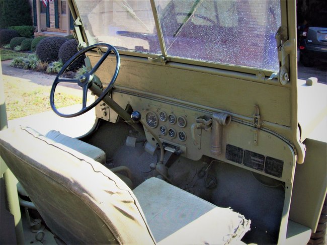

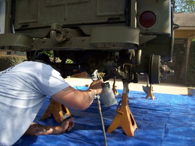

Here's some pics of Willy hours after my best paint job. This is before the insignia went on.
Waiting for your updates!
