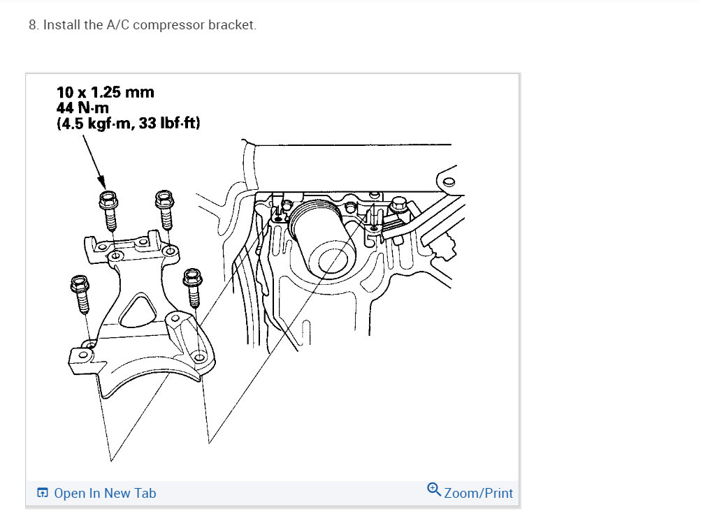

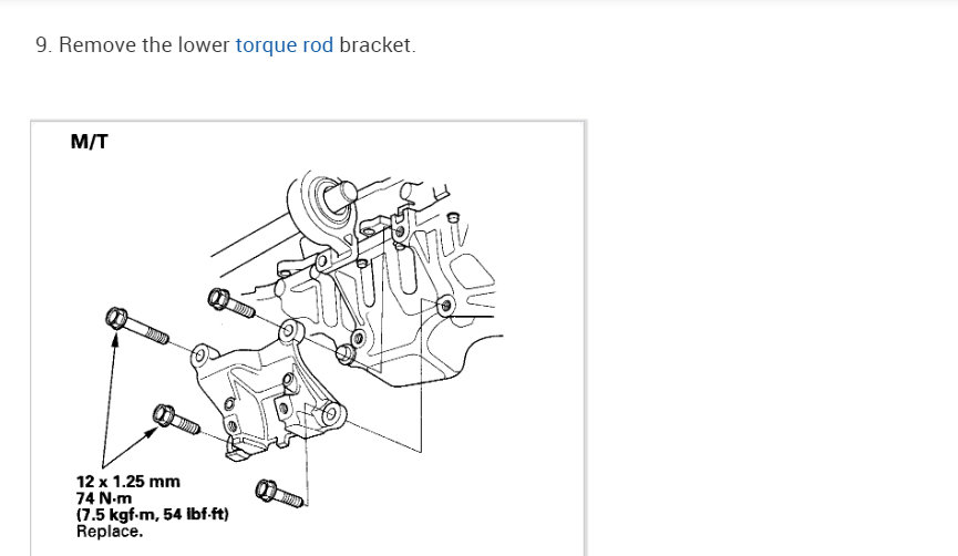

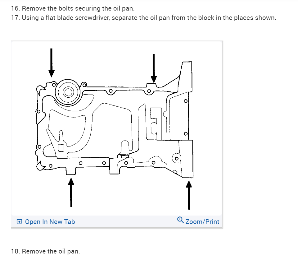

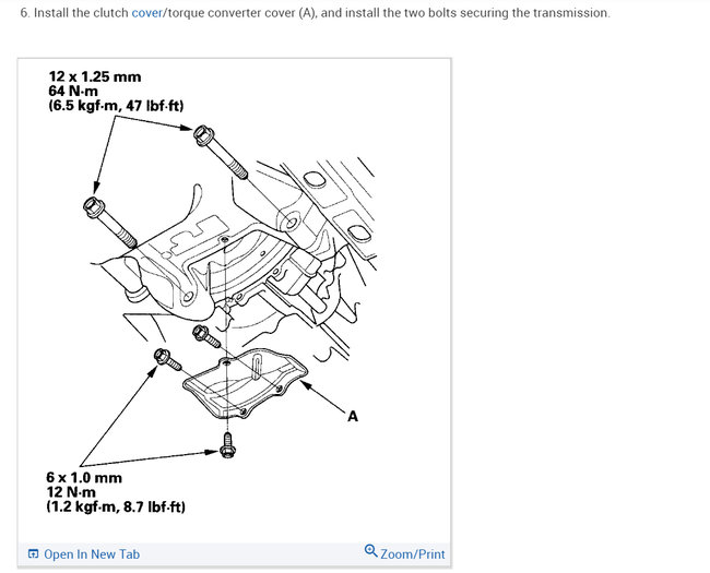

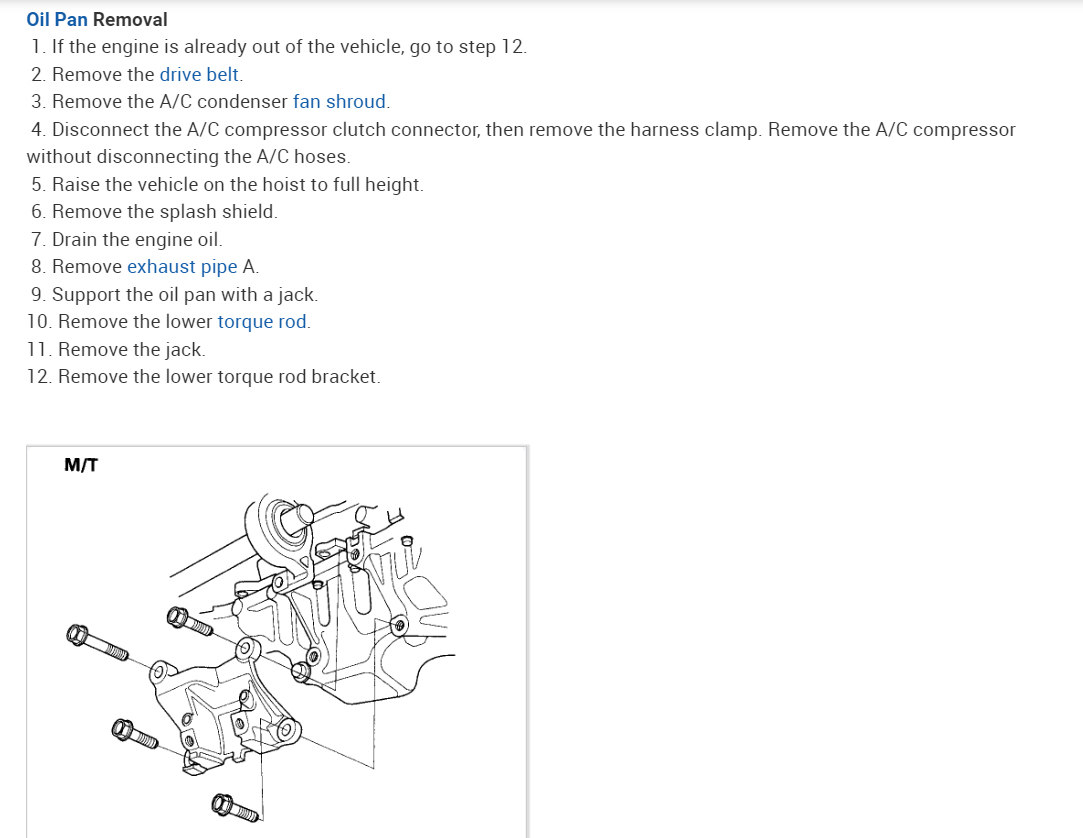

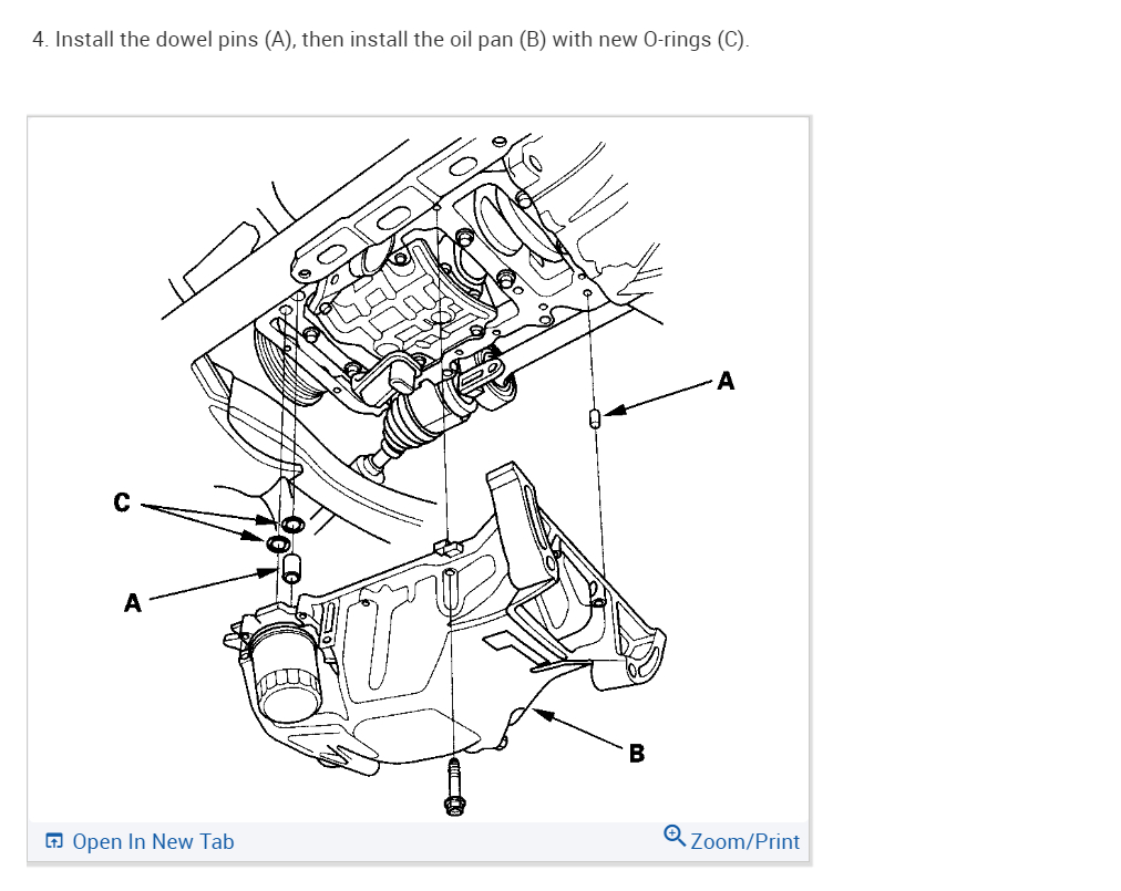

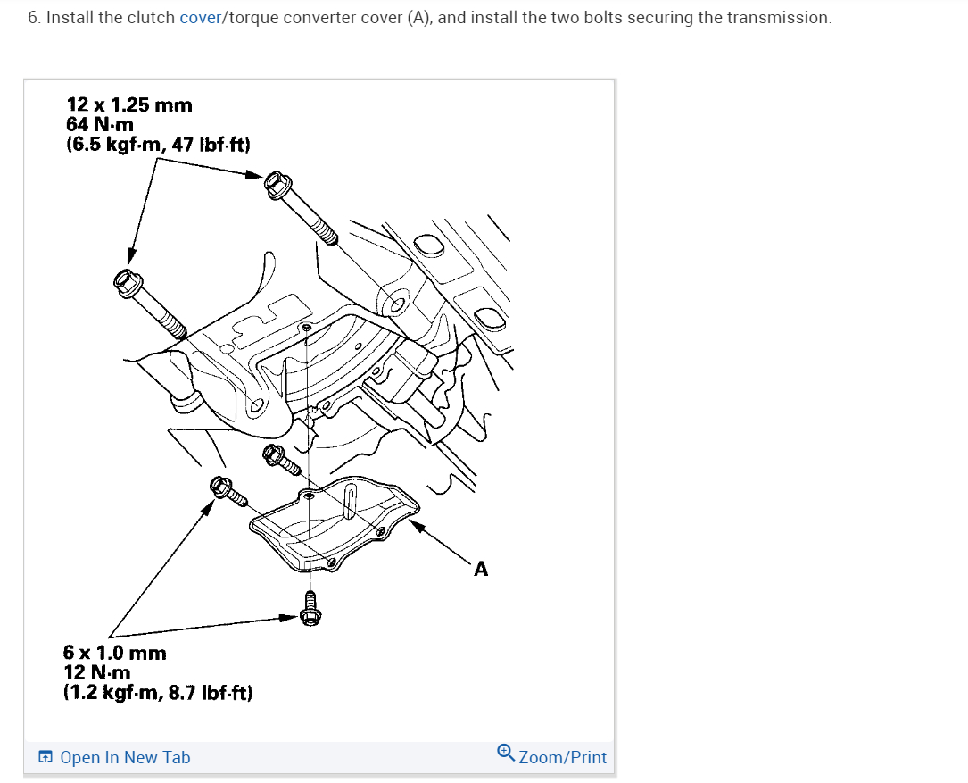

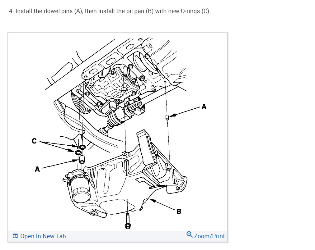

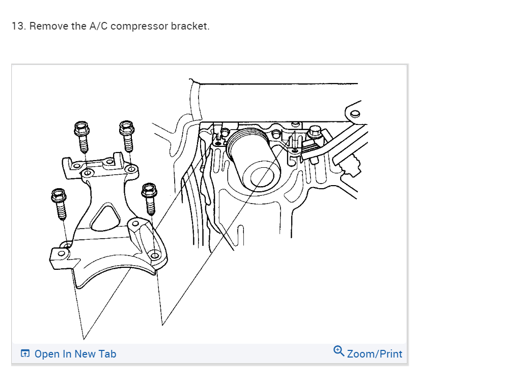

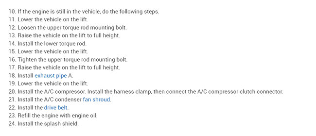

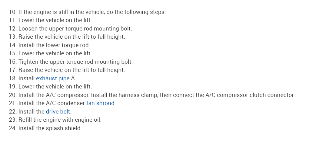

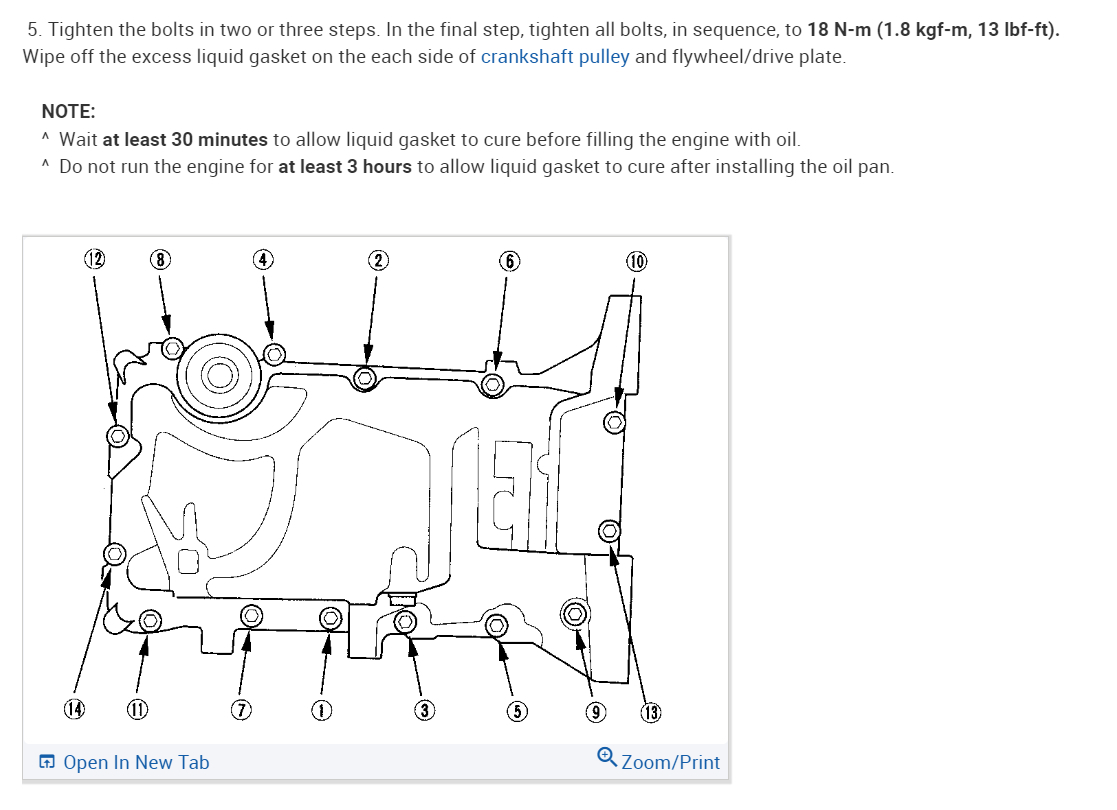

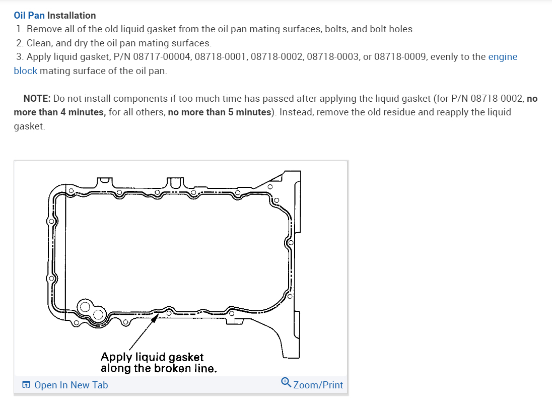

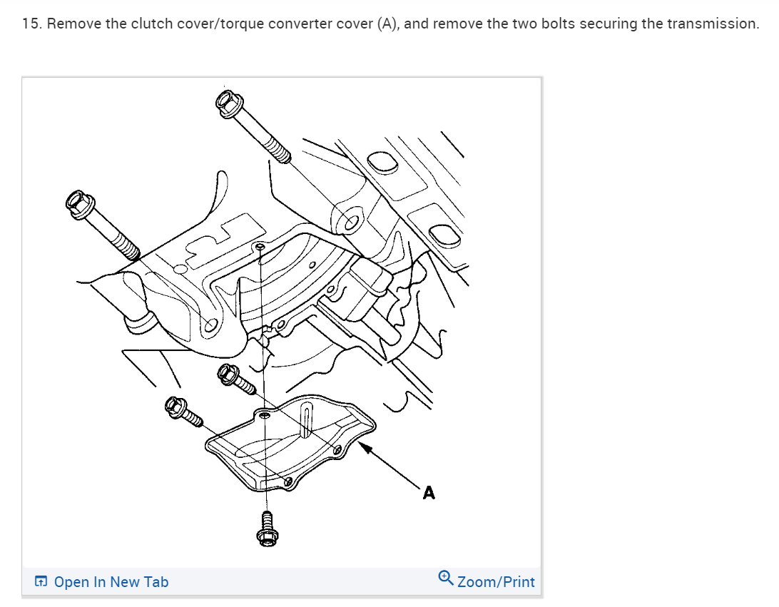

Hello, yes on these the A/C compressor needs to be unbolted but not the hoses. Just the electrical plug for it and move it out of the way. Exhaust pipe A needs to be removed, that's the section in the way. I'll post the instructions for removal and installation. These are difficult ones to do on the ground. The first diagram is steps 1 to 12. Step 14 is not there, as it's for automatic transmission.
Step 9 on the Installation is a mistake, its install not remove, but it does give the correct torque specs.
