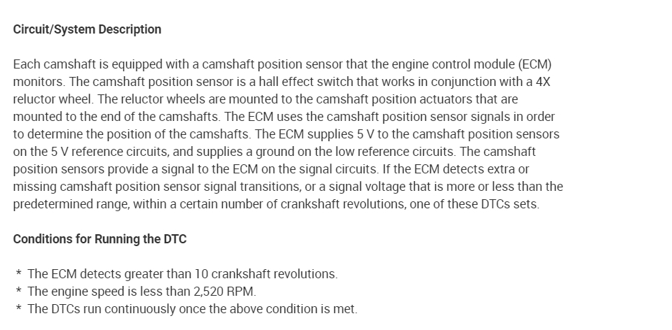

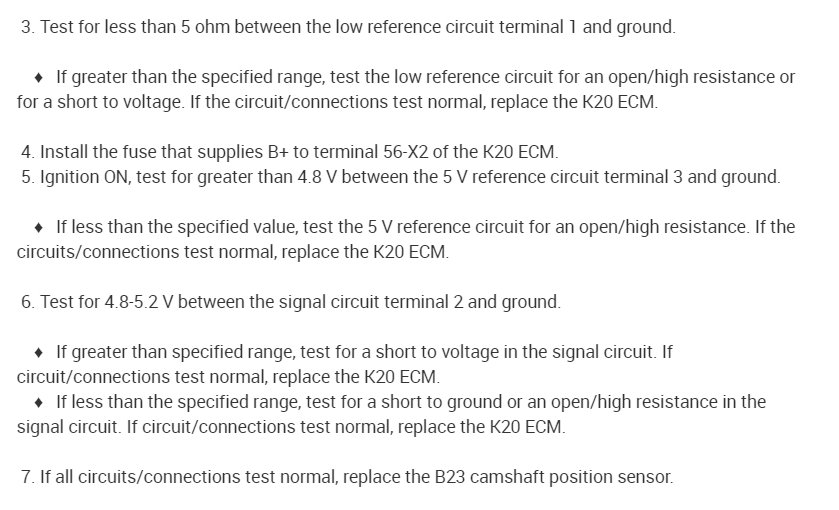

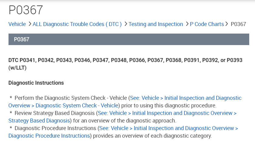

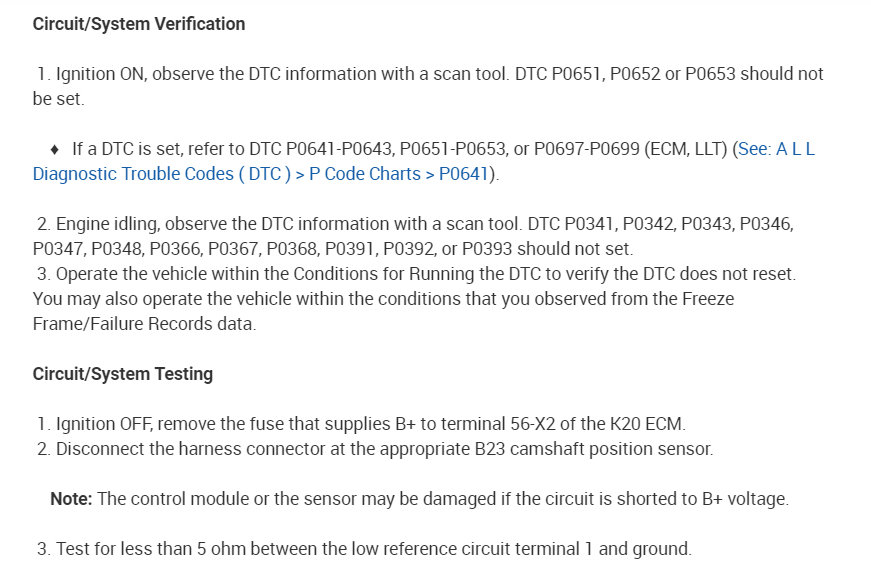

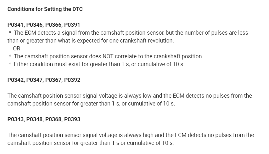

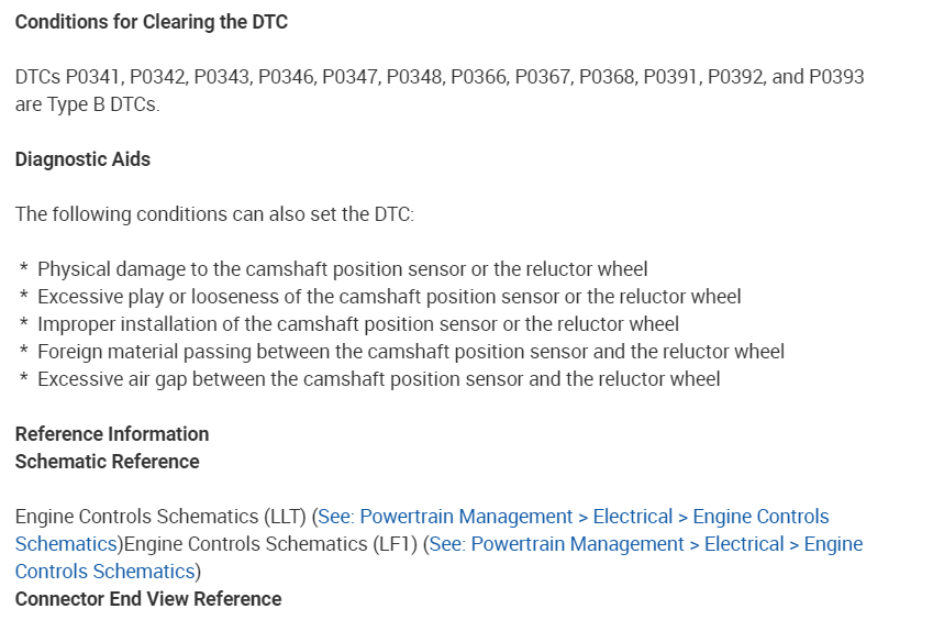

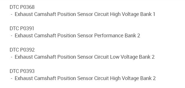

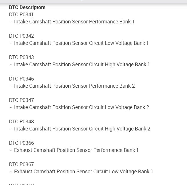

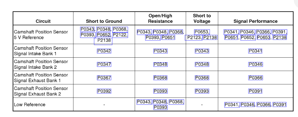

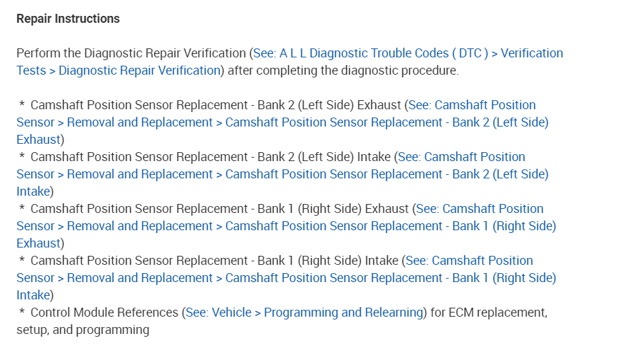

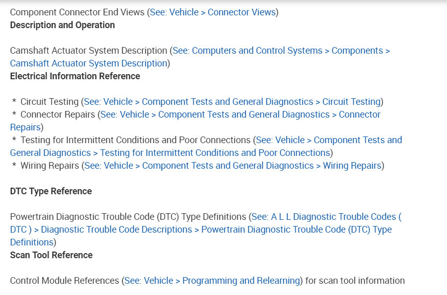

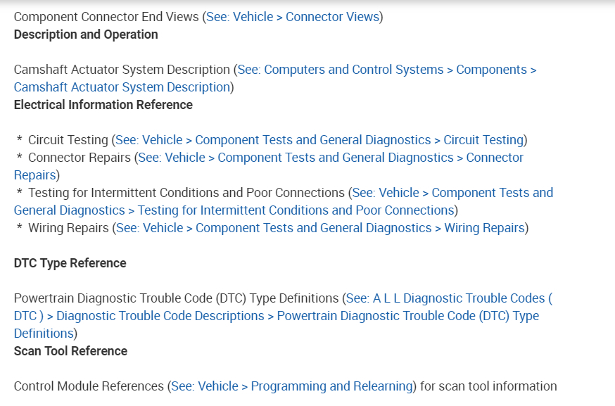

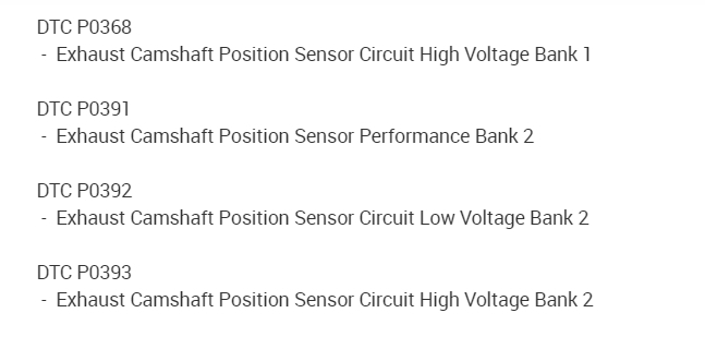

Your vehicle is not in either one of our databases, but the Direct Trouble Code (DTC) P0367 is a generic code, meaning it applies to all vehicle's the have a camshaft actuator made after 1996. DTC's have a letter P=Power-train, B=Body, C=Chassis, U=Information Network, The first number if even(0 or 2) is a Standard of Automotive Excellence(SAE) or generic code which applies to all vehicles, if odd(1 or 3) than it's a manufacturer code, specific to your vehicle. The second number is the system affected, and the last two numbers apply to the subsystem in that system that is affected. So I pulled this DTC troubleshooting from a Cadillac vehicle, but the principal's will be the same. I have included a diagnostic troubleshooting guide in the diagrams down below for you.Please get back to us with what you are able to find out.
Thanks,
Alex
2CarPros
