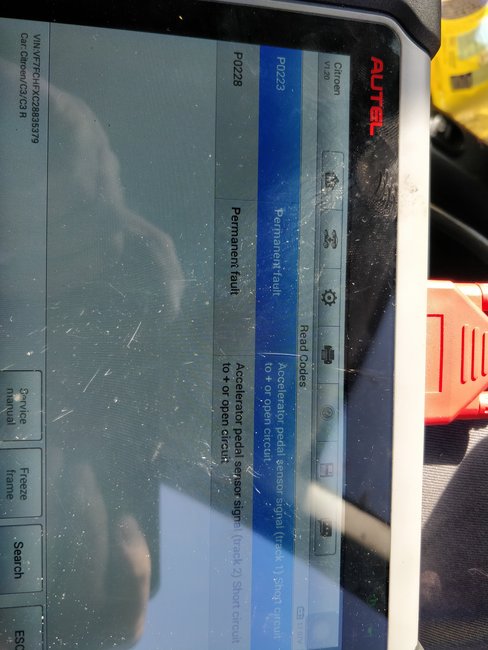

Hi, the car starts fine but when you pres the accelerator pedal nothing is happening. I got this to fault codes stored in the engine .
Sep 18, 2019 at 11:42 PM
B&J

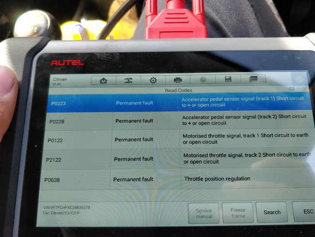

The fault codes.
Sep 18, 2019 at 11:45 PM
This happens when the throttle actuator needs to be serviced. The computer sees the problem and puts the car into limp mode. here is a guide to help you fix it:
