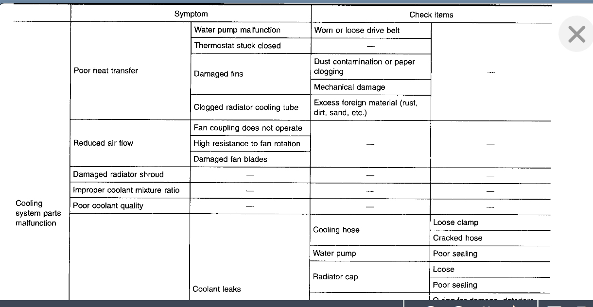

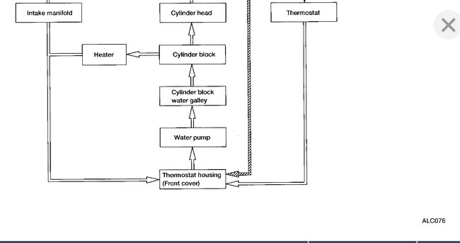

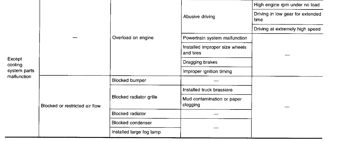

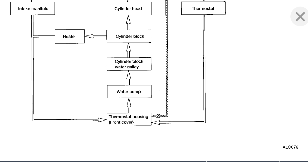

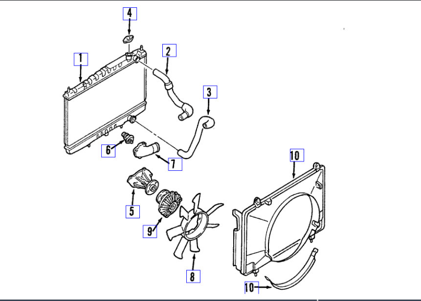

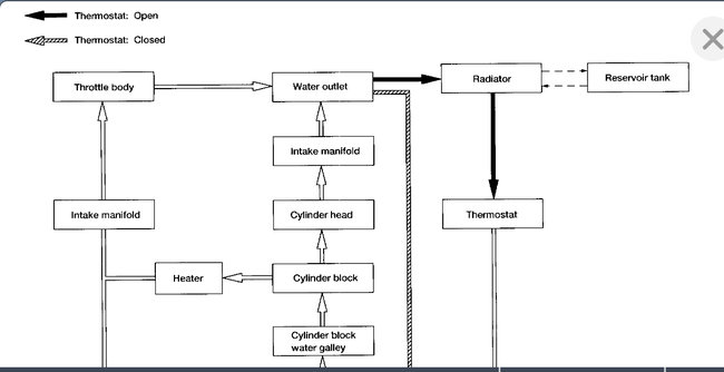

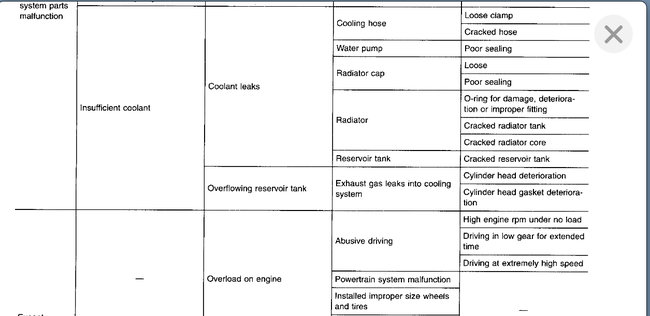

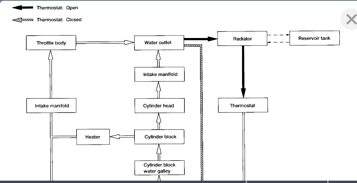

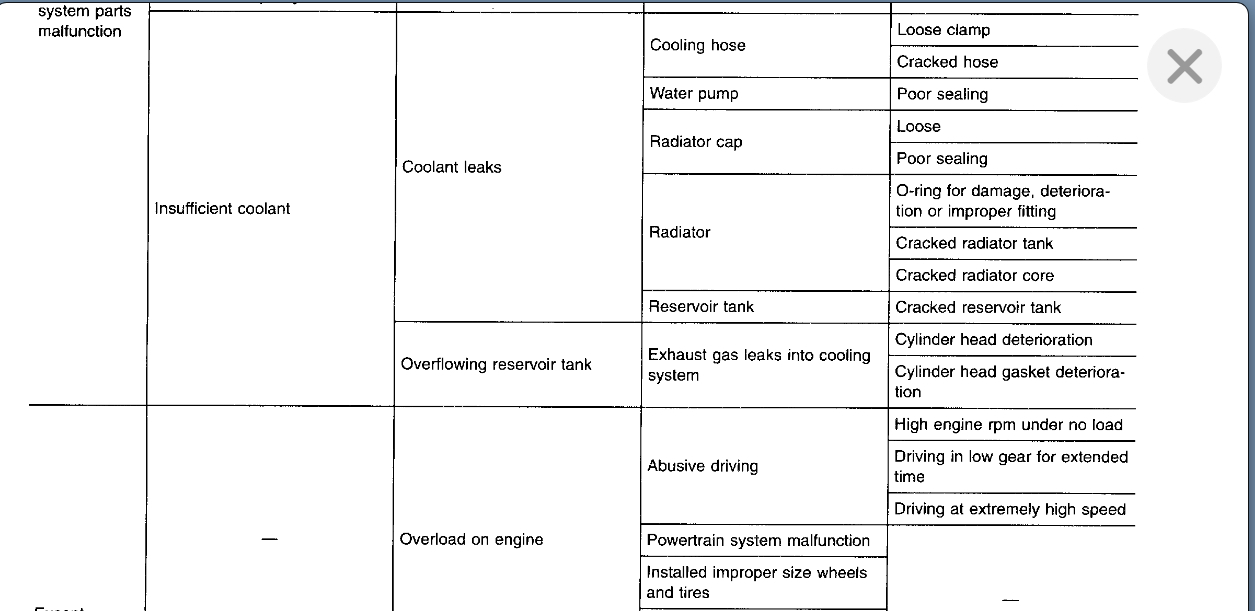

You're right. Cooling systems aren't that complex and are usually easy to figure out. I've double checked to see if there was a Technical Service Bulletin (TSB) or anything out of the ordinary with this cooling system and have nothing special about it. I've included everything that I could find in either of our resources that might be helpful in the diagrams down below. Save that, an air pocket that is impeding coolant flow would be my guess. I hope this information helps.

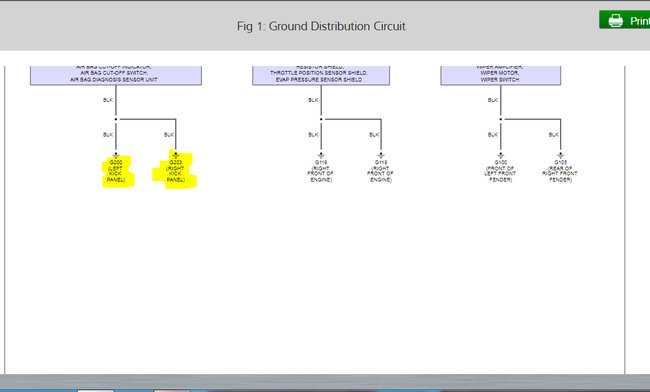

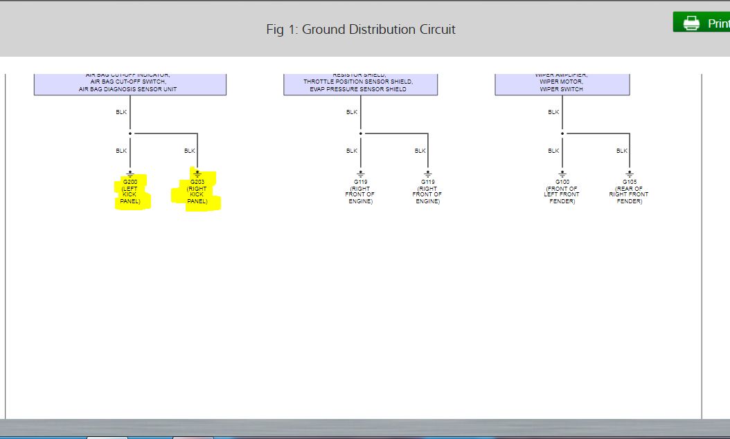

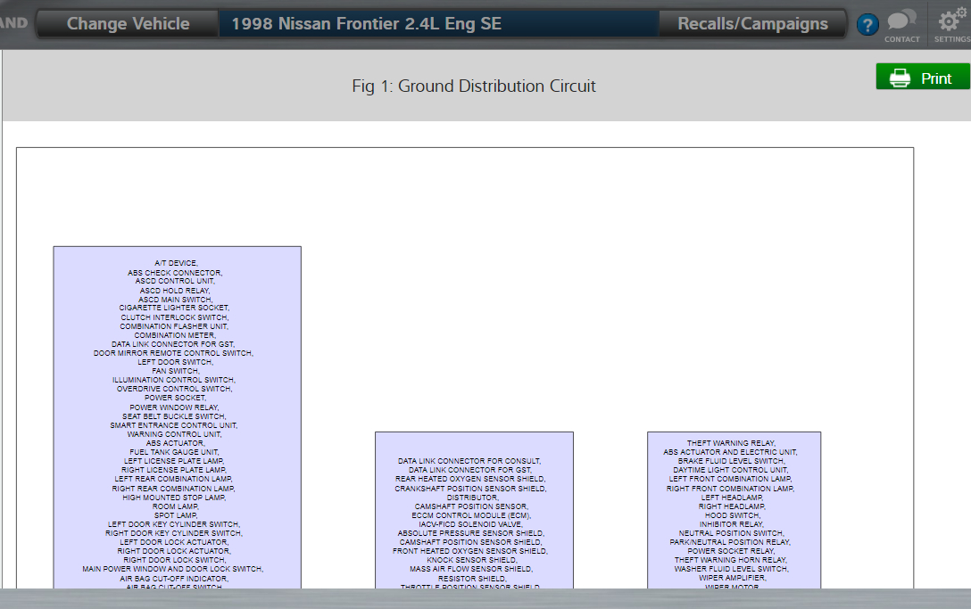

SCGRANTURISMO
  • 4,897 POSTS
Hello again,

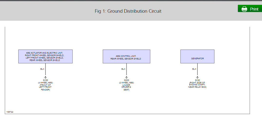

Check out ground #200 and #203. They are by the left and right kick panels respectfully. I have included the ground distribution wiring diagram for your vehicle in the diagrams down below.
