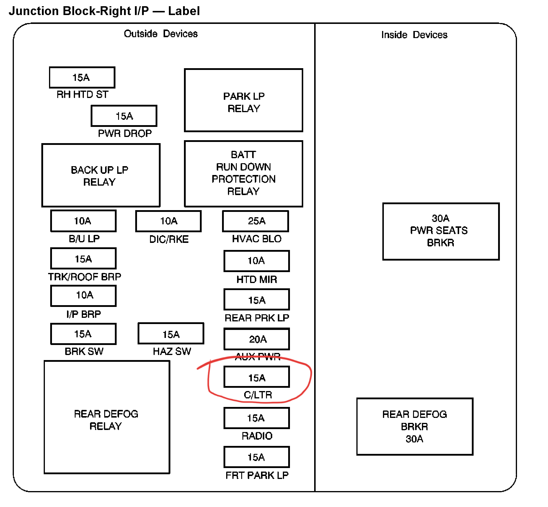

My phone will charge in the rear. I replaced the socket. The fuse is getting power to it. I need answers. Anyone know what the problem is?
Dec 17, 2019 at 9:30 PM
JIS001
CERTIFIED EXPERT
3,412 POSTS

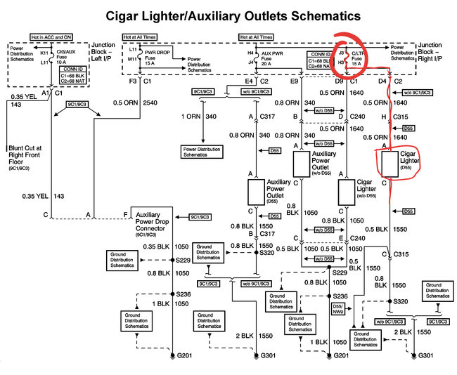

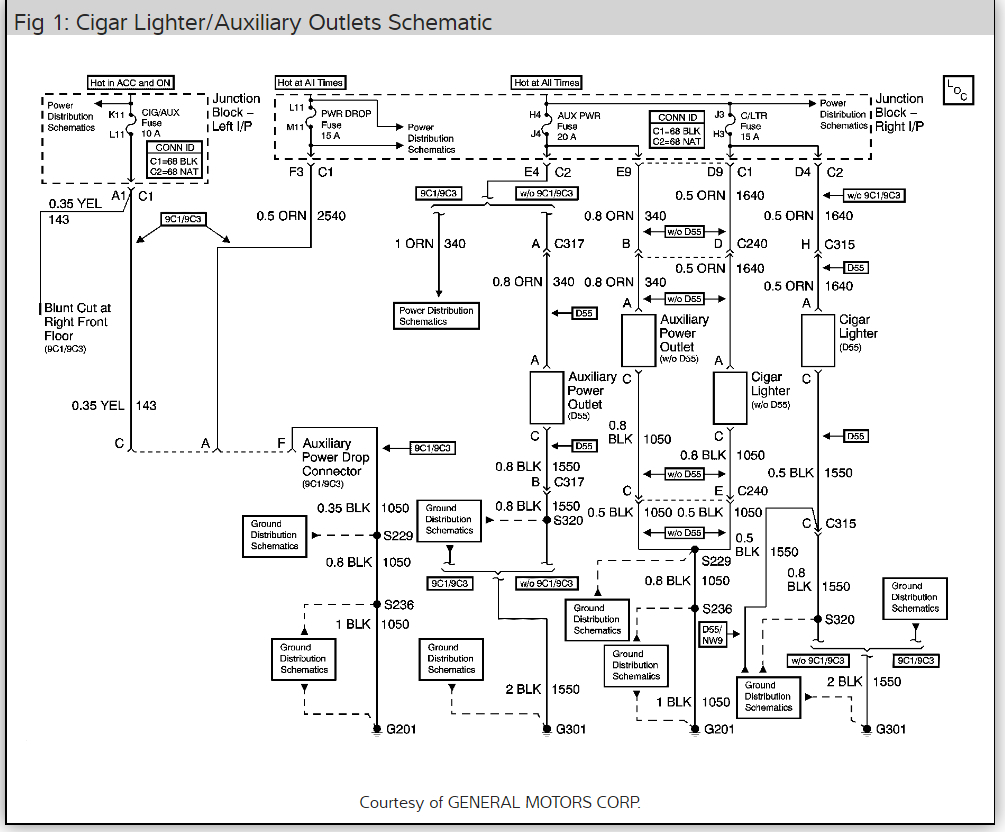

Check your 15 amp fuse on passenger side fuse box. See image below. Check out the diagrams (Below). Please let us know what happens...............................................

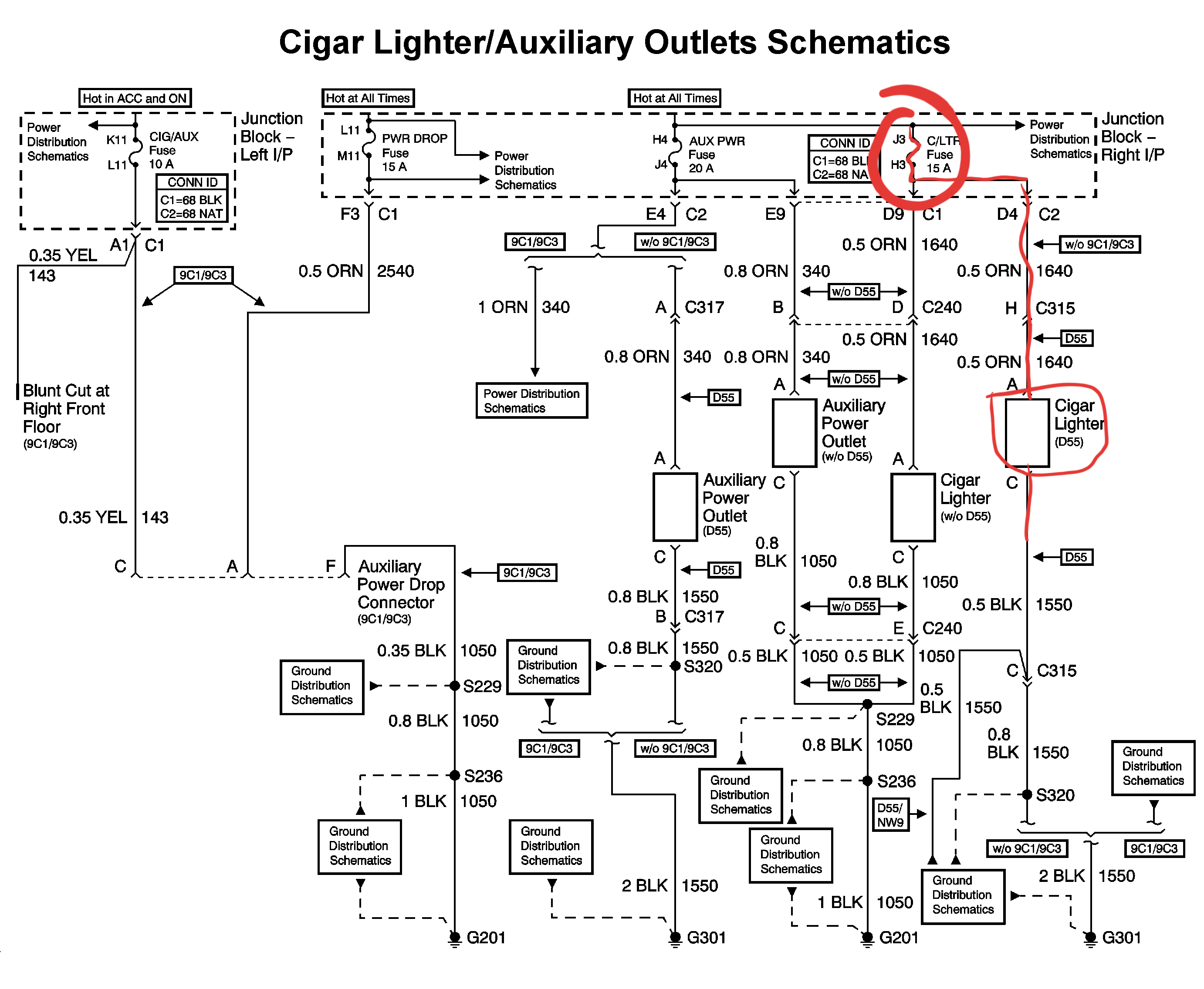

I have checked the fuses for the cigarette lighter and they appear fine, but car phone charger will not work neither will the cigarette lighter.

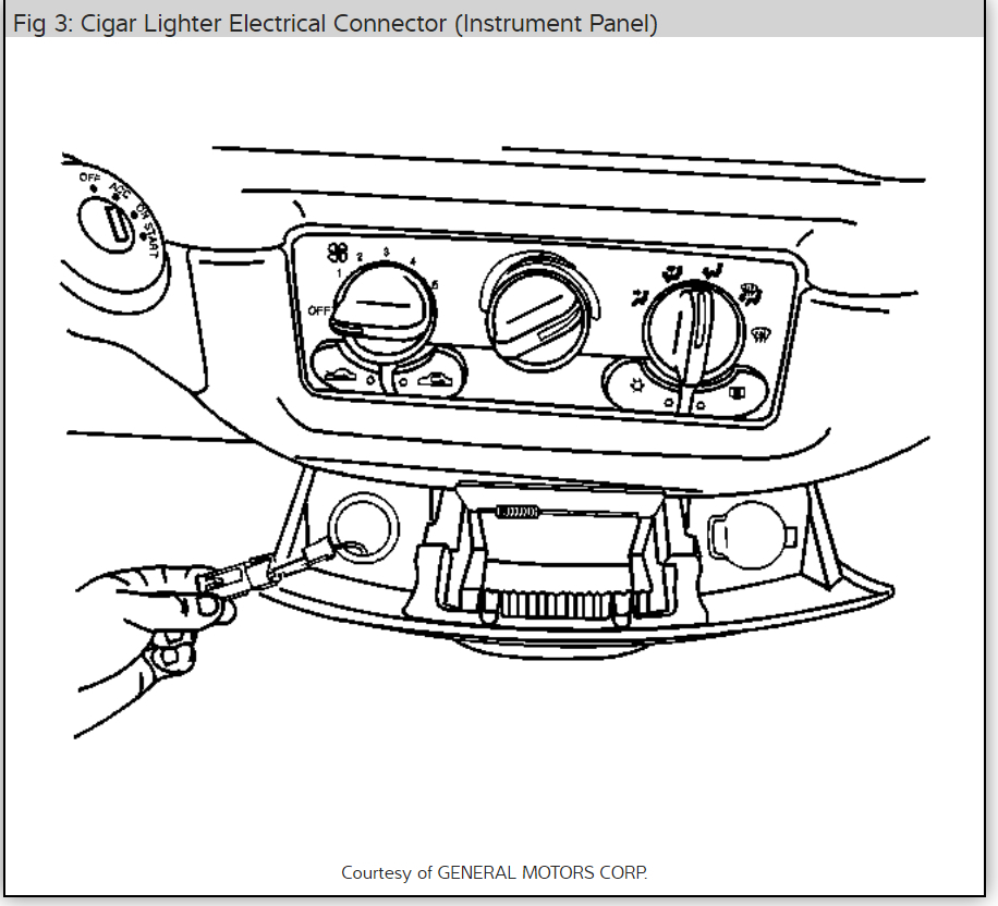

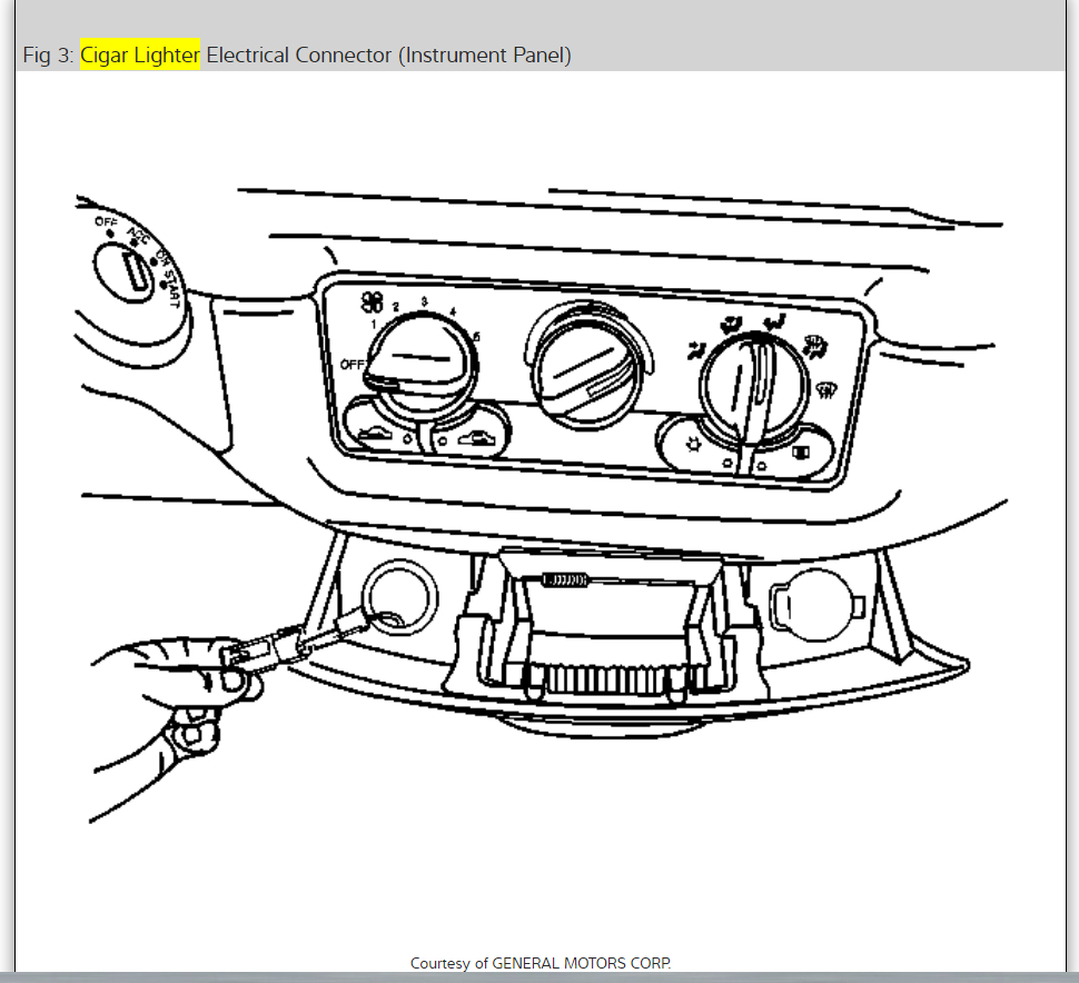

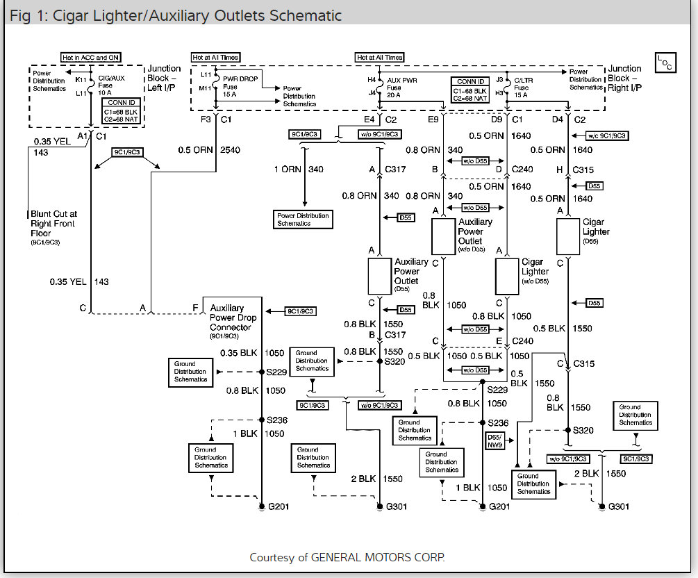

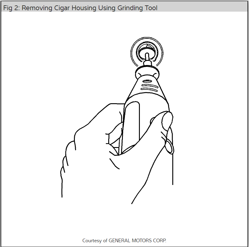

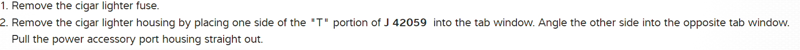

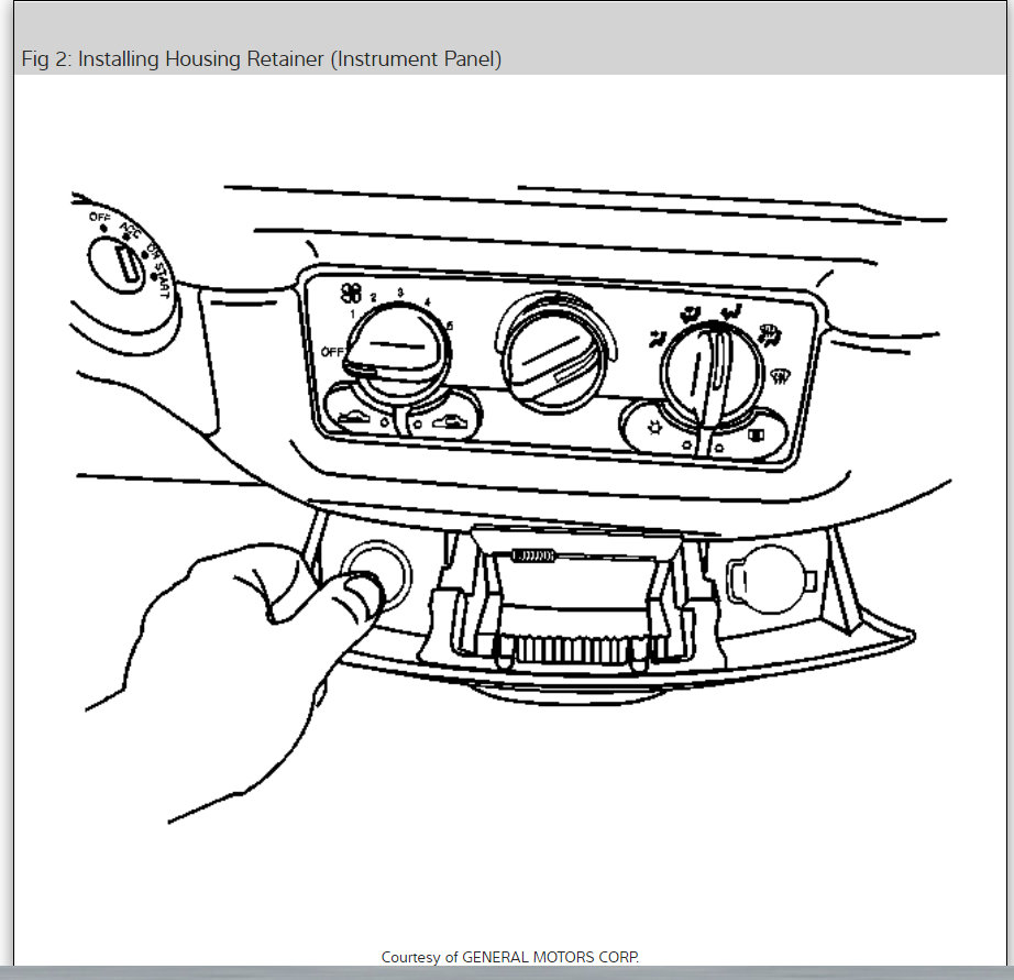

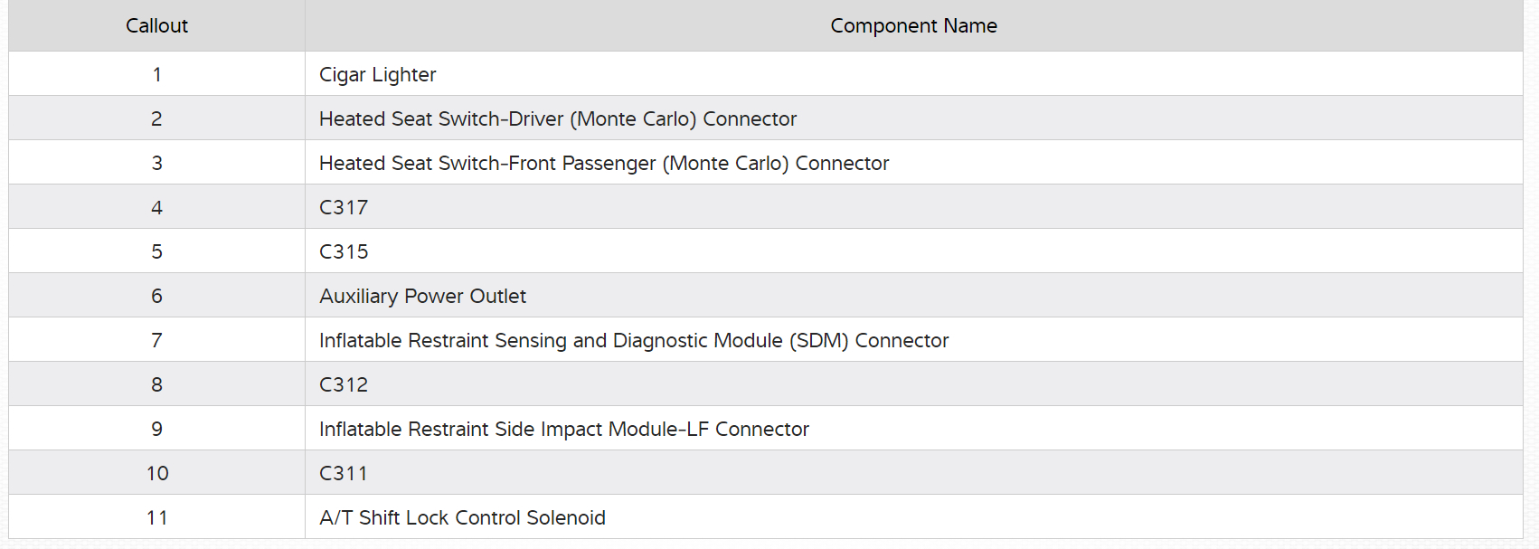

Hi Beyondforever5, my name is Alex and I will be helping you today.

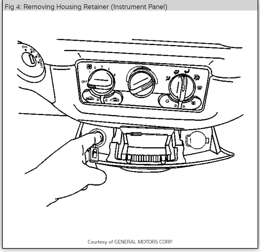

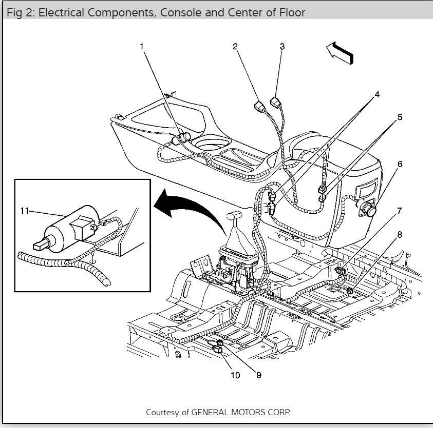

I have included wiring diagrams, component diagrams, and step by step instructions on how to remove your cigarette lighter socket/power socket. I will send another message with the step by step installation instructions in a couple of minutes. Thank you for using 2CarPros, Alex.
Dec 7, 2020 at 8:20 AM
(Merged)
SCGRANTURISMO
CERTIFIED EXPERT
4,897 POSTS

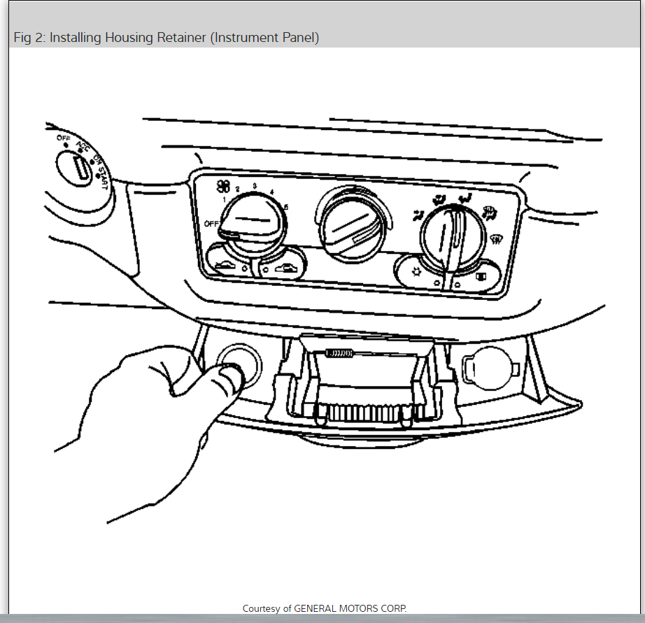

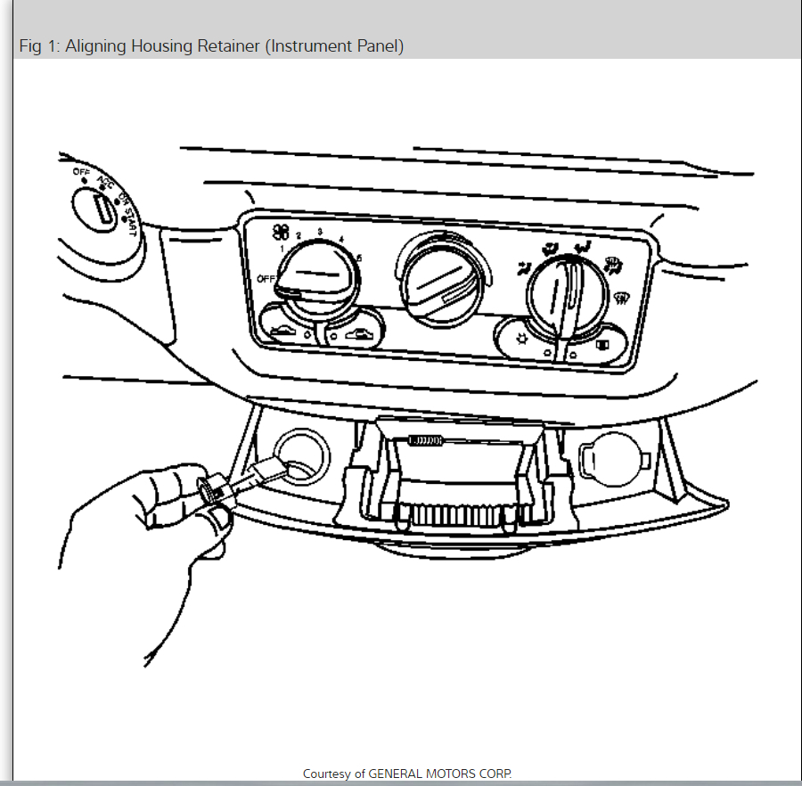

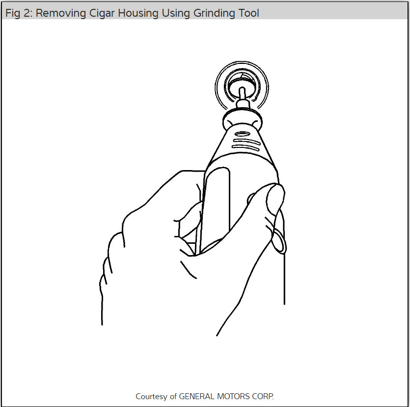

Hi again beyondfeorever5, sorry for taking so long with the installation procedures, but here they are as promised. Thank you, Alex.

The cigaretter lighter has no power to it,even when i used a test light. The fuse is fine but,it has no power what so ever.
Dec 7, 2020 at 8:21 AM
(Merged)
RENAUDTN
CERTIFIED EXPERT
636 POSTS
Check for power throughout the circuit: relay, circuit breaker, connector etc.
Work your way back from the cigarette lighter until you find voltage. Once you find voltage, you'll know that's the defective component.
