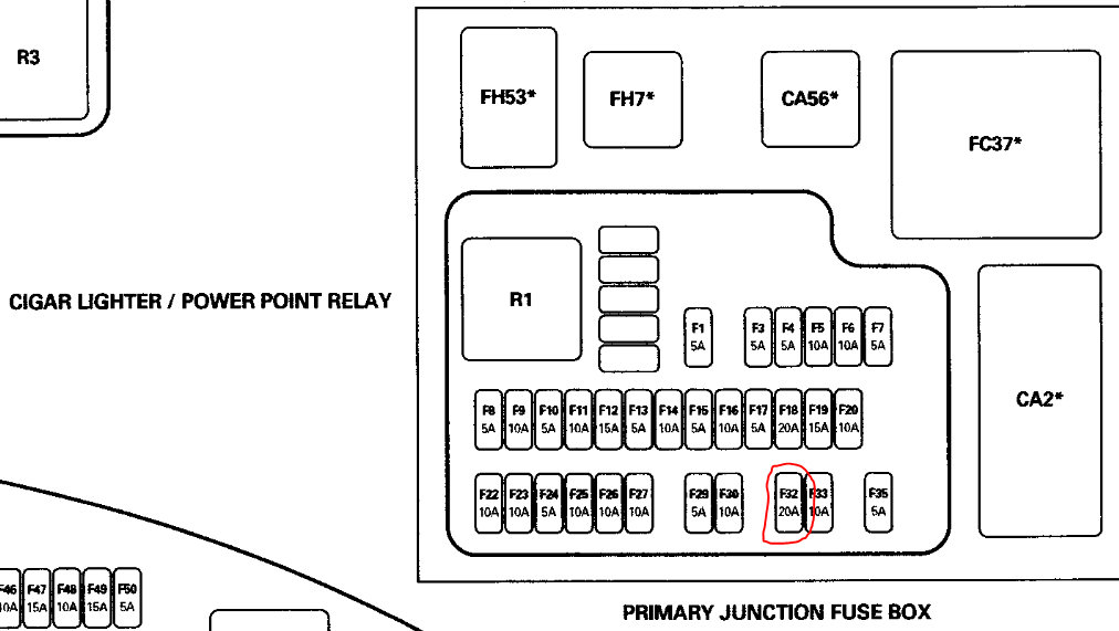

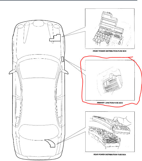

Cigarette lighter fuse blew out
2003 JAGUAR S-TYPE
120,000 MILES • 3.0L • 6 CYL • 2WD • AUTOMATIC
DELICATE GUEST
Where is the fuse located so I can replace it?
Dec 17, 2019 at 2:49 AM
DANNY L
  • 5,648 POSTS
Hello, I'm Danny.
It is located in the passenger side fuse bow. The fuse is a yellow 20 amp fuse and located in position #32. I've attached pictures below and circled in red on the locations for your vehicle.Hope this helps and thanks for using 2CarPros.
