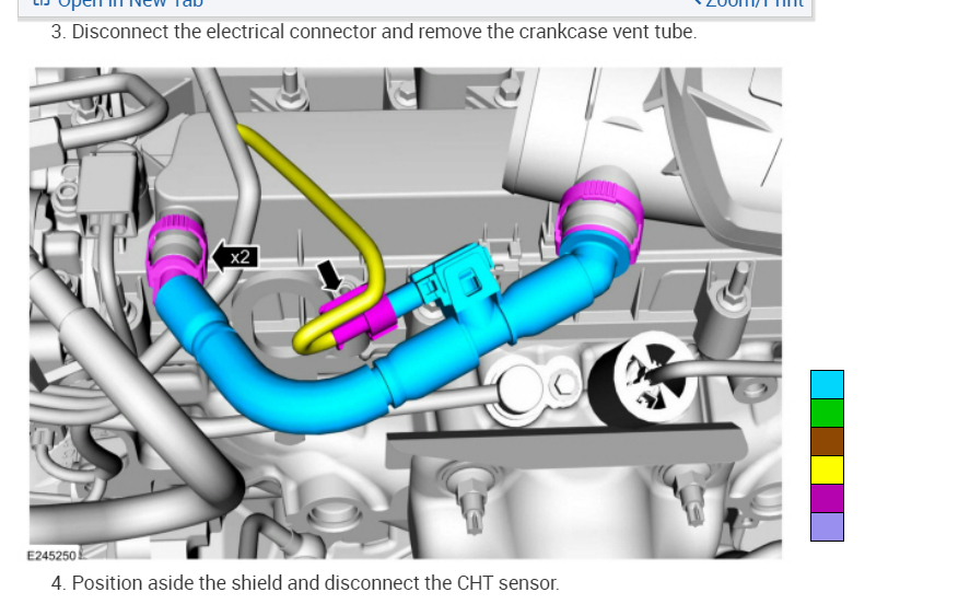

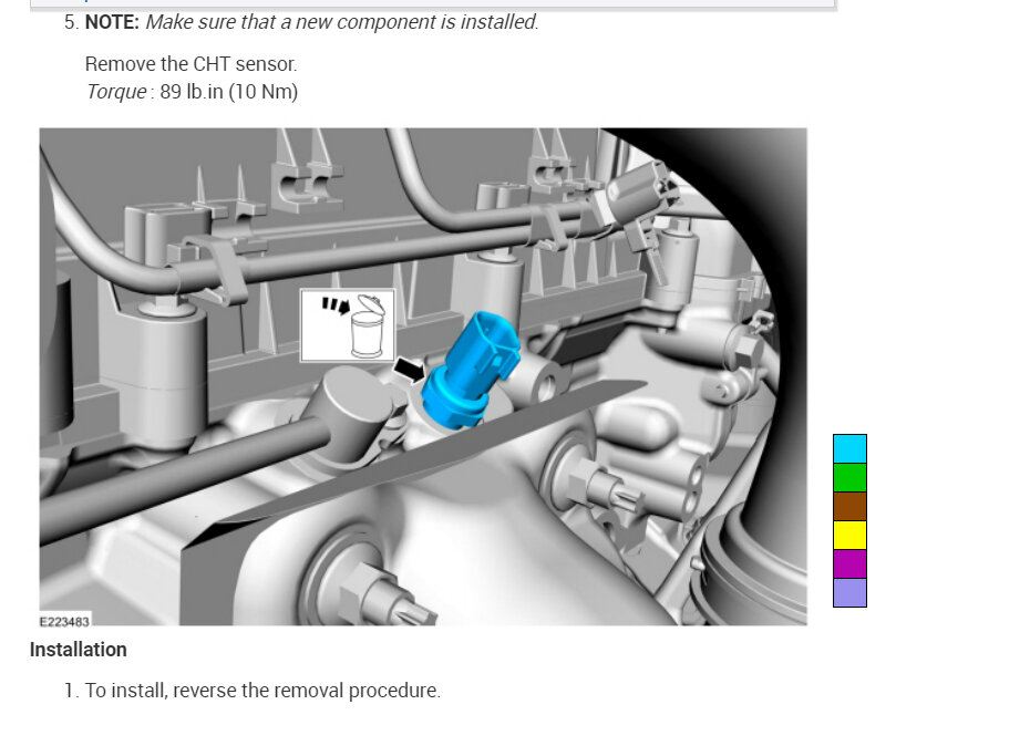

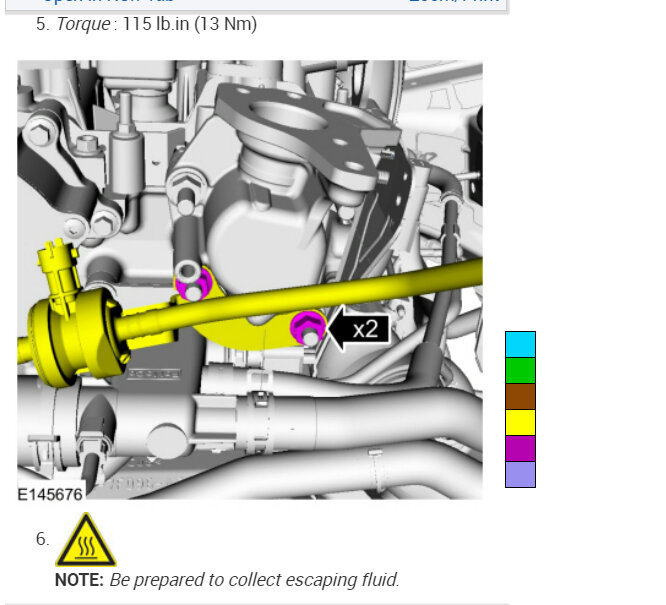

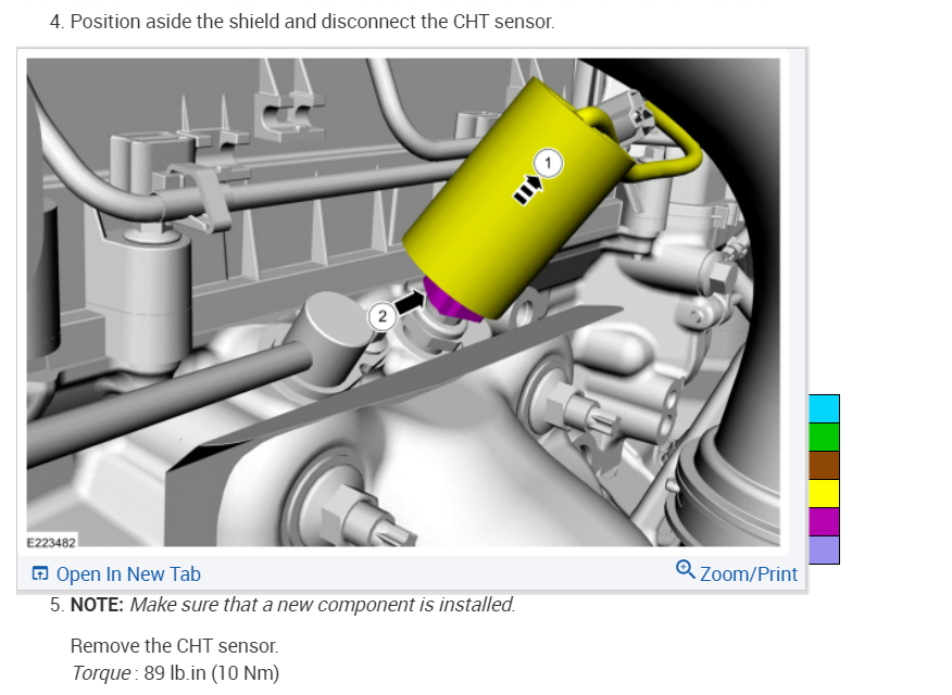

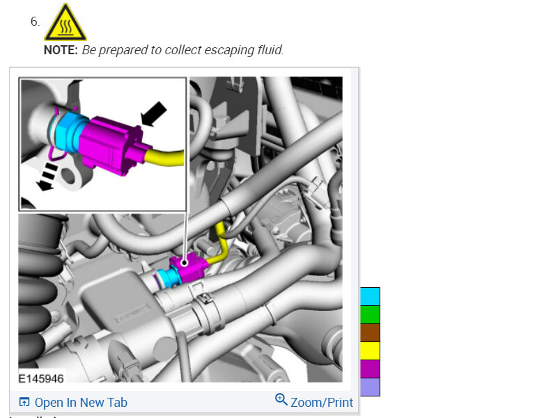

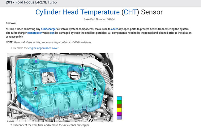

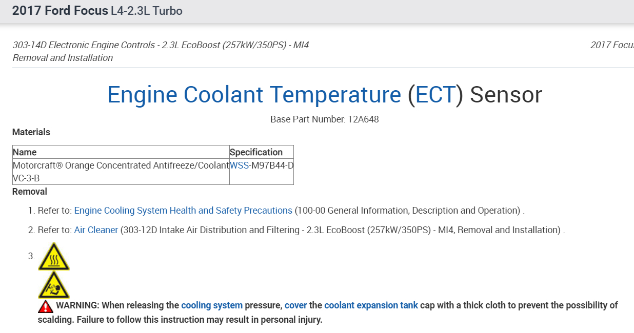

What code is it? I need the number please. There are two temperature sensors.
1. CHT - Cylinder head temperature sensor.
2. ECT - Coolant temperature sensor.
Here are the locations of both. Check out the images (below). Let us know what happens and please upload pictures or videos of the problem so we can see what's going on.
