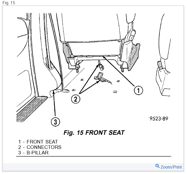

Regardless, You'll need to remove the bolts that hold down the seat track. Once off pull the whole unit out and flip it over. The track then needs to be removed from the bottom of the seat. At this point you should be able see what retains the seat and back rest. You may be able to see this without removing the seat however. I don't have one in front of me, but I would be willing to try to help if you want to post some pictures
of the seat. I would think at the point of where they hinge may help.
