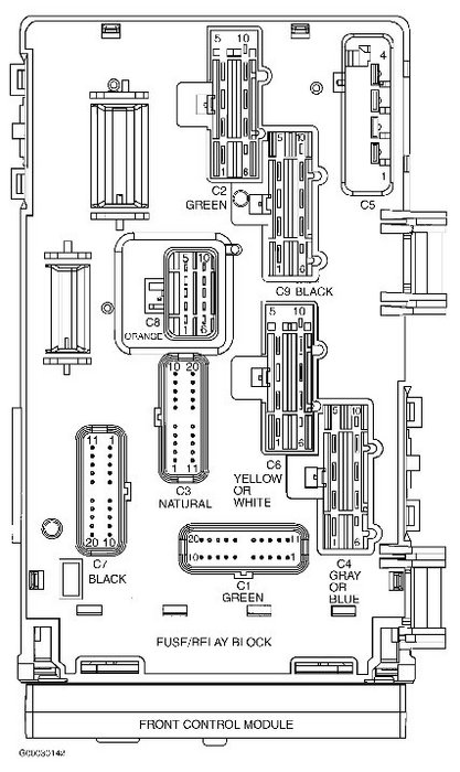

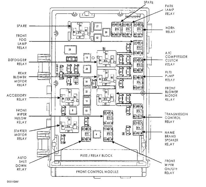

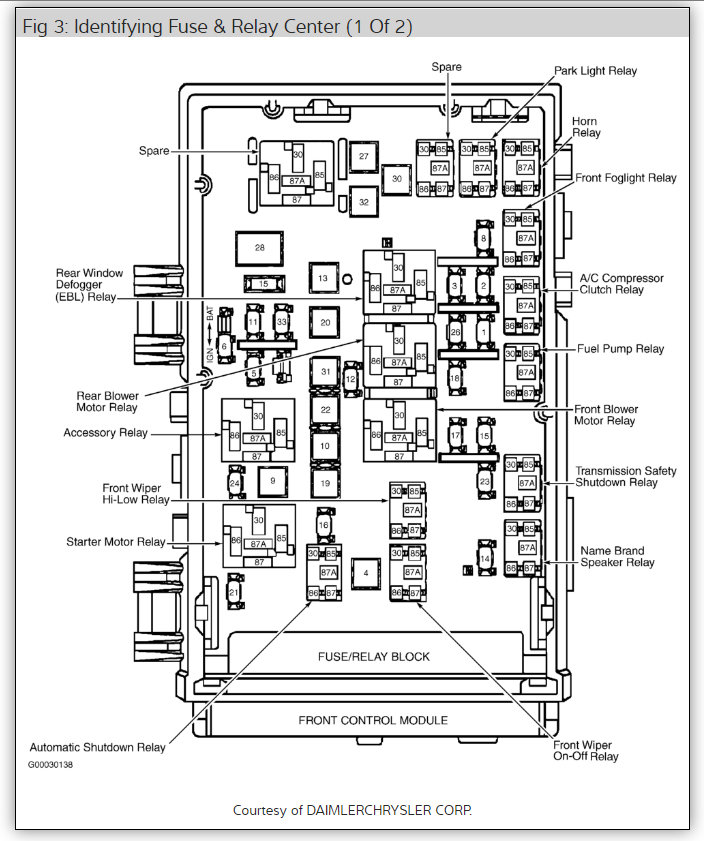

* upon trying to crank the van I get a fast clicking noise that seems to be comming from the ASD relay in the fuse panel. Weirdly enough it still clicks after pulling the key out of the ignition, I have to remove the negative batt cable to stop it. rechecked all my connections, everything is solidly in place and where it should be. Tried reconnecting the old wires/coil pack because at least then I could start the van, but now I have the same problem with that setup. As far as I can tell, the system isnt even going as far as the coil pack because I get the same clicking noise with no harness connected to the coil pack.
I am at a loss, dont have a ton of money to dump it off at a dealership or somthing to fix a major electrical problem so I figured I'd check here first to see if anyone has any idea what ive screwed up???
