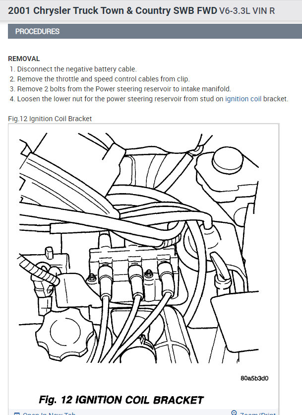

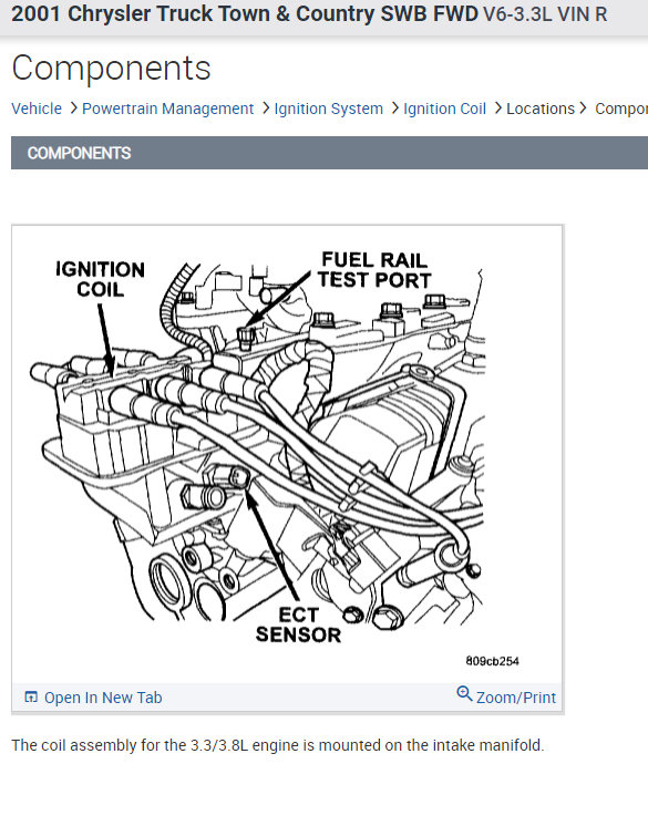

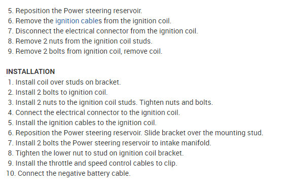

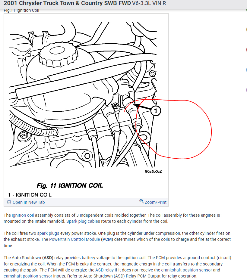

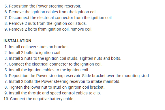

On this vehicle you will have to remove those 2 bolts for the power steering reservoir and move it out of the way, then you will be able to access the ignition coil.
Be sure to disconnect the negative battery cable before getting started.
I have attached replacement diagrams for your reference.
Thank you.
