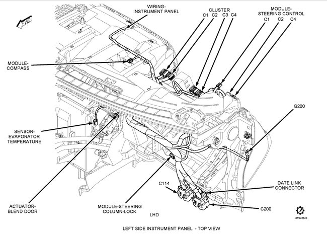

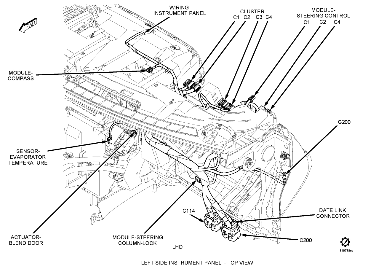

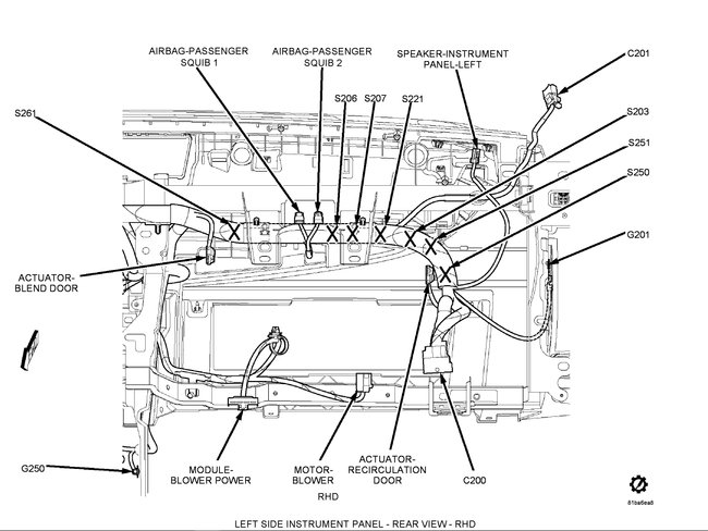

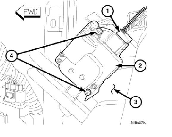

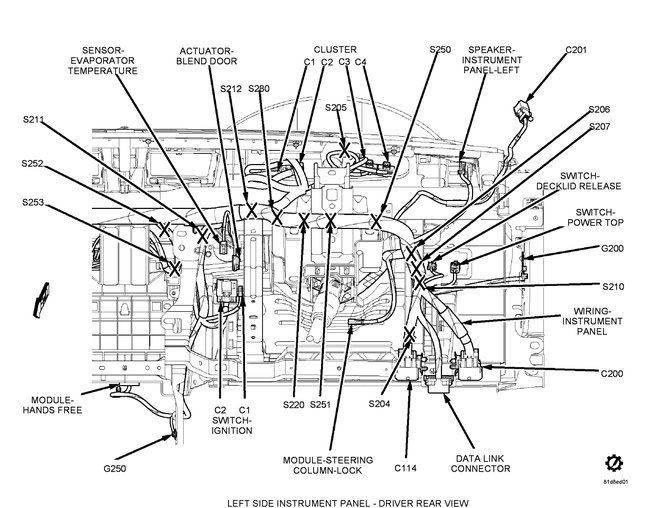

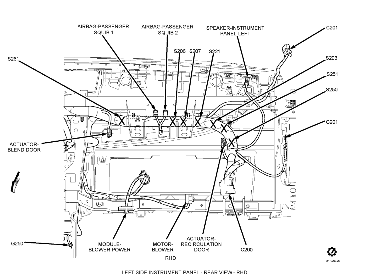

It sounds like you have two seperate problem let's address the heat issue which sounds like a temperature blend door actuator that is out and needs to be replaced. Here is a guide to help you see what i am talking about.
and
https://www.2carpros.com/articles/car-heater-not-working
And here is where it is at on your car (below)
