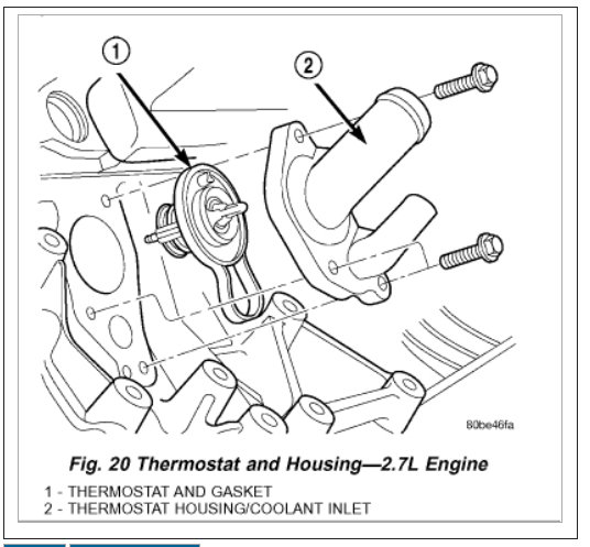

I don't know where the thermostat is located and i've never replaced one but friends tell me it's easy.
Can you help
Nov 1, 2009 at 11:06 AM

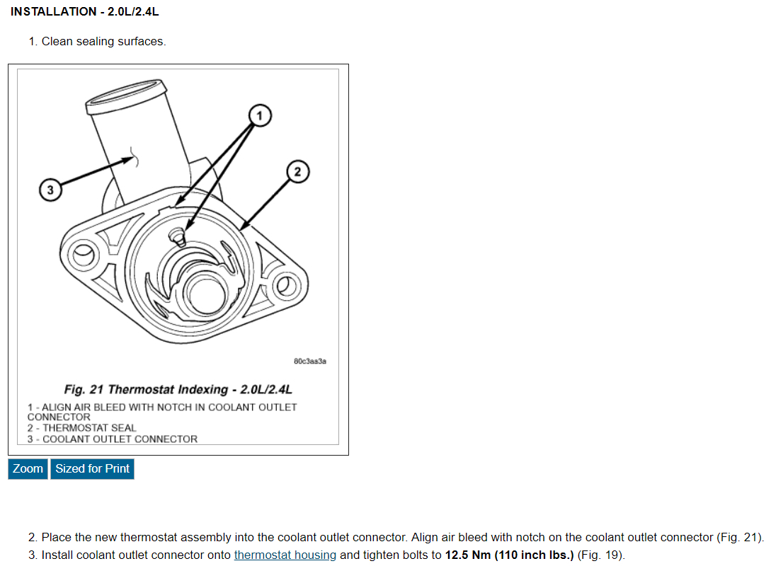

Yes it is easy here is a guide to help you see what you are in for when doing the job. Here is a guide to help you step by step with instructions in the diagrams below to show you how on your car.
Here is how on your car i have included both engine in case someone needs it.
