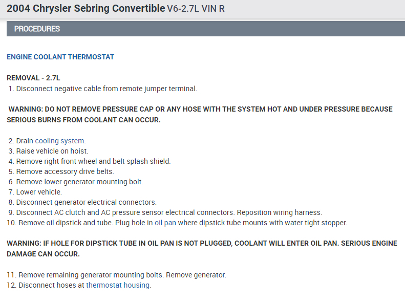

The thermostat replacement on this vehicle will require removal of the belt and the alternator to create proper access to the thermostat housing.
You might have to take off the right wheel to have easier access to the components.
After you have access to the housing you will just have to take off those 3 bolts that is around the thermostat housing to get it out.
This can be done using simple hand tools

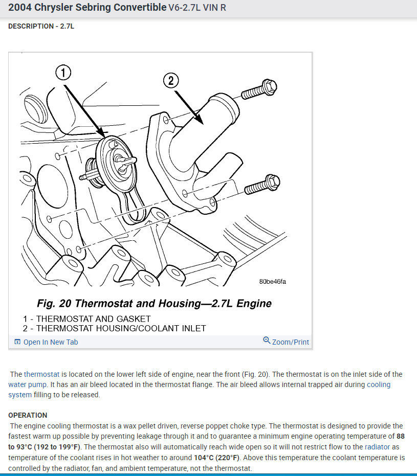

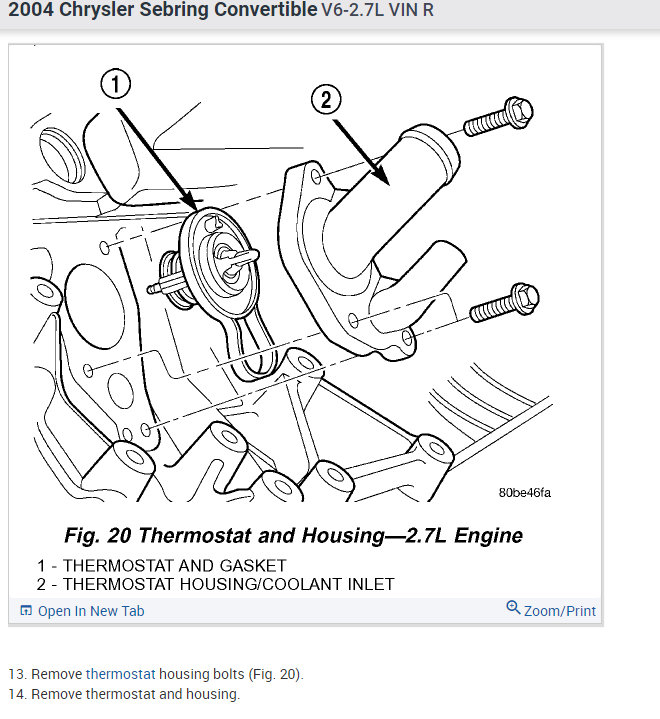

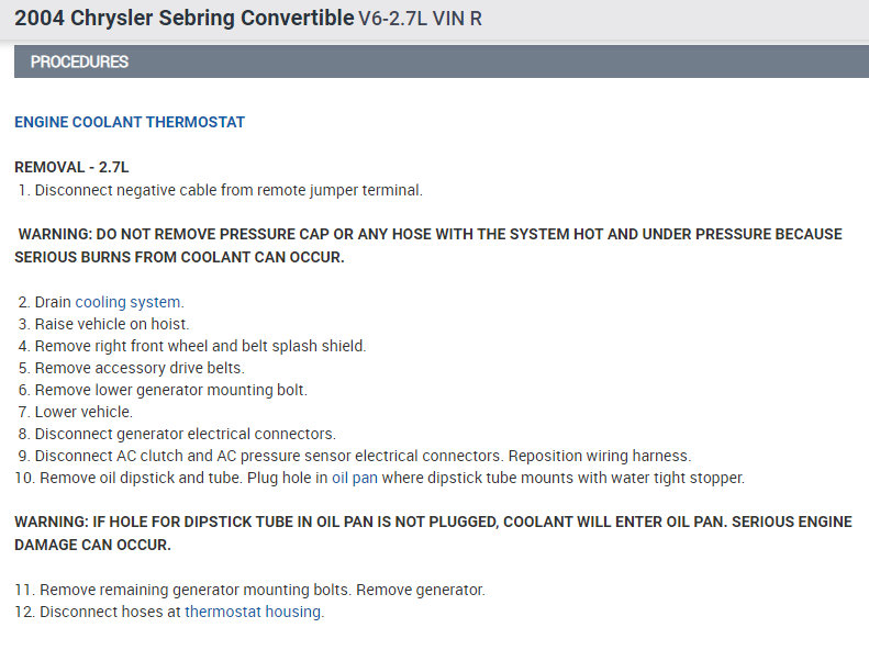

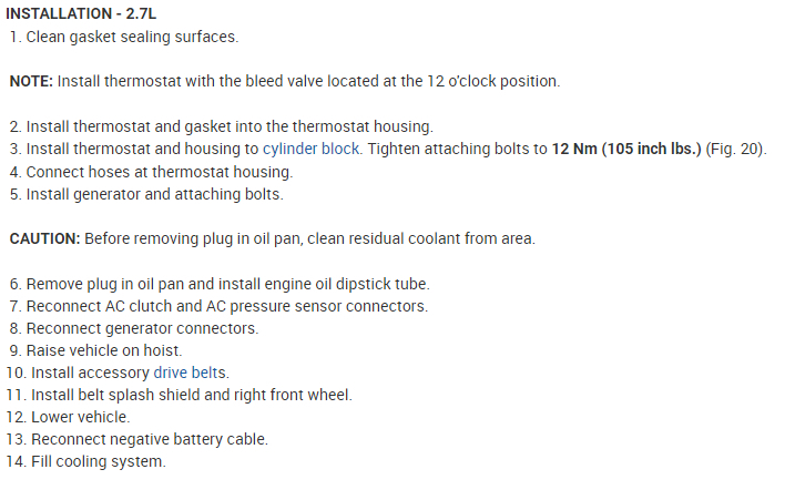

I have attached the diagrams for your reference.
