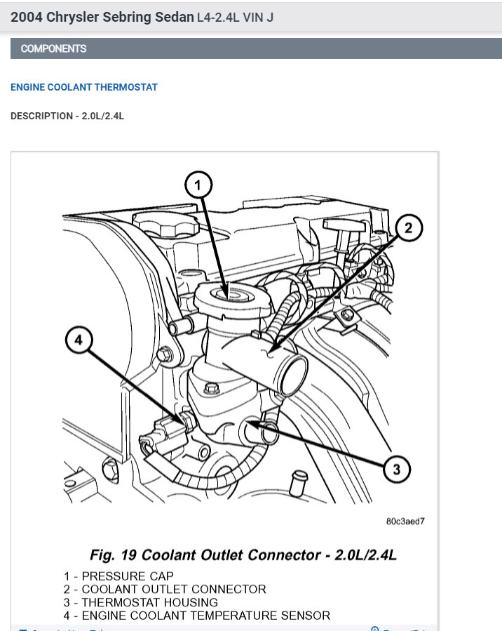

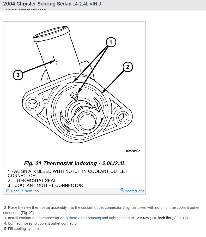

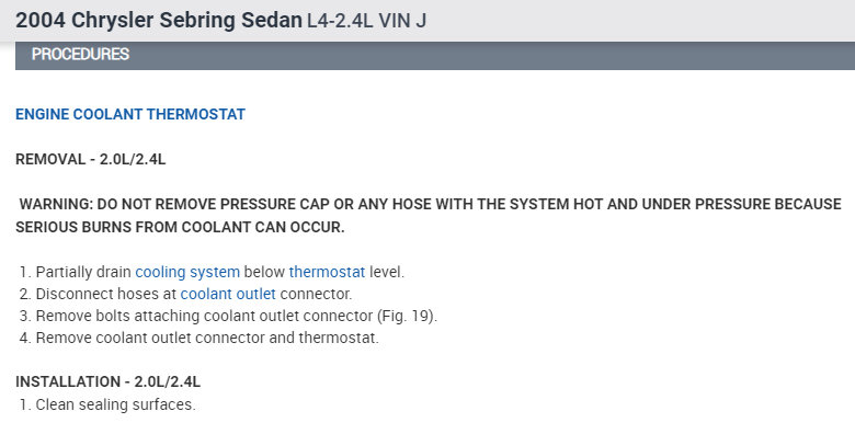

A stuck closed thermostat can also lead to overheating and poor heater performance. I know you said it was replaced, but it is possible to have a defective thermostat that failed prematurely.
Since the check engine light is illuminated, it will be a good idea to scan the retrieve the code(s). It may or may not be related to overheating.
