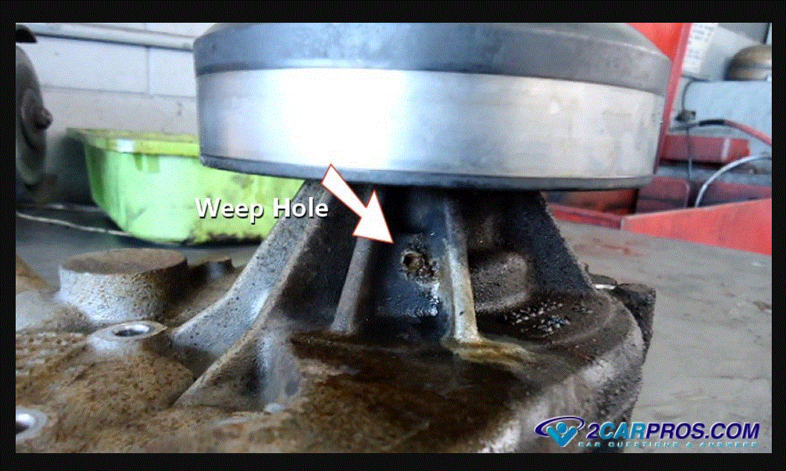

To answer a specific question you asked, the pump does not need to make noise to be bad. It can, but often times it will develop a leak through what is called a weep hole. See pic 1
Here is a link that you may find of interest and helpful. It discusses common symptoms of a bad water pump.
https://www.2carpros.com/articles/symptoms-of-a-bad-water-pump
