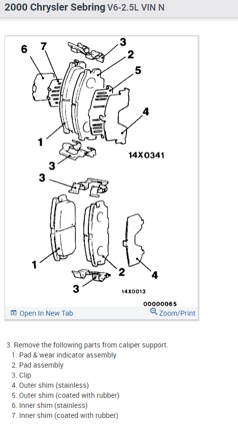

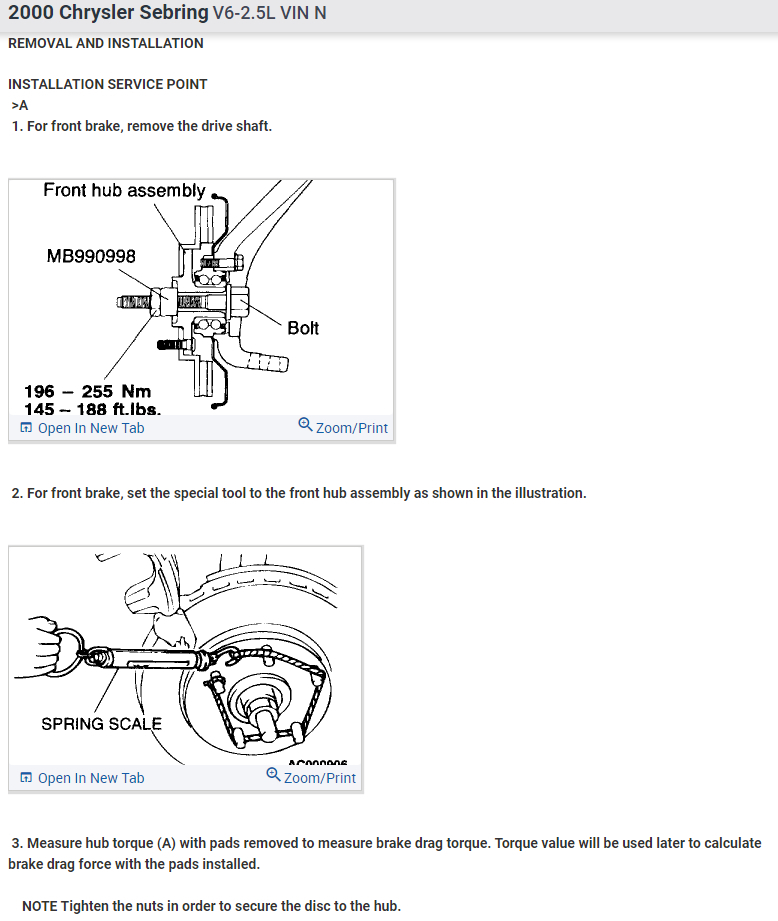

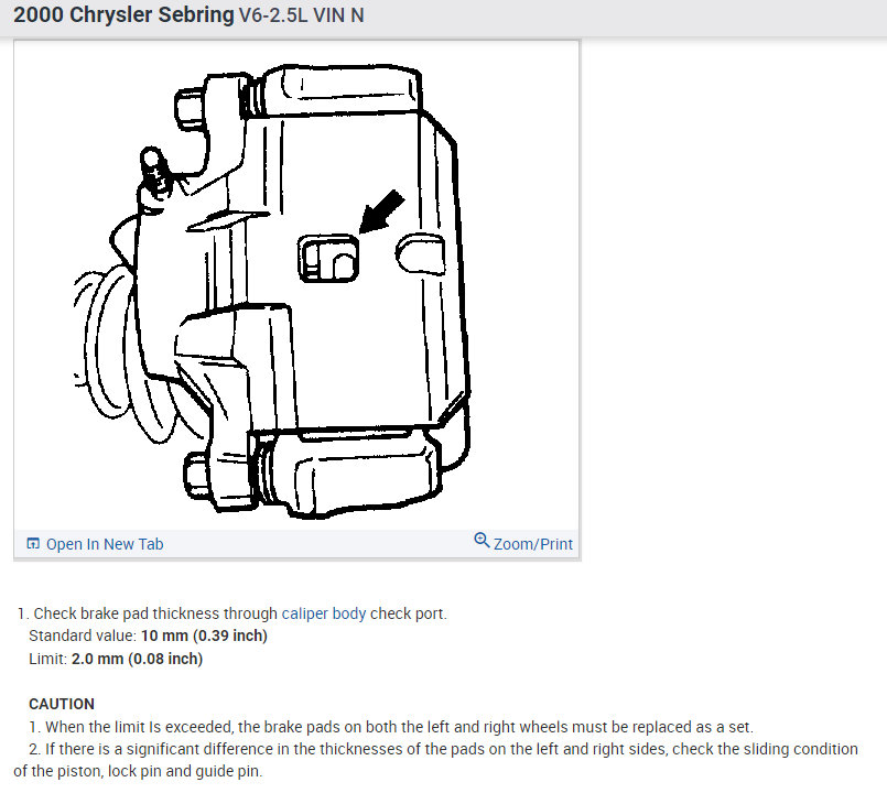

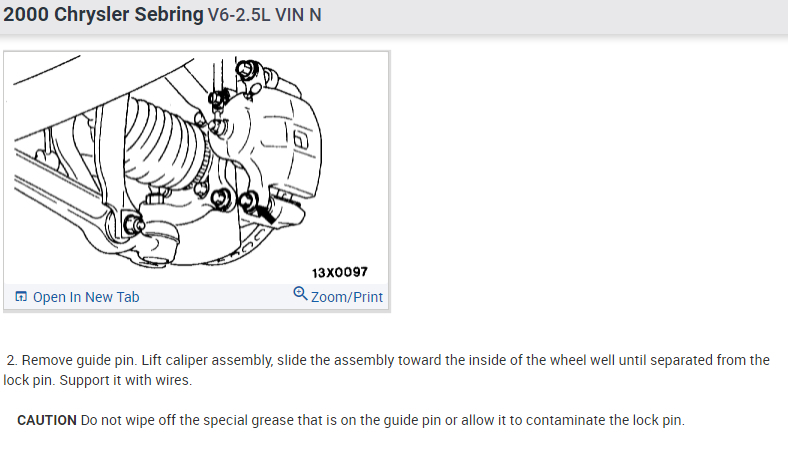

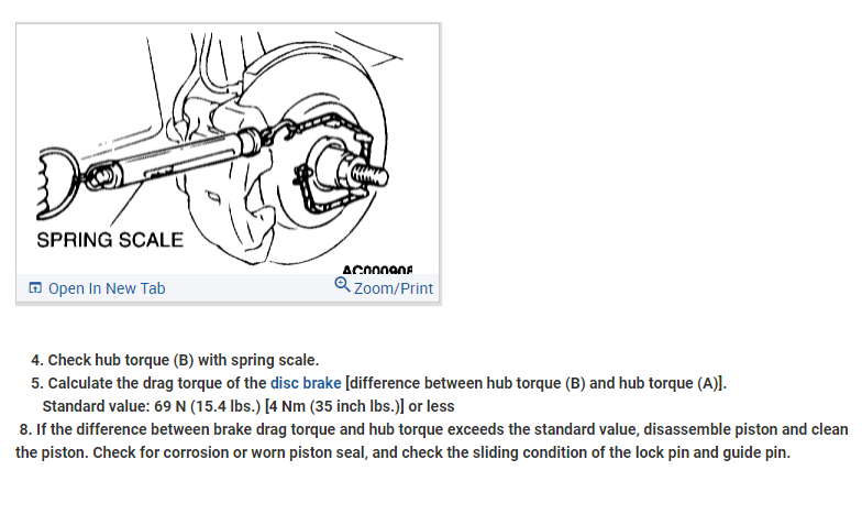

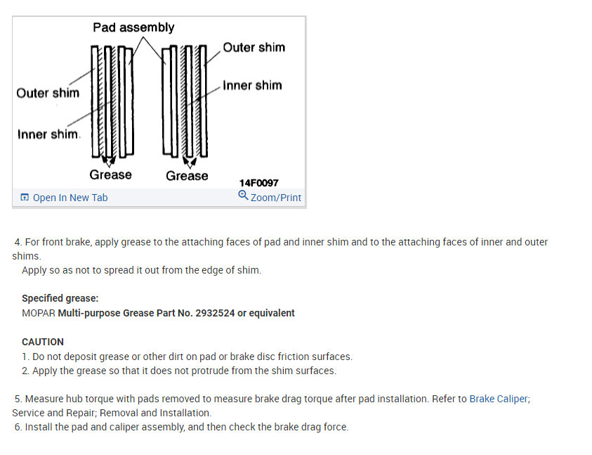

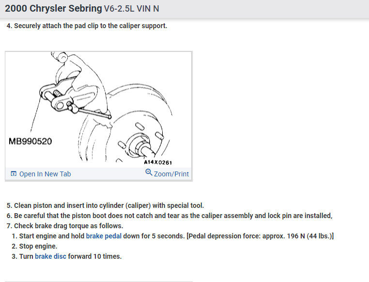

SQM
  • 6,383 POSTS
Here are some helpful articles on brake pads and rotors replacement:
https://www.2carpros.com/articles/how-to-replace-rear-brake-pads-and-rotors

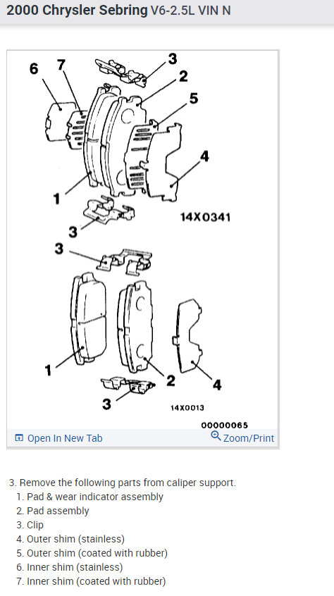

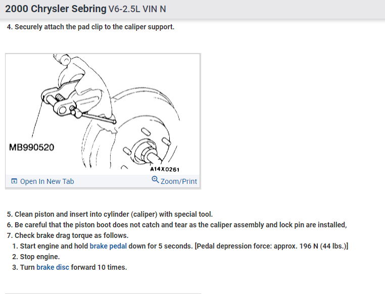

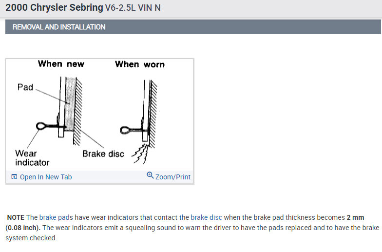

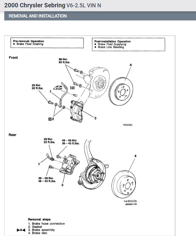

I have attached the brake pads and rotors replacement procedures below.
Any questions please let me know.
Thank you.
