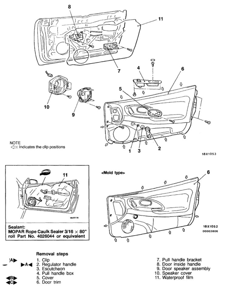

It sounds like you have a drivers door latch that is no good which will cause the alarm to arm itself and then get locked up. There is a micro switch inside the latch that goes bad.
Here is a diagram to show you what you are in for when fixing the problem.
Please let us know what you find.

You nailed it me friend I got the part for $58.00 and installed it now the car works great!.. I love this site and for free, how refreshing.
