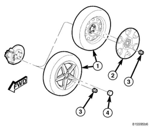

pic 1
2. Remove the wheel mounting nuts (3), then the tire and wheel assembly (1).

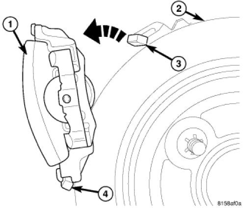

pic 2
3. Remove the two caliper guide pin bolts (4).

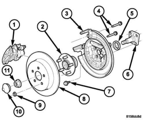

pic 3
4. Remove the caliper assembly (1) from the brake adapter by first rotating the top of the caliper away from the rotor (2), and then lifting the caliper assembly off the lower machined abutment (4) on the adapter.
5. Hang the brake caliper from rear strut using wire or cord to prevent the weight of the caliper from damaging the brake hose.

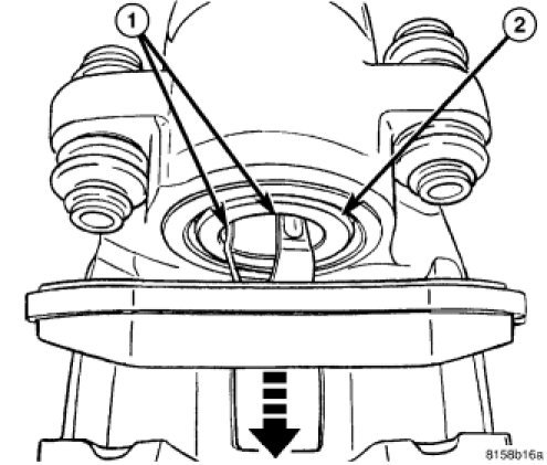

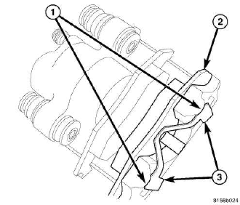

pic 4
6. Remove the outboard brake pad from the caliper by prying the brake pad retaining clip (3) over the raised area on the caliper (1). Slide the brake pad off of the brake caliper.

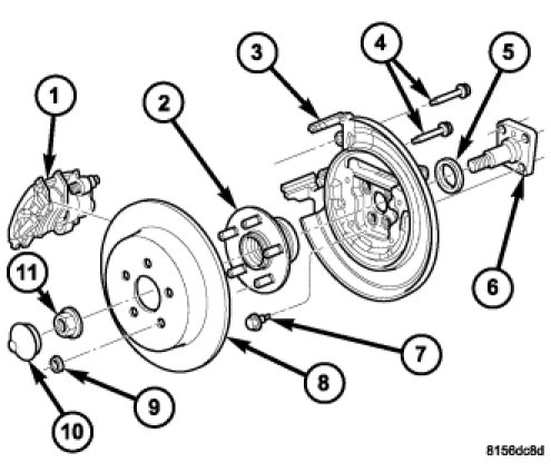

pic 5
7. Pull the inboard brake pad away from caliper piston until the retaining clip (1) is free from the cavity in the piston (2). Remove the pad.

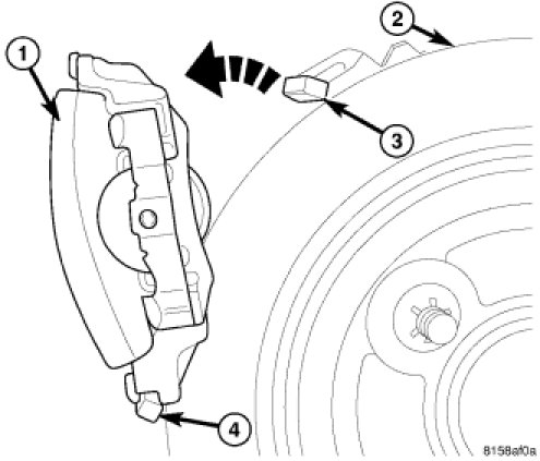

pic 6
