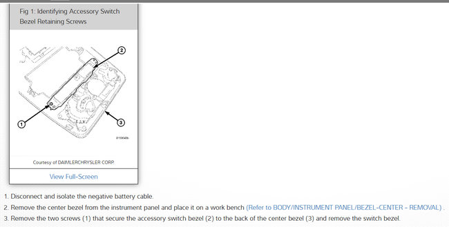

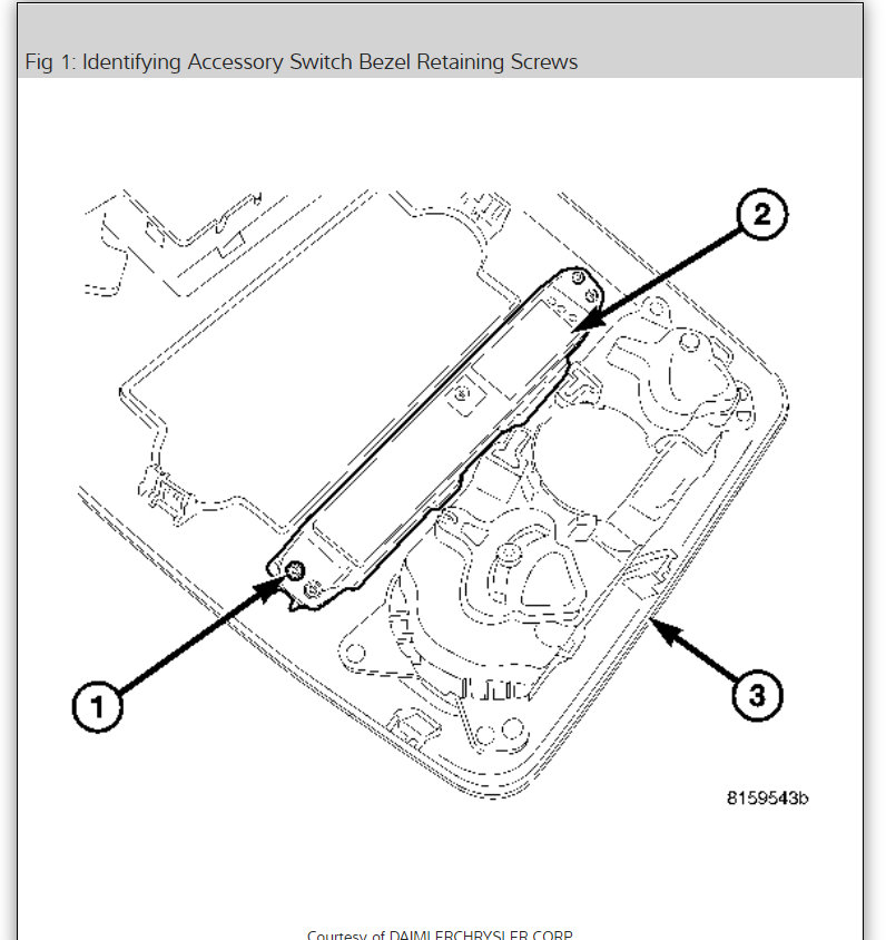

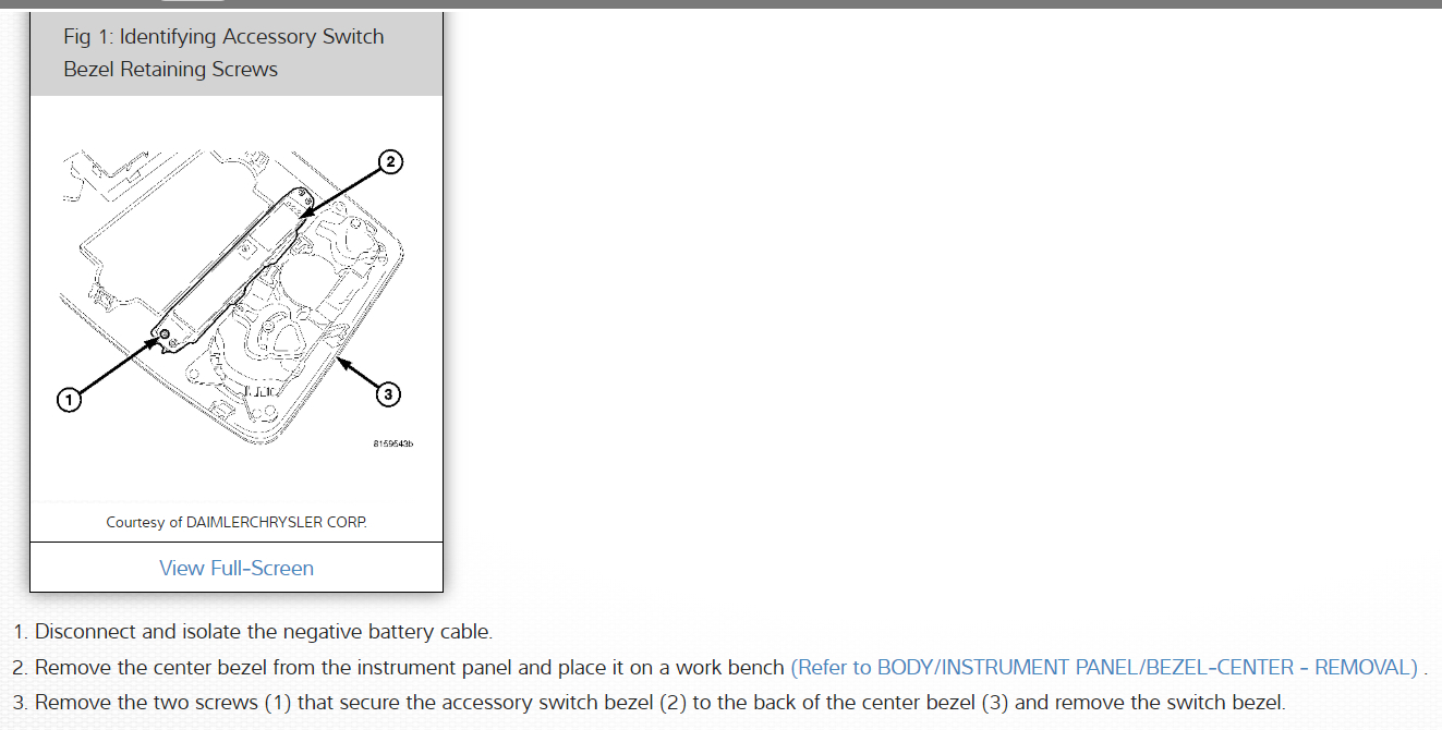

Here is a guide on how to change a seat switch with diagrams and instruction below to help you change it out on your car.
https://www.2carpros.com/articles/seat-position-switch-replacement
REMOVAL
Disconnect and isolate the battery negative cable.
Remove two screws to left cushion side shield.
Disconnect wiring from switch.
Remove attaching screws and switch from bezel.
