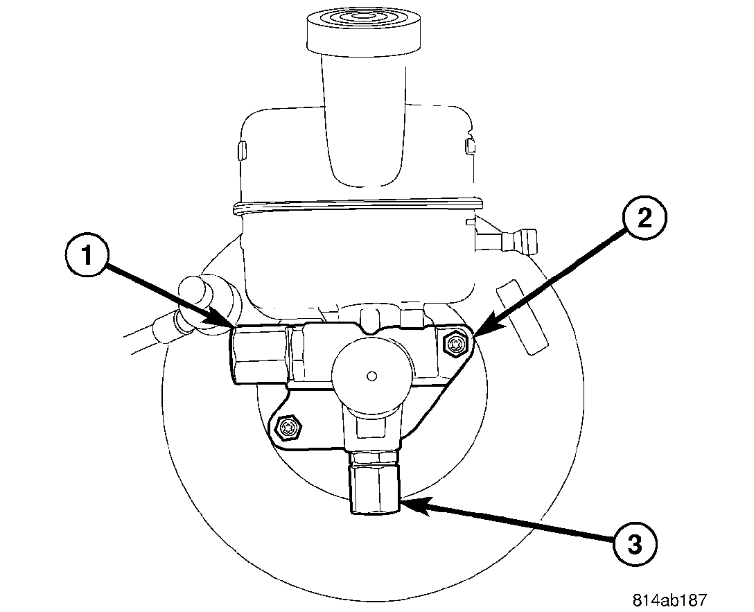

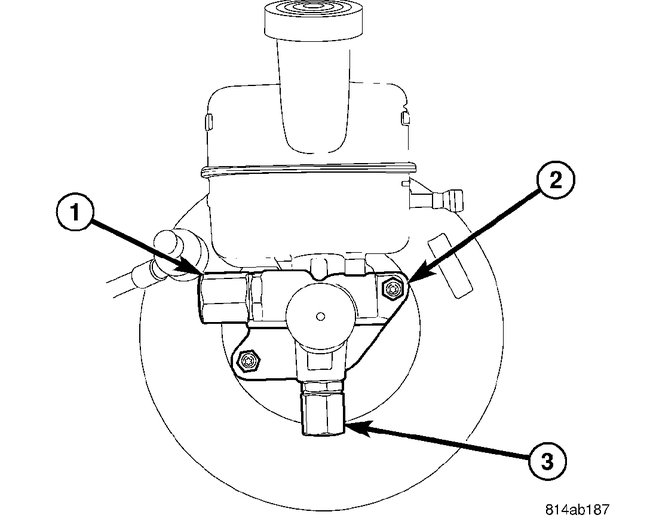

5. Unlatch the power distribution center, lift it up, and move it to the side.
pic 1

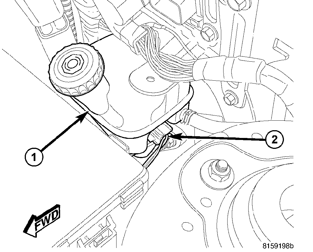

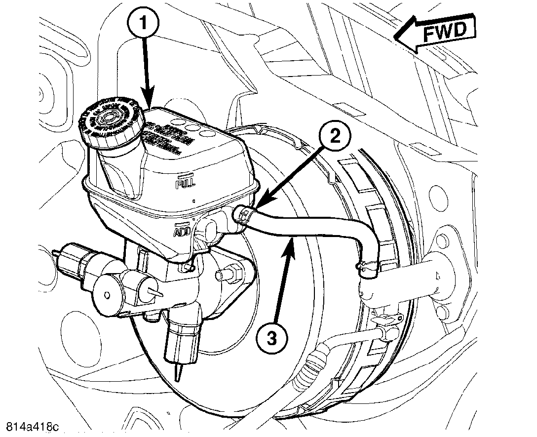

6. Remove the vehicle wiring harness connector (2) from brake fluid level switch in master cylinder brake fluid reservoir (1).
pic 2

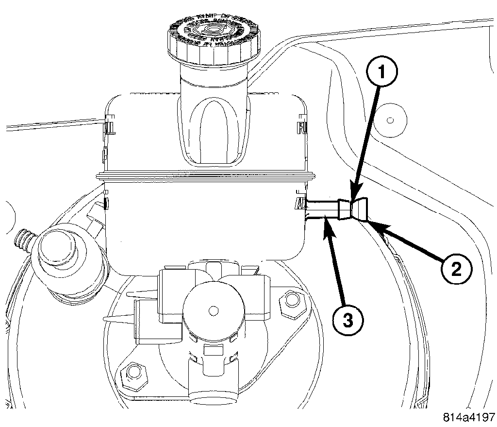

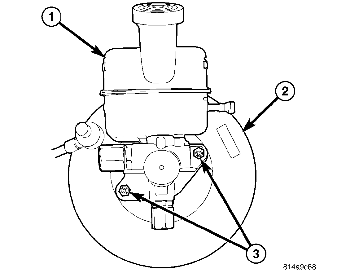

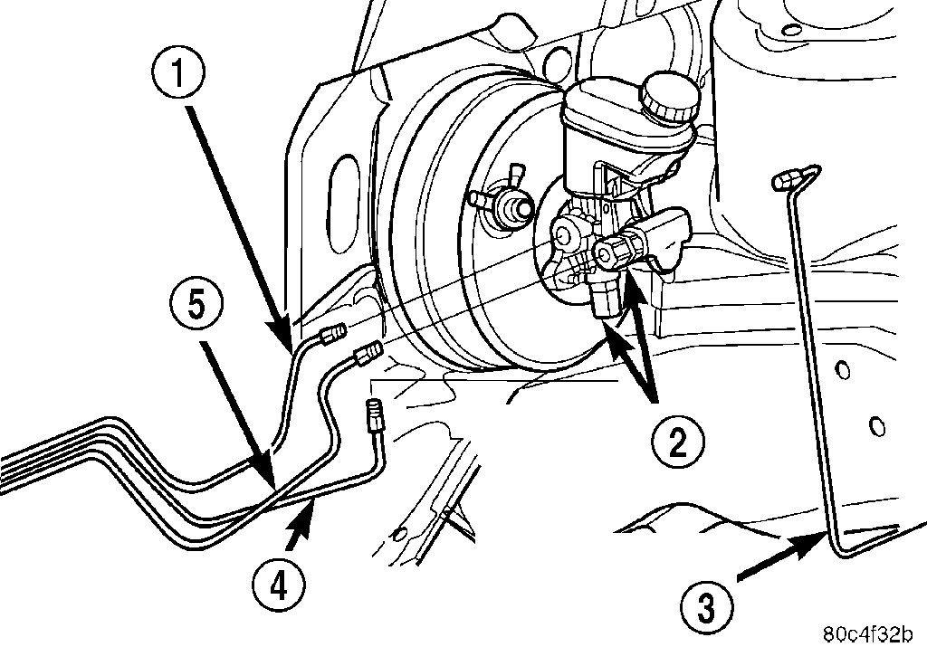

7. Disconnect the two front brake tubes (1, 3) from the master cylinder, and the two rear brake tubes (4, 5) from the proportioning valves (2). Install plugs at all of the open brake tube outlets on the master cylinder.
pic 3

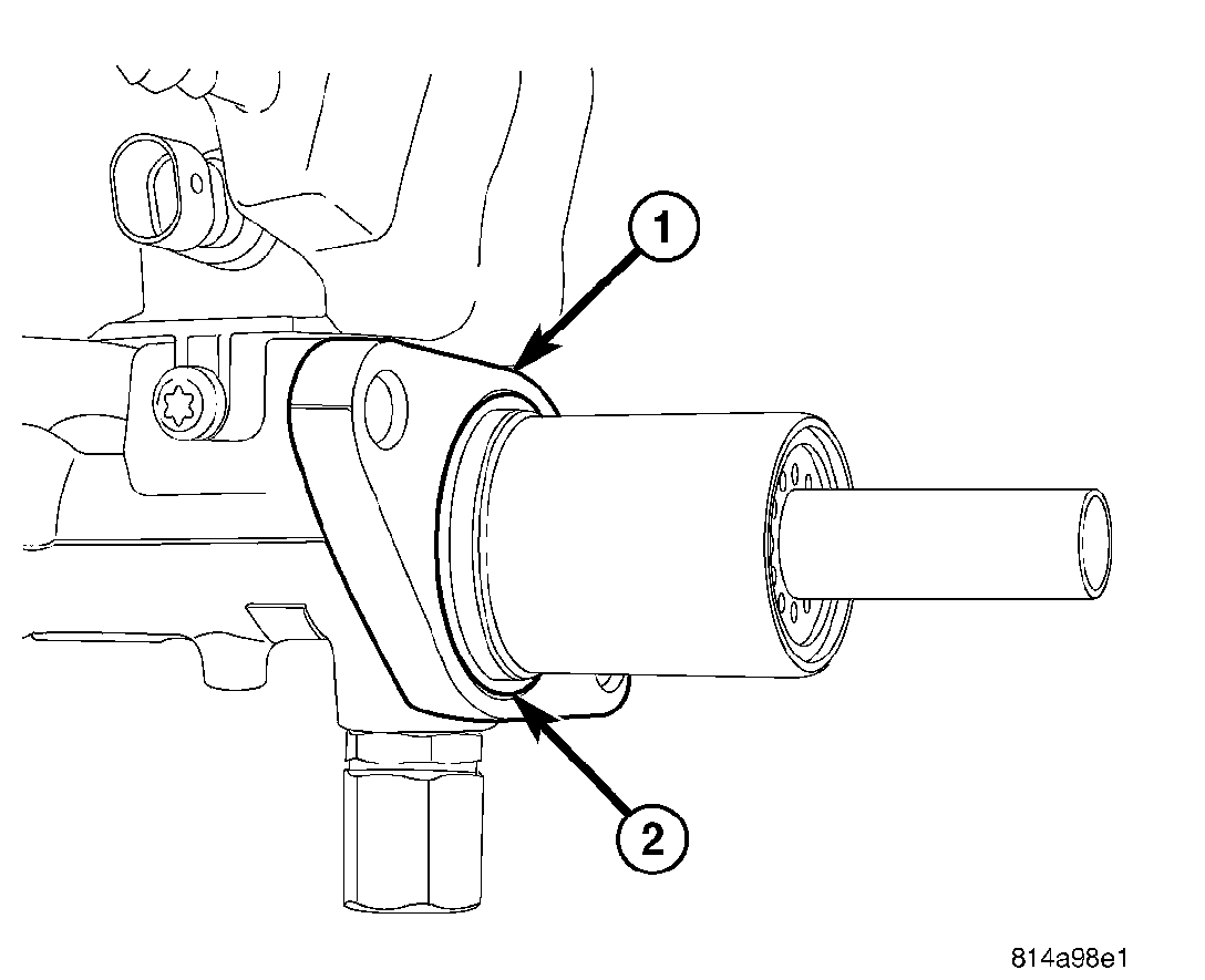

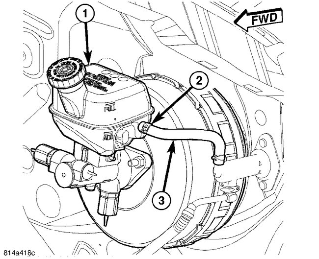

8. If equipped with a manual transaxle, remove the hose clamp (2) and slide the clutch actuator hose (3) off the reservoir port.
9. Clean the area around where the master cylinder attaches to the power brake booster using a suitable brake cleaner such as Mopar Brake Parts Cleaner or equivalent.
pic 4

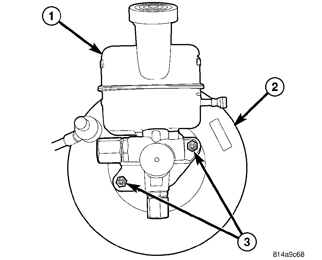

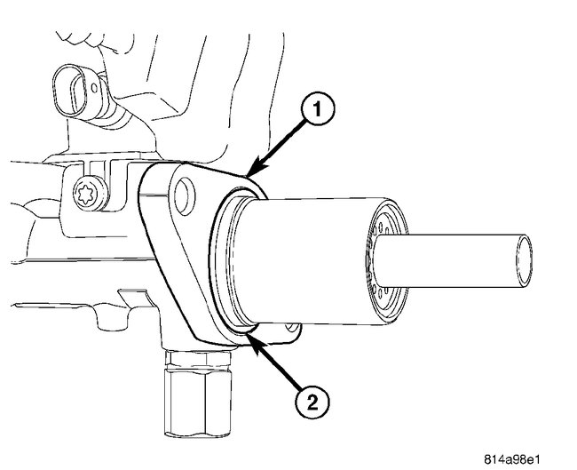

10. Remove the two nuts (3) attaching the master cylinder (1) to the power brake booster (2).
11. Slide the master cylinder straight out of the power brake booster.

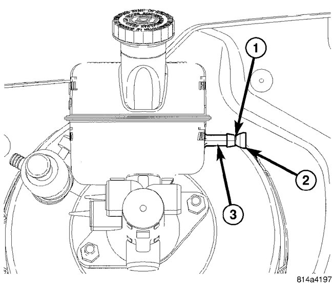

pic 5

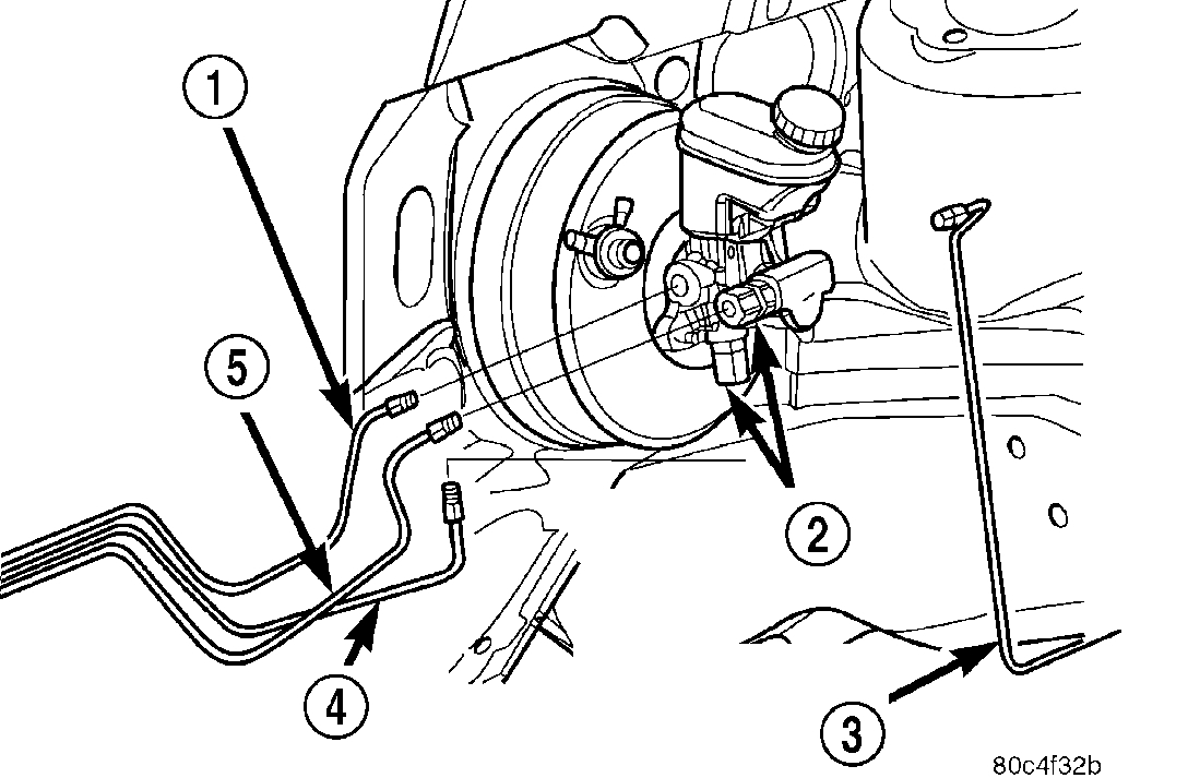

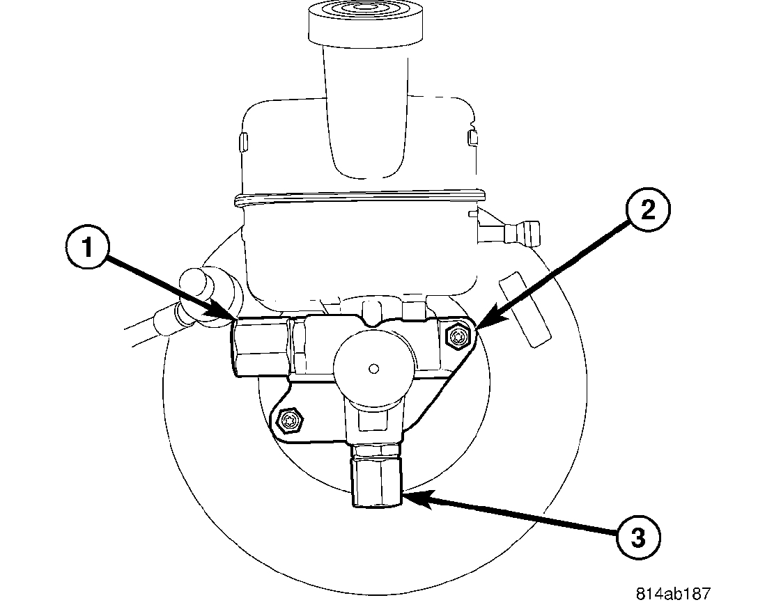

12. To remove the proportioning valves (1, 3), thread each from the master cylinder (2).
INSTALLATION

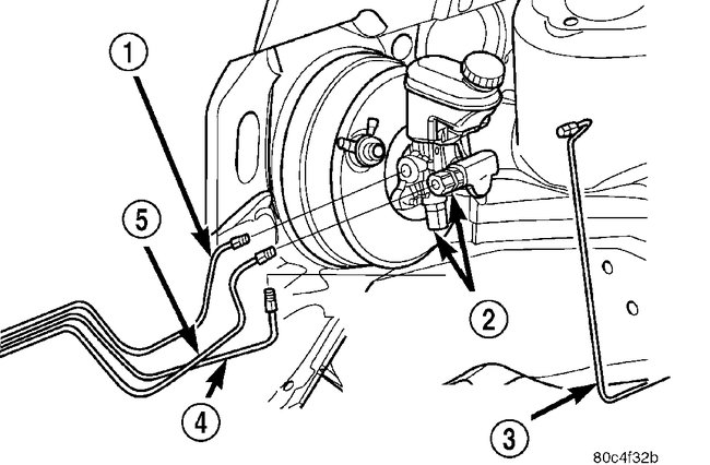

pic 6
1. If removed, install the proportioning valves (1, 3) in their master cylinder ports. The valves are identical, so they can be installed in either master cylinder port going to the rear brakes. Make sure the O-rings on the proportioning valves are new. Tighten the proportioning valves to 27 Nm (20 ft. lbs.).

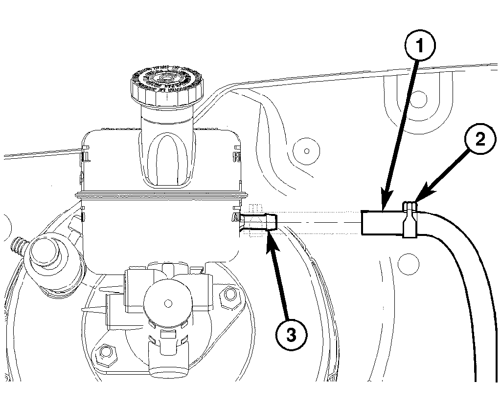

7. If equipped with a manual transaxle and a NEW reservoir is being installed, using an appropriate cutting tool, cut the clutch actuator port (3) at the center of the "V" groove (1) opening the port. Discard the severed plug (2).
pic 10
8. If equipped with a manual transaxle, slide the clutch actuator hose (1) onto the reservoir port. Install the hose clamp (2) just past the upset bead (3) on the port.
