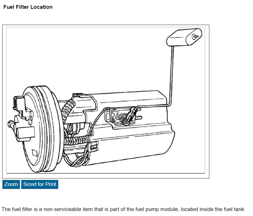

My car is acting like there is a problem with the fuel filter. Where is it and can I change it? If so How?
Oct 13, 2010 at 9:54 AM
JDL
  • 16,098 POSTS

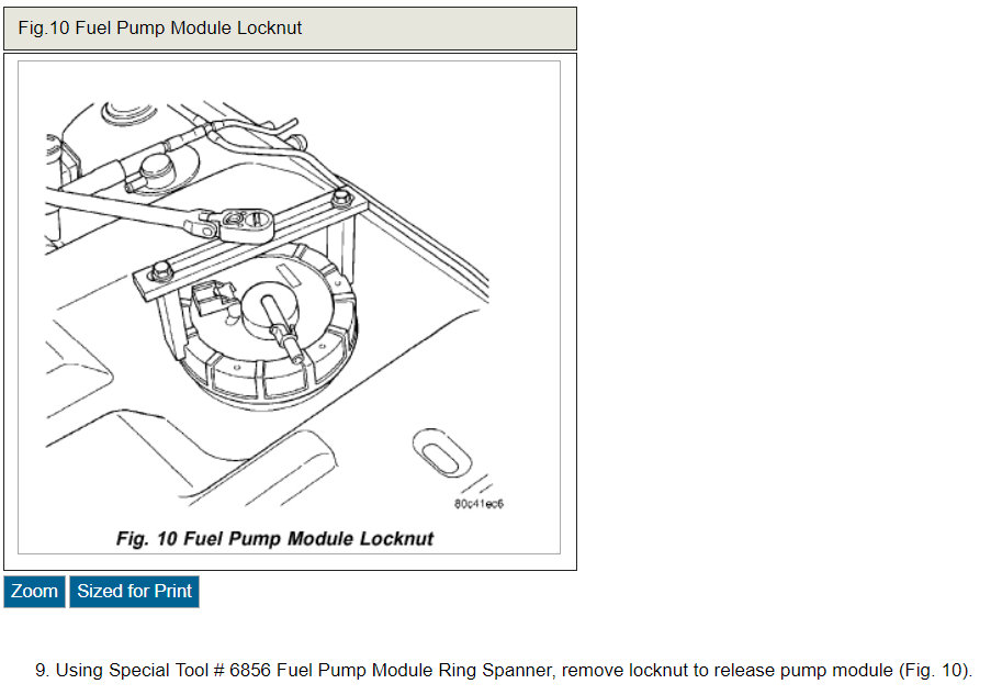

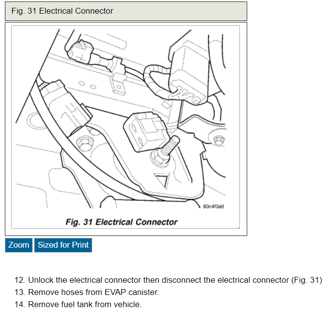

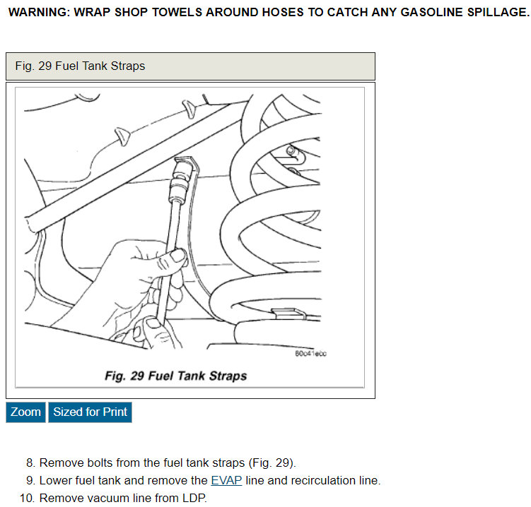

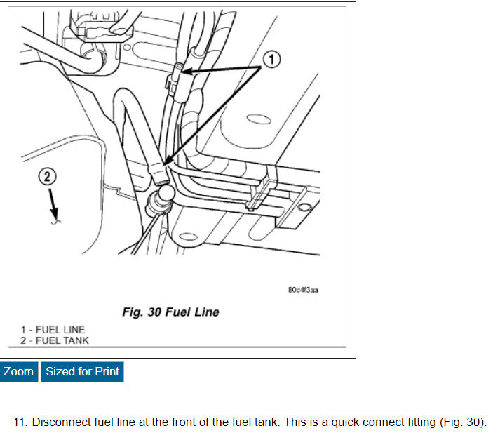

The fuel filter, is not serviceable, shows to be part of the fuel pump module. Here is a guide to help
https://www.2carpros.com/articles/how-to-change-a-fuel-filter
Oct 13, 2010 at 10:00 AM

The fuel filter is part of the fuel pump to replace it you must drop the tank and remove the fuel pump here is a guide to help you see what you are in for when doing the job.
Cheers

The fuel filter mounts inside the fuel pump module. Is non serviceable part. Have to replace the fuel pump module, according to my info.

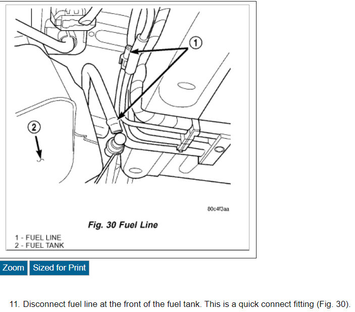

SERVICE WRITER
  • 9,123 POSTS
You don't change it as maintainence. It is part of the fuel pump module. Very pricy and very questionable when it comes to design.
https://www.2carpros.com/forum/automotive_pictures/30961_afupu_1.jpg
It is located in the fuel tank.
