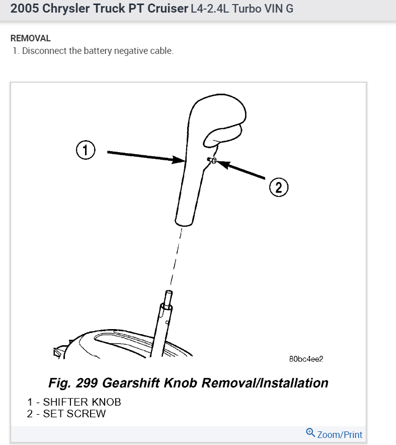

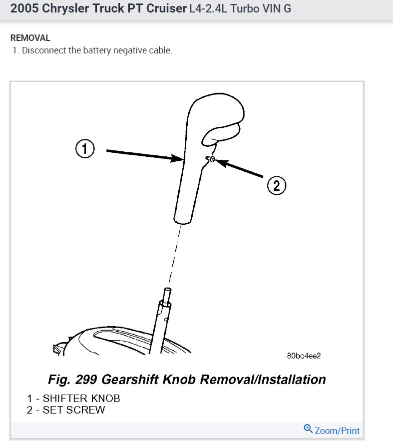

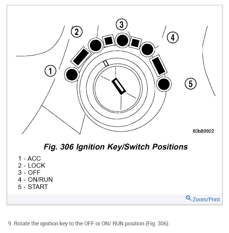

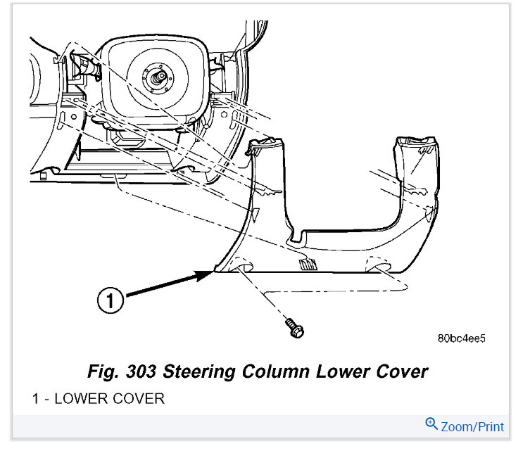

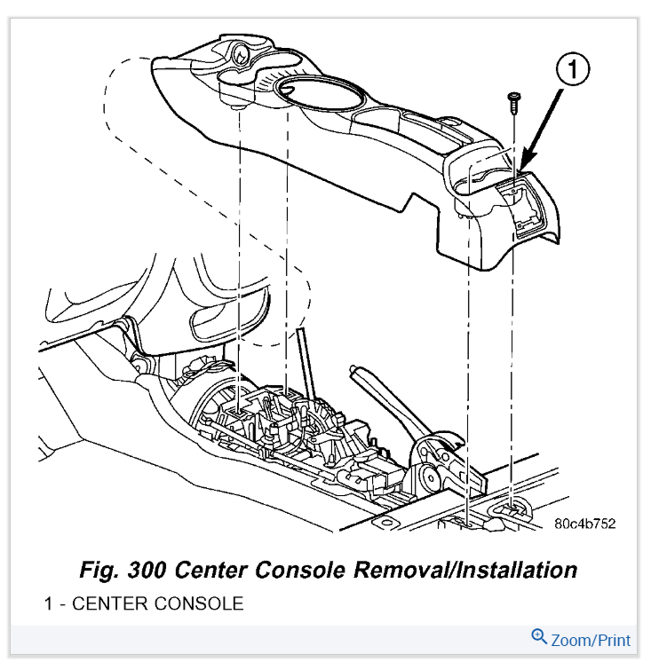

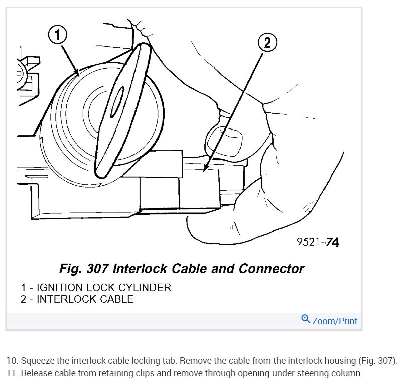

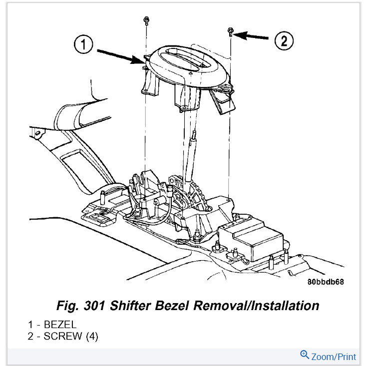

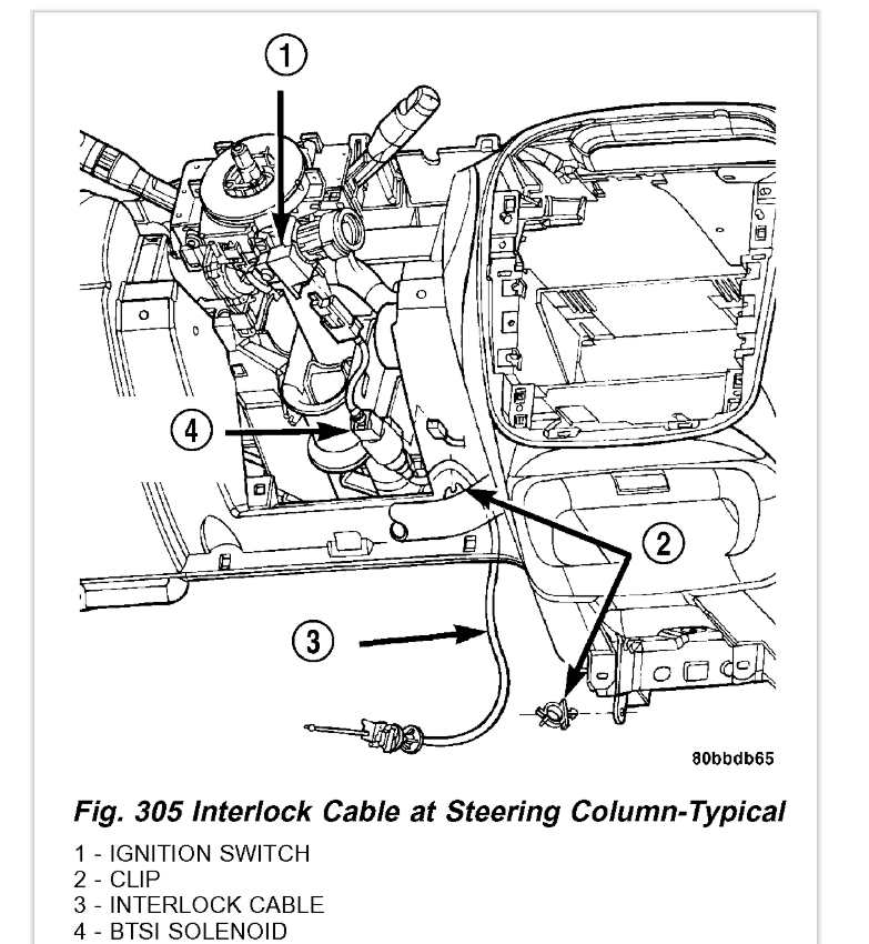

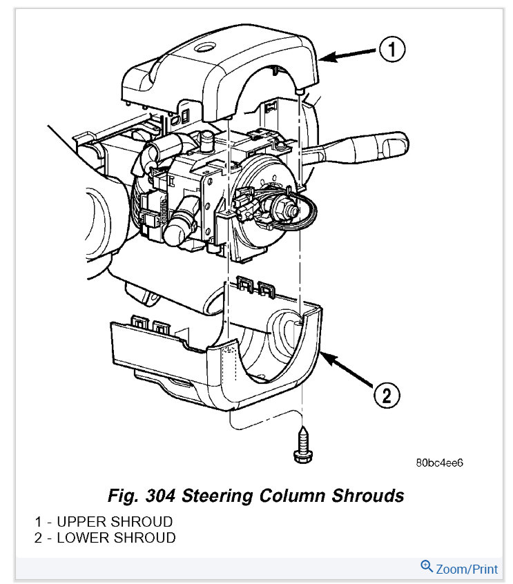

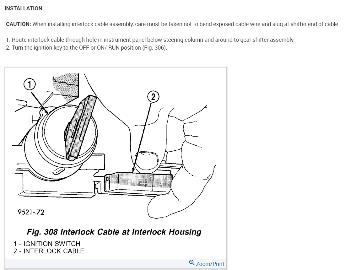

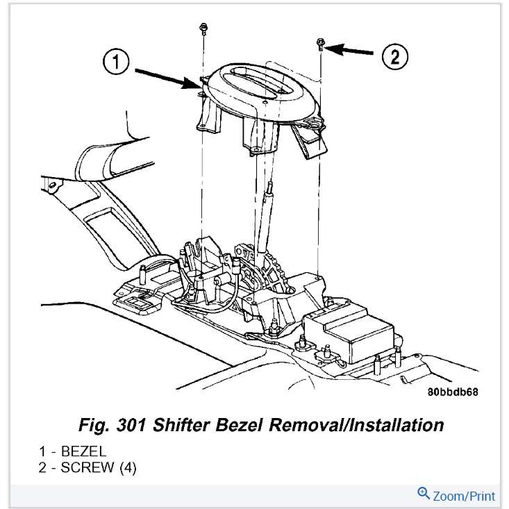

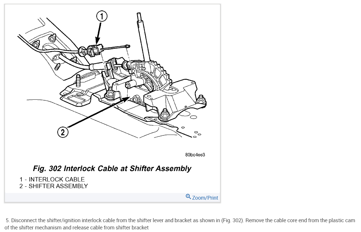

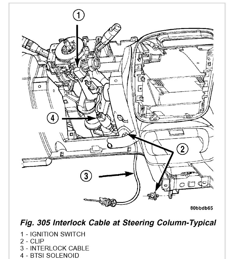

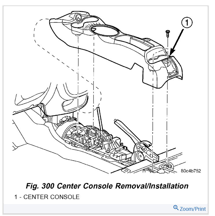

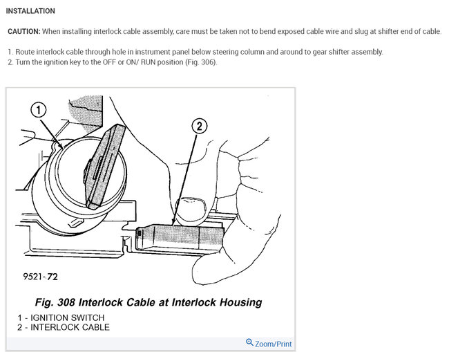

There is an interlock shift cable that sound like it broke or came out of adjustment. Here are diagrams below to help you see what to do to remove tor adjust the cable.

Thank you so much for this guide, it was spot on. I love this site.
